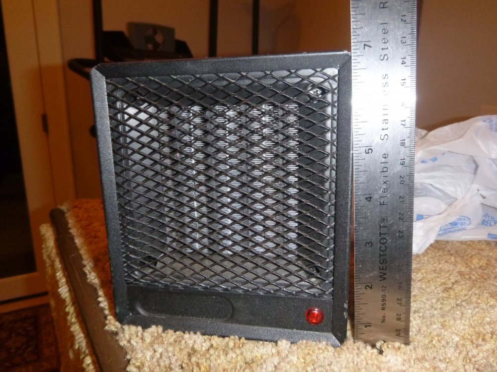

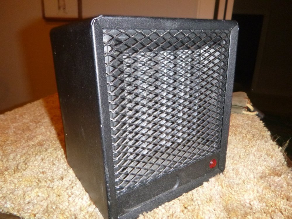

Ray and Susan Huff Posted February 11, 2021 Posted February 11, 2021 (edited) 33 minutes ago, Carl Hansen said: Greetings! Some of you have shared the benefits of using a small electric heater when camping in colder climates and connected to shore power. It really makes sense that an electric heater will minimize propane usage. Although we will not be full-timers, I do plan on using our Elite 1 year round, even during the winter since we are avid skiers. My question is when using the electric heater in colder conditions, is the ambient heat from an electric heater inside the trailer enough to keep the tanks and plumbing from freezing? I have heard of some using an electric heater during the winter so they don't have to winterize their trailer. That seems a bit risky. I am assuming since the trailer is truly a 4 season trailer, the electric heater would be enough but I wanted to hear from your experience. Are there any winter weather users out there that can provide any insight? Thanks! Carl We use an electric heater when shore power is available. On our trip home from picking up our 2021 Elite II (December 9-15), we traveled via I-40. In the higher elevations of NM and AZ, it was in the upper to mid 20's at night, but above freezing during the day. We did not winterize during the trip home, though we came prepared to, if necessary. We put remote temperature sensors in the basement and under the bed where the plumbing resides, monitoring temperatures closely. At night we ran the space heater to maintain upper 50s inside and opened the basement access hatch in the nightstand. I don't know how much having the access hatch open affected the basement temps that ranged from the upper 30's to low 40's during the night. We did hand pump antifreeze into the two water inlets (city and tank fill); the winterization and black flush ports had not been used, so we did not winterize them, as per Jason E's suggestion. We used onboard water the entire trip as most of the RV parks we stayed at recommended not connecting to water, since the supply hose would most likely freeze anyway. We kept the standard water heater running on electric during the night. While camping last weekend at a local park, our electric heater quit working so we used the furnace, but only during the day. Nighttime temps were around 37 deg. With no heat on at night, the basement stayed in the low 40's until we arose and turned on the furnace. During our trip home we monitored the internal temp of the Lithium batteries via bluetooth. Never did we have to turn on the battery heat mat. Edited February 11, 2021 by Ray and Susan Huff 1 Ray and Susan Huff Elite II Twin "Pearl" - Hull#699; delivered December 7, 2020 2013 F350 6.7l diesel Super Duty 4x4 long bed crew cab 1UP-USA Heavy-duty bike rack 2017 Leisure Travel Van Unity Twin Bed (sold)
Carl Hansen Posted February 11, 2021 Author Posted February 11, 2021 Ray and Susan, This is great information! Thanks so much for sharing. I'm sorry your heater died. I have been looking around for an appropriate electric heater. There are so many to choose from. As I read the reviews of the various models, there doesn't seem to be any one that everyone is happy about. Have you taken your trailer out since you got home or have you put it to bed for the winter? We plan on following I-40 home ourselves to visit Joshua Tree NP and then turn North to visit family and head for home. Carl 1 2021 Legacy Elite I | "Lil' Tow" | Hull #924 Tow Vehicle: 2020 Jeep Gladiator

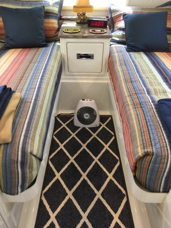

Moderators Mike and Carol Posted February 11, 2021 Moderators Posted February 11, 2021 We’ve used a small Vornado electric heater for the last 5 years in our Oliver. We put it right in front of the nightstand blowing toward the bathroom. With the inside of the trailer in the high 60s/low 70s we’ve never had a freezing issue in temps down to low 20s (19 degrees one night at Pinnacles NP). If it was colder than that I’m not sure just an electric heater would be enough, but we don’t like to camp in single digit or teens temperatures so I can’t really say. Mike 1 Texas Hill Country | 2016 Elite II #135 | 2020 Ram 2500 6.7L
Carl Hansen Posted February 11, 2021 Author Posted February 11, 2021 1 minute ago, Mike and Carol said: We’ve used a small Vornado electric heater for the last 5 years in our Oliver Which model do you use? I have been considering the Vornado line of products. 2021 Legacy Elite I | "Lil' Tow" | Hull #924 Tow Vehicle: 2020 Jeep Gladiator
SNY SD UP Posted February 11, 2021 Posted February 11, 2021 Just now, Carl Hansen said: Which model do you use? I have been considering the Vornado line of products. being a newbie, we will be bringing our Vornado Mdl: EH1-0012. there are newer models out there now. about 5 yo. but very nice. 1 Maggie & Bryan | Arnegard, ND | 2020 LE II "Twins" Hull #665 | 2021 RAM 2500 6.4L HEMI Gasser 4dr 6.5' bed
Moderators Mike and Carol Posted February 11, 2021 Moderators Posted February 11, 2021 Our particular model is no longer available, replaced with new models. I will say it is 5 years old and still going strong. It is a Vornado Whole House heater. Ours has 3 settings, 750W, 1150W, 1500W. It was available in white, which we got. Small, so it doesn’t take up much space. The way it is made makes it very hard to tip over and it does have a safety switch on the bottom in case it does. It has manual controls, some of the newer ones have digital controls. The closest I could find on Amazon is this one. 1 Texas Hill Country | 2016 Elite II #135 | 2020 Ram 2500 6.7L

Carl Hansen Posted February 11, 2021 Author Posted February 11, 2021 7 minutes ago, Mike and Carol said: It is a Vornado Whole House heater. Ours has 3 settings, 750W, 1150W, 1500W. Thanks for the pics! Your suggestion looks like a good one! Carl 2021 Legacy Elite I | "Lil' Tow" | Hull #924 Tow Vehicle: 2020 Jeep Gladiator

Fargoman Posted February 11, 2021 Posted February 11, 2021 Mike & Carol, Where does the Vornado heater plug in? I can't tell from the photo. Our Elite 2 Twin is scheduled to be hatched this fall, and we plan to use the small portable electric heater we currently have in our T@G teardrop. Your 'home on the road' looks very cozy! 2021 Legacy Elite 2 Twin Bed | Hull Number 894 (9/16/21 delivery) | Ram 1500 Longhorn 4x4 3.0L EcoDiesel 3.92 axle
Moderators Mike and Carol Posted February 11, 2021 Moderators Posted February 11, 2021 2 minutes ago, Fargoman said: Mike & Carol, Where does the Vornado heater plug in? I can't tell from the photo. Our Elite 2 Twin is scheduled to be hatched this fall, and we plan to use the small portable electric heater we currently have in our T@G teardrop. Your 'home on the road' looks very cozy! We had a 110V outlet installed under the bed near the kitchen. I used some On Command cable holders up under the bed extension for the cord. I don’t know where outlets are installed on new trailers or if they will install them in custom locations. It would be easy enough to add an outlet under one of the bed extensions. We just returned from a couple of weeks in east Texas and Arkansas, it was cold and we were cozy! Mike Texas Hill Country | 2016 Elite II #135 | 2020 Ram 2500 6.7L
