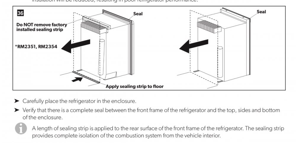

Generally speaking, rv 3 way fridges are set up in their own separate compartment,  with one vent low, and one vent high (either in the sidewall, or roof.) That's why the fridge is sealed off from the sink cabinet with the access panel.
I wouldn't recommend cutting a vent in the fridge compartment sidewall, creating a third vent. It could create issues with heat exhaust venting properly.
I don't know if this is an rvia requirement, (probably is),  but it's in the install manual for the dometic.

The idea, from my understanding,  is to isolate everything in the fridge compartment as much as possible.
I know I've had cold air come in from outside  around my 3way fridges, too.
The heat from the back of the fridge vents thru the upper vent.
Adding another vent will (possibly/ probably) cause refrigeration issues, as the proper airflow is necessary to remove the heat and create the cold.
The actual burner (outside) was isolated, in mine.
And, since the compartment is pretty much isolated, it wouldn't function as a return for your furnace,  anyway.

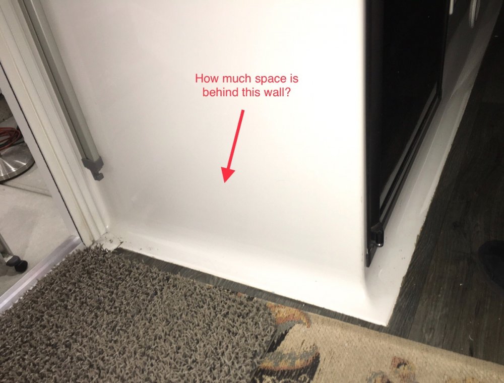

A bit late to this.... This mod has been on my mind for quite some time! But for different reasons though. The sound deadening potential of moving the cold air return (CAR) away from the furnace unit is one I hadn't thought of, but I think it is a great idea and probably would make a difference deadening the rocket.
I have the Elite. The furnace is under the front dinette seat next to the bathroom wall. The CAR is also right there cut into the seat riser. There has been lots of discussion of ways to heat between the hulls while boondocking and using the furnace. For us Elite owners (don't know about the Elite 2, but maybe similar?), the rear street and curb side between the hull corners are problematic in cold weather. What with the water pump and associated plumbing being on the curb side, and the check valves for water fill, and the exterior shower on the street side, they are relatively exposed. There is no space to run supply ducts to this area, so my thought was why not move the CAR back to the rear of the trailer. This way, when the fan kicks on, conditioned air from the cabin would be drawn down between the hulls at the rear of the trailer and make its way forward to the furnace fan. Even if the return air is not as warm as the supply air, it is somewhat warm and just having the air movement between the hulls would really help prevent any freezing down there. The main issue that has come up regarding this is that the blower could potentially receive less air due to passage restriction and/or have to work harder to get the air, causing overheating and furnace shut down. This is what Jason brought up when I posed him the question, but he wasn't sure. He said he would bring it up during the next design meeting. I don't really see this being an issue as there is lots of free space down below for air to move, just no space for duct work. One other potential drawback that I can think of is the fact that RV furnaces don't filter the return air like our home furnaces do. So whatever return air that makes its way to be blower will be recirculated in to the living space. There is a lot of dust from construction between the hulls. Oliver isn't as tidy as I wish they could be. Don't know if this could be a problem or not. Maybe the slow movement of the return air would not pick up any of the fiberglass dust and all that is down there.
What I plan to do is tape off the current CAR. Cut out the required space in a sheet of cardboard for a new CAR and tape it to the removed rear seat cover (dining table seat, curb side) and see what happens. I'm buying some remote temp sensors (thanks contributors on the forum for recommendations) to place in the furnace compartment and in the rear basement to see if there is any change in temperature. I'm not an HVAC person, but this seems like it's an idea worth pursuing for the cold weather campers out there. I'll post back in a few weeks when I get my test all completed.

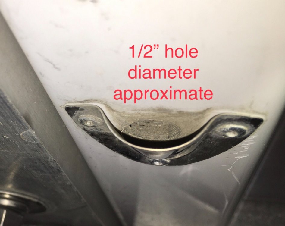

There are a dozen moisture vent/ drain holes in the bottom of the hull, the ones with those cute little stainless steel covers. The covers face rearwards so IMHO when the trailer is moving they will provide a slight suction effect, which is good for drainage. (I can’t imagine another possible reason for taking the time and expense to install them all with rivets. Most manufacturers would not bother.)
HOWEVER, in addition to letting out condensation or an actual water leak, they will also let air go back inside the outer hull when the trailer is stopped and there is a low pressure created inside, like turning on an exhaust fan with all the windows closed. Duh.
But if you relocate the furnace grill to the far side of the cabin,  you are essentially creating a slight vacuum under the floor with the furnace fan, so air is going to be pulled inside through those holes. A little air infiltration isn’t bad, but on a really frigid day it will also suck in trickles of freezing cold outside air right where you don’t want it, under the tanks and plumbing.
With the existing location there is no suction created under the floor, instead the cabin air enters directly.
So maybe they really did choose this spot for a good reason. A lot of “jet engine” fan noise may be preferable to drawing in cold air through the drains. A completely sealed return air duct from a single opening under the dinette would 100% fix that (like in a home HVAC system). It would have to be huge with no restrictions, so I see no way that could work in an Ollie. If you could put one way check valves at the drain holes, they would prevent air entry when the furnace was going, but it would also stop that beneficial movement when you are running an exhaust fan. Or you could crawl outside with duct tape every time it got really cold.... or install those interesting inflatable winter trailer skirts. .... https://www.airskirts.com/
We need to measure those holes and calculate how many square inches they represent, combined. My guess is about 10 square inches, which is pretty big for an active air leak in a small trailer. My other guess is that the average owner camping in moderately cold weather would find that this is a non issue, but one that plans to camp in sub zero temperatures at the ski resort (or Texas during a Polar Vortex) with water in the tanks and lines should avoid changing the furnace vent!
I am half asleep, the actual flow there may be negligible, so this is either complete nonsense or in fact pure brilliance. Please discuss after you have had your morning coffee. Thanks!

OK, maybe I should not type stuff before dawn. I went and looked.....My trailer Hull 217 has 10 scupper drains that I can locate. Each is about 1/2” diameter (it is really hard to tell, they are very recessed), so each one is about 0.2 square inches, or 2.0 sq in for all 10 of them. IMHO that is completely negligible in terms of air leakage, so I don’t think moving the furnace inlet across the hallway will freeze the belly parts at all.
OTH, the open holes do allow dust entry inside, so it would be possible to add some rubber “duckbill” dirt bike airbox drains, as found on a Jeep forum. I added the annotations from that thread description. BTW that is a typo, it should read 1/2” nipple.
7B3784F4-E6D0-4E07-8050-33D26F98F8C8.jpeg.e6c009a63288c513669797e64b650b75.jpegp
This would allow water to drip or pour out, and would prevent air and dust from being sucked back inside. I don’t know if those Honda parts are the last ones ever, or if they will be restocked soon. I asked the seller about that, and if he would combine shipping. It would not be a difficult mod, just time consuming, to drill out the rivets, seal the holes, and epoxy in place the nipples. And they would be a little vulnerable to rock strikes or getting knocked off while washing the trailer. (Rock strikes are not an issue for me due to Stone Stomper and other flaps).

If your weep vents are anything like mine, they’re 90% blocked with fiberglass dust gunk from construction, so probably not much to worry about.
