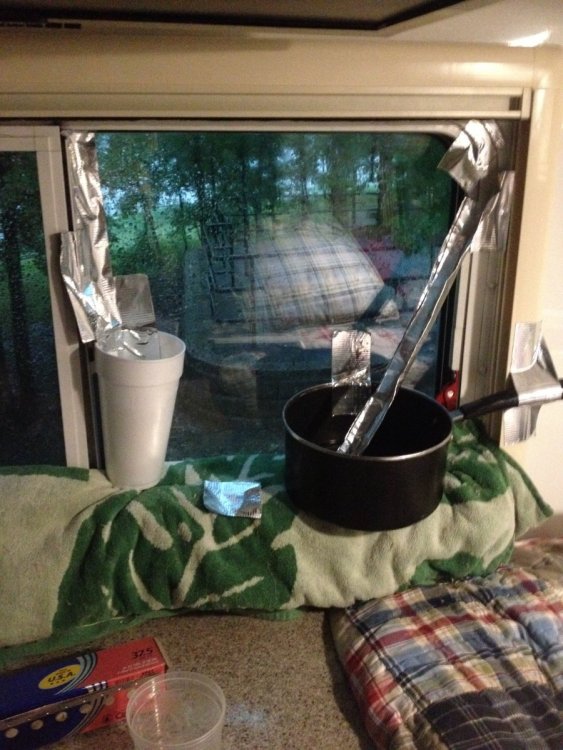

rideandfly Posted May 30, 2021 Posted May 30, 2021 Purchased our LE2 Ollie used, it is our dream retirement camper, too. Our Ollie's "Rear Oliver Sign" leaked and the top of the dinette window leaked, too. The dinette window leak was from from the exterior porch light above the window. The light was removed and wire holes in the hull sealed along with top and sides of the old style exterior fixture. Also drilled a drain hole in the bottom of the old style light fixture. No more leaks in that area! 👍 Old style porch light fixture: The following photo shows where rear Oliver LED light sign leak was dripping between hulls. Water traveled between the inner and outer hulls coming out of the bottom left side of the rear window on the curbside mattress. Removed the Oliver lens and cleaned out all of the old sealant. Resealed Oliver lens and no more leaks! 😁 All campers will eventually leak, good thing about the Oliver, when a leak is repaired there is not any wood damage to worry about! 3 Bill 2015 LE2 2024 F-350 6.8L
