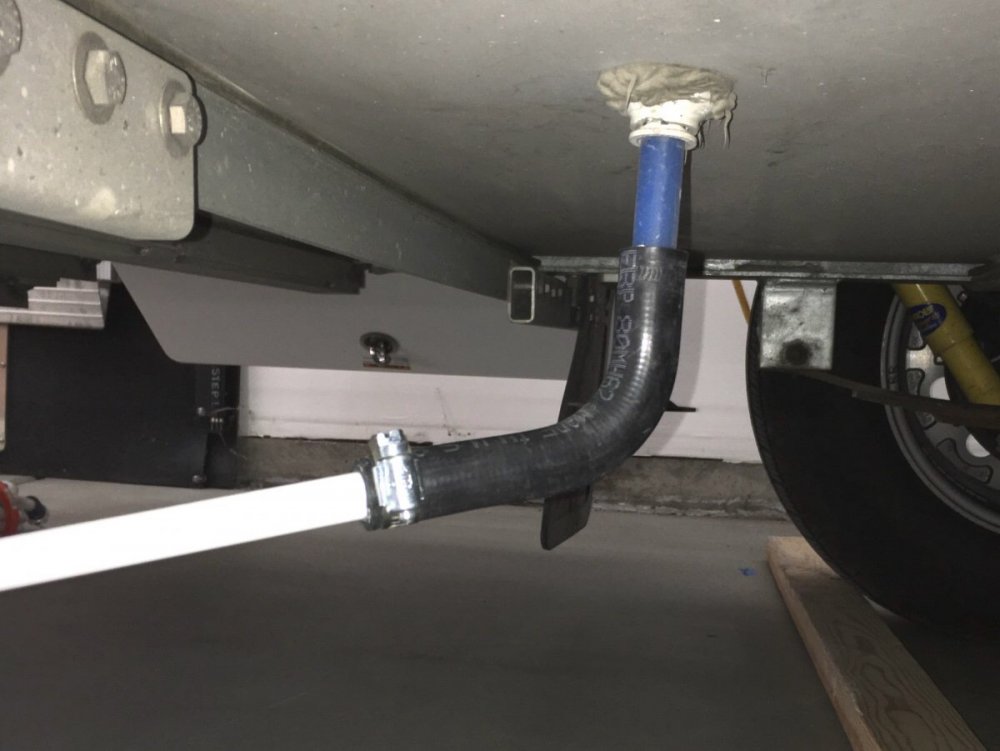

csevel Posted May 31, 2021 Posted May 31, 2021 Has anyone installed a Sharkbite or equivalent garden hose valve for the pex fresh water drain? I'm used to getting water for my dogs bowl from a fitting I added to my Casita. Is there any harm in installing one and leaving the inside valve open? 2020 Toyota Tundra TRD Sport 5.7L V8 2017 Oliver Legacy Elite II Hull #184 ~ "ILOVHER"
John E Davies Posted May 31, 2021 Posted May 31, 2021 On my trailer it is quite awkward to reach that PEX tube, you have to go around the rear jack and mudflap. I think anything large like a Shark Bite connector would be vulnerable to a rock strike, and you risk all your fresh water vanishing en route if it should come off (if the inside drain is left open). Is there some reason you don’t want to use the outside shower or the galley faucet for dog water? John Davies Spokane WA SOLD 07/23 "Mouse": 2017 Legacy Elite II Two Beds, Hull Number 218, See my HOW TO threads: Tow Vehicle: 2013 Land Cruiser 200, 32” LT tires, airbags, Safari snorkel, Maggiolina Grand Tour 360 Carbon RTT.
csevel Posted May 31, 2021 Author Posted May 31, 2021 Ha, that didn't occur to me to use the outside shower! I guess having a garden hose fitting there would be nice to run the water away from the trailer, but I see your concern. Could be quite low hanging. 2020 Toyota Tundra TRD Sport 5.7L V8 2017 Oliver Legacy Elite II Hull #184 ~ "ILOVHER"
John E Davies Posted May 31, 2021 Posted May 31, 2021 4 minutes ago, csevel said: I guess having a garden hose fitting there would be nice to run the water away from the trailer https://olivertraveltrailers.com/forums/topic/4267-how-to-fresh-tank-drain-line-extension/ John Davies Spokane WA SOLD 07/23 "Mouse": 2017 Legacy Elite II Two Beds, Hull Number 218, See my HOW TO threads: Tow Vehicle: 2013 Land Cruiser 200, 32” LT tires, airbags, Safari snorkel, Maggiolina Grand Tour 360 Carbon RTT.
csevel Posted May 31, 2021 Author Posted May 31, 2021 Thanks. I saw this earlier but I thought a simple hose bib would be cool! 2020 Toyota Tundra TRD Sport 5.7L V8 2017 Oliver Legacy Elite II Hull #184 ~ "ILOVHER"
Moderator+ ScubaRx Posted May 31, 2021 Moderator+ Posted May 31, 2021 3 hours ago, csevel said: Thanks. I saw this earlier but I thought a simple hose bib would be cool! I put one of these on our drain and just screw a hose onto it if I happen to drain my tank at home. The OOII lives in its own garage and I don't like just draining the water onto the floor. This way I can divert the water to a floor drain. I usually just open the drain cock whenever we're within 100 miles of home and let it drain out as we go down the road. Steve, Tali and our dog Rocky plus our beloved dogs Storm, Lucy, Maggie and Reacher (all waiting at the Rainbow Bridge) 2008 Legacy Elite I - Outlaw Oliver, Hull #026 | 2014 Legacy Elite II - Outlaw Oliver, Hull #050 | 2022 Silverado High Country 3500HD SRW Diesel 4x4

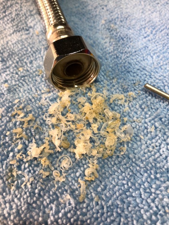

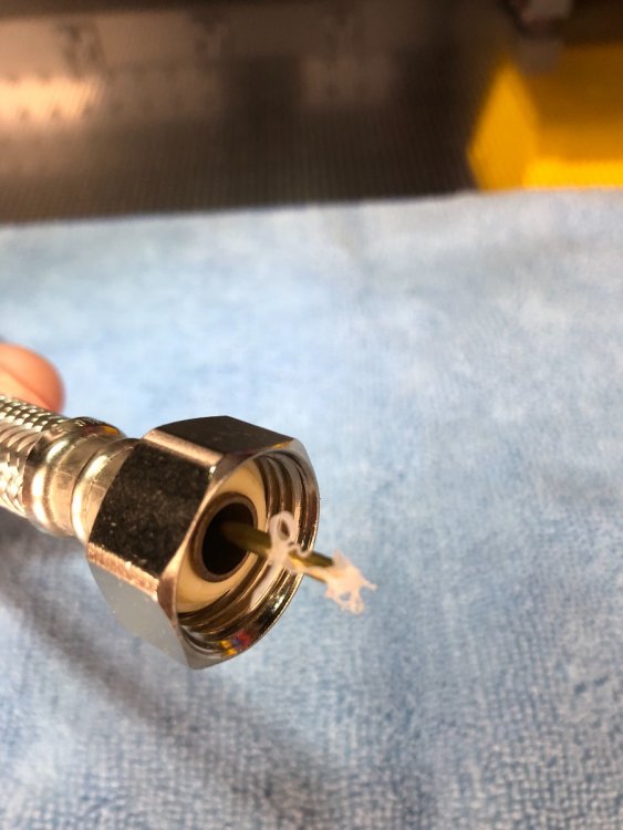

Landrover Posted May 31, 2021 Posted May 31, 2021 I think the cause of the slow drain from the fresh water tank is the same problem with slow water flow with the inlet line and the screen on the electric pump. Pieces of plastic that are left in the fresh water tank from drilling into the tank are getting stuck in the lines. Not enough to clog the lines just enough to slow the water flow. This plastic gets wedged in the lines I only had to clear the stainless steel inlet line to the water pump. Using coat hanger it was only about 8” long. If this is the case for the fresh water drain line I would say it may be easier to replace the drain line then trying to snake a wire through it. Compressed air may not work it will only clog the lines more. I’m sure others had the same problem. Just add it to the list. 1 Grant 2022 GMC Denali 2500 HD 2019 Elite 11😎

John E Davies Posted May 31, 2021 Posted May 31, 2021 DewDev, Mine drains at 1 gallon per minute, on average. In other words, a full fresh tank will empty in under 30 minutes.You can back flush with water into the tank if you are careful. I think using water is more effective than air because it has more mass and can carry the shreds past any elbows or constrictions. I describe how I do on that drain hose extension link I posted earlier. OTH it is way better to actually remove any debris than send it right back to the tank….. But mine continues to drain well. There really needs to be an INLET screen for the water tube inside the tank, that could be removed and cleaned properly. John Davies Spokane WA SOLD 07/23 "Mouse": 2017 Legacy Elite II Two Beds, Hull Number 218, See my HOW TO threads: Tow Vehicle: 2013 Land Cruiser 200, 32” LT tires, airbags, Safari snorkel, Maggiolina Grand Tour 360 Carbon RTT.
