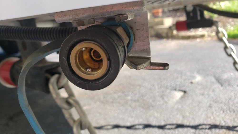

I don't see myself using the propane quick connect fitting on the curbside often as I usually set up a kitchen under a canopy but I thought I'd play around with it to see if it worked
I ordered a  fitting to connect to my Eureka stove and my ANCIENT Sunbeam grill (lava rocks even!) they take one pound canisters and everything connected properly.. I did pull the sleeve back, clicked in and turned the lever on the quick connect...and no go.  Both onboard propane tanks are full and open.  There's Just a tiny bit of gas flowing and a tiny flame on both the stove and grill.   I don't claim to know much about regulators or propane fittings but are these regulators just too many in line after the main? How does this work or will it work?  I went to the back by the bumper to see if that one worked and its been capped off.   It's not absolutely necessary but Id like to know how it operates!  Thanx for any input!

As a general rule, accessory devices like grills and fire pits will not work with more than one regulator in-line.  And it can sometimes be a challenge to eliminate the accessory regulator.
And the rear quick connect is capped off because the original owner did not chose that option.

I kinda figured that.. My Eureka has a proprietary fitting so I'm sure that isnt going to work.  As you can see the grill has its own ancient reg and it just literally sets inside the tube.. So I guess I wont be using it for anything.  What appliances do work??

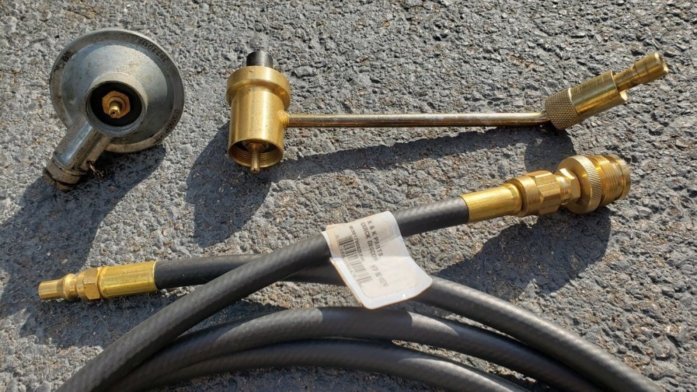

Here are gas adapters I bought to use high pressure off the tank with a stove that has its own regulator.
I went this route just because I have a number of older stoves, cookers, heaters, etc.
It works very well so far.
I contacted Oliver as I was trying to use my Genesis stove connected to the Oliver quick connect fitting. Oliver told me that the pressure at the quick connects is 11 inches of water column pressure and that since Oliver has a pressure regulator at the tanks you should not use a second regulator at the stove.
SteveCr's approach might be the best solution for using the Ollie propane.

Here are the parts I used to tee off the Ollie 30 lb tank and connect to an old dual gasoline Coleman stove. I used another adapter on the list to convert the Coleman stove to propane. I could leave the tee on the Ollie tank but so far I have removed it for travel.  This set up will work for other appliances that use the 1lb propane tanks.
Regards,
Steve
