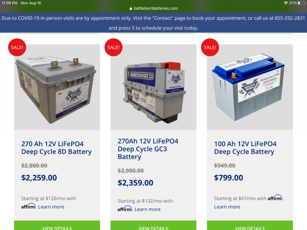

For anyone considering a battery upgrade, BattleBorn  batteries are on sale at the lowest price I’ve seen in a few years.  I’ve got 2 of the standard 100AH, considering a 3rd.
