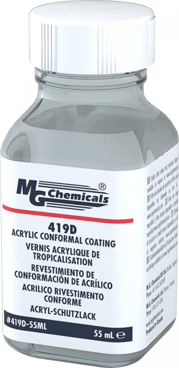

My local RV repairs guys told me our local high humidity causing condensation shorts the circuit board. The circuit board that came the fan and the replacement circuit boards I have purchased from Etrailer are not coated to protect them from moisture. It's just a matter of time before moisture will foul the board without a conformal coating to protect the circuits. Like i stated before, I went through three circuit boards.  The last board I replaced, I painted it with conformal coating. It's still early in the life of the new  board but I'm feeling like this will solve the issue or water shorting the circuits and the fan going haywire.
https://www.amazon.com/MG-Chemicals-Premium-Acrylic-Conformal/dp/B07B8RY7M6/ref=asc_df_B07B8RY7M6/?tag=hyprod-20&linkCode=df0&hvadid=312443844861&hvpos=&hvnetw=g&hvrand=348473701483492761&hvpone=&hvptwo=&hvqmt=&hvdev=c&hvdvcmdl=&hvlocint=&hvlocphy=1014226&hvtargid=pla-554140506900&psc=1
