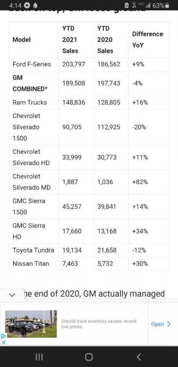

On 9/17/2021 at 4:36 PM, Keith-n-Jill said:
Thanks for the info. Wow, I had no idea that Titan market share was that small. Alfa Romeo sells more cars in the US than the Titan brand. I'm stunned.
This comment may be late for your post, but I thought I'd chip in -- my husband had a Nissan Titan XD when we first met; he had towed a larger TT from Florida to the far north end of Alaska and back with that truck. We took a few shorter camping trips with it (and other trips without towing) -- it was hands-down one of the most comfortable rides I've ever experienced. Better than any of the automobiles I've owned or friend's trucks or vans I've traveled in. It was easy to drive, and easy to ride. He gave it to his son-in-law a few years back. Anyway, he had great experience with it through the Rockies.

The Nissan XD 5.0 diesel was a truck in search of a market. Not enough torque to match the bigger engines for towing, and not especially fuel efficient. And much harder for service access than the inline engines. It died after four years and if you own one, good luck finding parts in the future, once the supply chain dries up. And good luck finding a Nissan dealer with a diesel certified technician…..
https://www.titanxdforum.com/threads/cummins-isv5-0l-v8-status.43238/

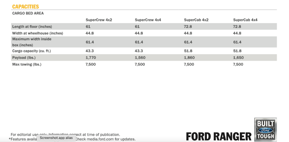

Thank you so much for yall's input!! I got email back from Oliver and it said "The GVWR is pretty much the rating of the axles. They are rated to 7,000lbs. Your are correct, the dry weight is 4,900lbs. The heaviest we have gotten a trailer to is 5,600lbs. That is with tanks full and 500lbs of camping gear. If a Ranger will tow 7,500lbs, you should be fine with one of our trailers. We recommend a vehicle with at least 7,000lbs capacity. You should be fine with a Ford Ranger. "
I am hearing you all about the gas tank size and payload capacity. I looked up a Tacoma and it is rated up to 6800 lbs towing and the payload is 1,050 to 1,685 lbs. The Ranger is up to 7500 lbs towing and its payload is 1609 to 1905 lbs. I would love to be able to get the F150 hybrid with generator but its so expensive. And if the Ranger will do it for now.....I can always upgrade to the 150 later, right??

Any idea of what the hitch ball weight limit is for the Ranger?
You're looking at a minimum of 500 pounds and up towards 600 pounds for the trailer you are thinking of.
Certainly I have a bias in this discussion as I do not believe that it is either wise, comfortable or safe (in all conditions) to be towing with a vehicle that is marginal at best.
You haven’t mentioned where you might want to be camping.  If you stay in Florida you should be okay with a Ranger.  If you head north into the mountains in north GA and the Carolinas you will be less fine.  Mountains and elevation in the west will be much more challenging.  Payload capacities for trucks on the lot are usually much less than what is advertised.  Once you add any options the payload decreases.  I don’t know what the gas tank size is for a Ranger, but figure about 12 mpg at best and see how far you can go.  Yes, you can always upgrade but probably at a higher cost than just starting out with a half ton.  Have you considered an F150 or other brand 1500 without all the bells and whistles?  Of course Oliver says you will be fine with a Ranger.  “Fine” means a properly equipped Ranger will pull and Oliver.  Again, a smaller truck means more work, less margin for error, less payload, less range.  The decision needs to be what’s best for you and your current situation.  If it’s a Ranger, go for it!  Don’t let a truck decision spoil your Oliver acquisition process…. Mike

Do you already own the Ranger?
It's a nice small truck, good safety features, great seats and visibility,  kind of a small version of an f150. I test drove one a year ago, and liked it.
It would be fine to tow my smaller Elite, in most situations. If you stay in the east, (I don't know where you are), you'll likely be "fine." Flatter roads, not too many 5 per cent or higher grades, ok. You'll likely struggle in even some roads in the east, like i26, green river gorge. A number of places on i40 in TN and NC that I can think of.
Southeast, coastal, (sc, much of NC,  ga, al, ms, fl,) you'll probably be golden.
If I  were looking for a TV, I'd look for something with at least half ton capacity.  Look for a bigger, used suv , maybe. Trucks are really hard to come by, these days .
Where do you live , and where do you want to go?
Everything everyone says about gas tank size, comfort, joy, is really true.
We've towed our elite with three different vehicles,  Volvo xc90, 2005 Silverado stepside, ram 1500 4 x 4. Big gas tank, bigger TV weight, stability comments are all true. The bigger, heavier ram, with the big 34 gallon tank can get us from sw Florida to Asheville in two gas stops, if we so desire. The Volvo was probably 4. And, green river gorge was slow lane slowww, with the heaviest trucks.
That said, Volvo was great around flatlands, local.
It's a big decision.  Take your time.
