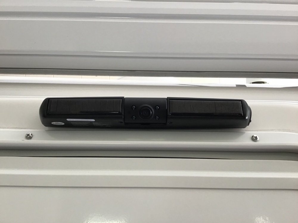

I installed this security camera several months ago and posted it on the forum. The camera is working very well there are no wires at all the camera recharges by built in solar or USB port.  Clear picture and great night time visual.   I posted it under entry door security camera.  This system is used as a back up camera I’m not sure if the monitor will pick it up from the TV we use the monitor in side the Ollie  I purchased the system at Walmart for around $100.00
You had an unanswered question in your originally thread… did you remove the metal bracket before mounting to the Oliver?
Yes. Only two small screws on the back . The Velcro covered and sealed the screw holes, i wanted to put the screws back in but they would not screw in flush with the back of the camera, I had heavy rain on one trip no problems no fogging camera lens.
