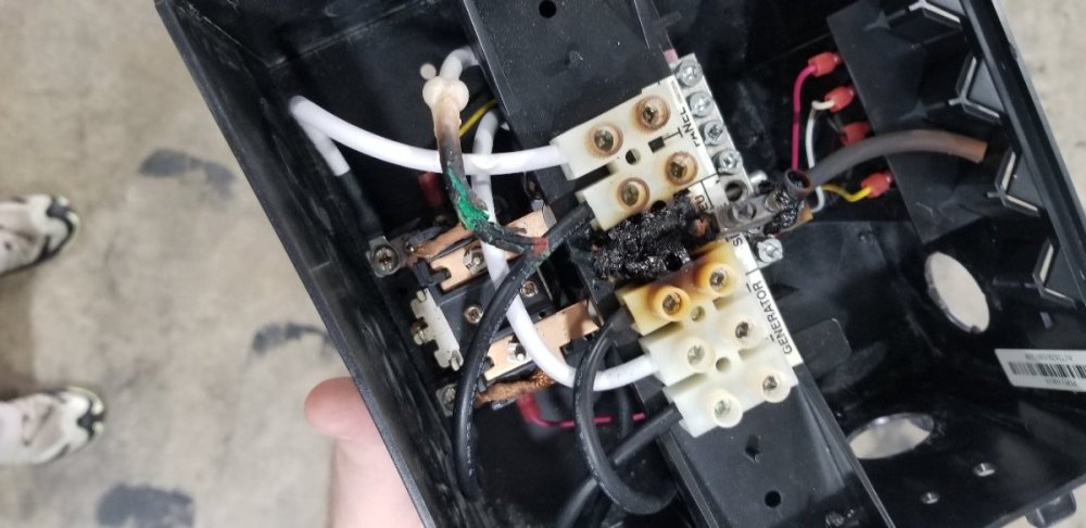

This doesn't have anything to do with the original post but it's good heads up info for anyone using the less expensive PI portable surge protector.
For about 6 months we were using the PI SSP-30XL Portable RV Smart Surge Protector instead of the onboard one because the onboard one frequently tripped our power.
Conveniently, about two weeks prior to our Ollie service appointment our 30 amp shore power plug quit working. (We have another one by the propane tanks that we used instead.) According to Oliver service, the shore power plug quit working because the relay switch burned up &, that low power most likely caused the relay switch to fail. Most importantly, the portable surge protector does not monitor low power.
Diagnostics on our onboard surge protector showed it was working fine but after digging a little further, the Oliver tech noticed that our shore power cord was dry rotted near the prongs. We replaced shore power cord & have had no problems.
Our Progressive EMS system has a 'lifetime' replacement warranty, and it DOES monitor low power. It will shut off power to the camper. When power is restored to enough voltage it monitors for a while and then allows power to our unit. This feature is especially important in older CG, during peak usage or brownouts. Inconvenience, but better than replacing "stuff" on my nickel...

Correct, though what I found when researching the buzzing problem on my EMS is that apparently all the Progressive units, both installed and portable, seem to have an issue with intermittent low voltage, which indeed can cause the burned out relay shown above. It’s one of the reasons I’m considering getting a different EMS rather than have mine repaired under warranty.
Here’s a thread discussing the problem.
The relay on the EMS itself can also burn out, from the same cause or from a dirty contact on the relay (probably my problem). Perhaps that’s another reason to opt for a portable unit (and keep it outside vs what I’m thinking).  I don’t know about you guys, but if I’m going to have an electrical fire, I’d rather have it start outside than in.  I’ll have to do some more reading, since the issue with the Progressives primarily seems to be with using the EMS while running on a generator, which I don’t use.  I’m curious how Oliver wires their built in EMS when you have two shore connections.  I bet it catches both, but it might be wise to wire it so that it only monitors the side port.  That way you could bypass the EMS when using a generator or if the EMS is acting up.
