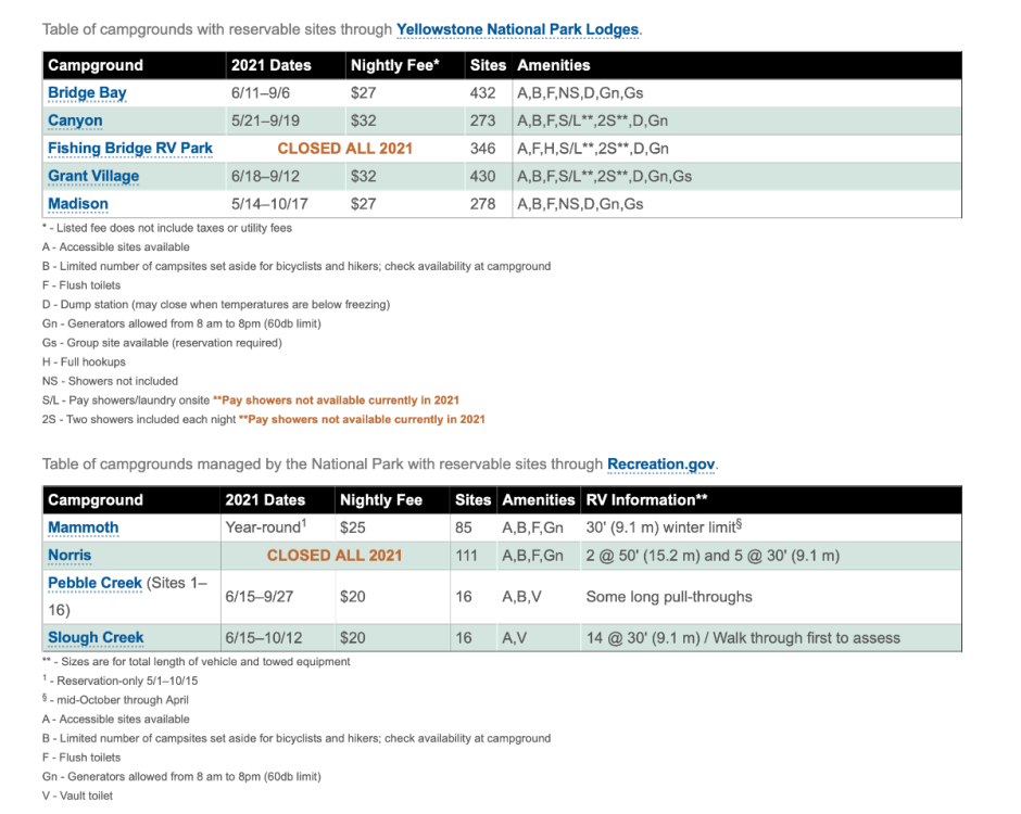

Be aware that some of Yellowstone National Park forbids the use of generators.
Having said this - also be aware of Yellowstone's altitude.  While it can be fairly warm during the daylight hours there, I've never had a night where the temps didn't go into the 40's or below.  The same can be said for much of the nearby surrounding area.
Seadawg has a fair amount of experience with a small generator and I believe that she and her husband have had no issues with using it to top off their batteries over the years.
Edited by topgun2
corrected information
I disagree, most allow it for limited hours. Seven campgrounds with "Gn" in the table allow them, but there is a 60dB limit, so no noisy box store units. If yours is quiet enough, you should be fine with the Yamaha 1000. Just make sure all your other 120 volt AC breakers are open, just leave the converter operating. I would check to make sure it works before leaving home.... 😉

Always check right before you get there, to make sure your info is current. https://www.nps.gov/yell/planyourvisit/campgrounds.htm
