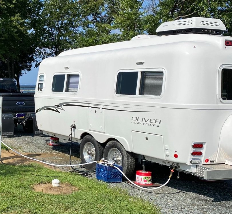

Welcome to the forum!  You’ll find forum members that use each of the options you mentioned.   We use the Andersen jack blocks (the big red bucket style) under the stabilizer jacks.  They’ve worked well but take up a lot of space in the truck bed when not being used.  And we use the Camco yellow Lego type blocks under the wheels for side to side leveling.

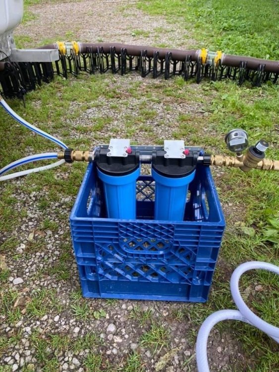

And I built a two stage water filter system into a milk crate.

For water filters, we decided to actually drink water from our fresh water tank.  As a result, we likely went overboard on our approach.  We use Purogene to sanitize the tank annually (vs. bleach) and add a tiny bit  (1/3 oz) when we fill up our fresh water tanks.  The actual filter we used is US Water Puredge Ultimate RV Filter - it fits in the basement during travel and sits in a milk crate when in use.  Since it's filters are a bit pricy, we also use the clasic blue filter seen everywhere to help extend the life of the US Water filter.

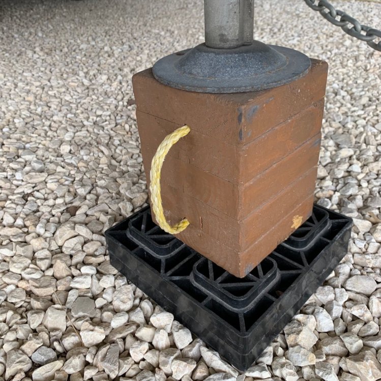

I use 6x6 wood blocks to lessen the distance the jacks have to travel and provide some protection against driving off with the jack all the way down.  While a bit heavier than the plastic blocks, the wood blocks are a touch smaller and they are very inexpensive - free if you keep your eyes open.

We just use the blue Camco water filters.  I have a Culligan that had replaceable cartridges but I’ve found that it is a pain to use, especially if you are just wanting to fill the fresh tank.  So, we went back to the blue filter but the jumbo size.  We don’t have an on board surge protector so we use one at the pedestal.  It’s worked well the last 6 years.  I don’t know how a pedestal protector would work with the on board system, maybe someone who has done it knows.  I made some blocks, similar to Bill’s above and use them on top of the big yellow/black legos to keep jack movement to just a couple of inches.
What is the approx length of the 6x6 blocks you all are are using?  I now remember reading about minimizing jack travel when possible.
SE Texas  | 2021 Elite II  Twin Bed # 927  "Lucy"  |  2019 F250 FX4 6.7
Link to comment
Share on other sites
Basically I measured the distance from the bottom of the jack to the ground while the Ollie was level.  Then I cut two blocks just a tad shorter in order to allow for ease of placing the blocks when there is gravel or "bumps" on the ground.  For me, this measurement was right at 11 inches.
The block I cut for the front jack is a touch shorter - about 10 inches - to allow for ease of placement given that the frame and Andersen chains can be in the way.
Remember - these blocks can also be used on their sides which will be about 5 1/2 inches (for a 6x6 block).
If you make a set of these, be sure to make some sort of "handle" so that they are easier to remove and carry.  I used some old plastic rope I had around the shop - plastic "truckers" rope would be good - and some electric wire staples.
I think mine are just a little over 6” tall.  That gives some flexibility on really unlevel sites.  I’ve stacked a number of legos underneath to bring it to the right height.  I also have a fourth block that is only 4” tall.  Sometimes the front of the trailer needs to come down quite a bit, that’s when it gets used.  Mike

Got a handle on that block - yet?  I really like free!
Also, if you throw a coat of poly on them they will not get as dirty and will not absorb water either.
Link to comment
3 hours ago, Frank-n-Val said:
Just put a coat of tung oil on it.
And a nice handle too.
Makes my 6x6 pine look a bit pedestrian!  Way to go!
