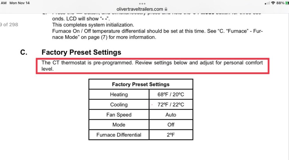

Bill and Nancy Posted November 14, 2022 Author Posted November 14, 2022 We have done all of the above already. As of this morning this is where we are at: We did the following to check on the heater: Checked vent connections and visual inspection around the furnace. The Dometic thermostat has been re initialized and the degree off set is set to 2 degrees -Tested this morning with 2 additional digital thermometers mounted on the wall next to the thermostat. The Dometic thermostat was set to 55 degrees with the fan setting on Auto. The outside are temp was 35 degrees. Furnace came on and raised the temperature to 56 degrees according to the Dometic thermostat and furnace shut off. The other 2 thermometers read 53/52 degree 1 minute after furnace shut off there was a double clicking sound that came from the air conditioning unit mounted on the ceiling 1 minute later a 2nd double clicking sound came from the ac unit 10 seconds later a 3rd double click sound came from the ac unit 10 seconds later a 4th double click sound came from the ac unit 30 seconds later a 5th single click sound came from the ac unit and the furnace turned back on again The temperature read 55 degrees on the Dometic when the furnace restarted and ran for a few minutes and then shut off when the temperature on the domestic read 56 degrees. This has been forwarded to service. Sorry for not providing hull info, etc at the bottom, new at this... 2022 hull# 1265 with dometic ct thermostat/furnace 2 Bill & Nancy Holland MA 2022 Elite II Hull #1265 2022 GMC Diesel Canyon
John E Davies Posted November 14, 2022 Posted November 14, 2022 Try increasing the differential number. I don’t have that AC model, but I think the clicks are normal. The furnace gets its actual commands from the board inside the AC. BTW you don’t really need to add any standard equipment details to your Hull description, though you can add options if you like, but please do add your Tow Vehicle. John Davies Spokane WA SOLD 07/23 "Mouse": 2017 Legacy Elite II Two Beds, Hull Number 218, See my HOW TO threads: Tow Vehicle: 2013 Land Cruiser 200, 32” LT tires, airbags, Safari snorkel, Maggiolina Grand Tour 360 Carbon RTT.
Bill and Nancy Posted November 14, 2022 Author Posted November 14, 2022 Differential is set at 2 which is the most it can go. From what we've heard most people don't hear their furnace turning on and off and clicking every minute. It's like a dripping faucet, the noise will drive you insane. Thanks for the info on the ac driving the furnace Bill & Nancy Holland MA 2022 Elite II Hull #1265 2022 GMC Diesel Canyon

Bill and Nancy Posted November 17, 2022 Author Posted November 17, 2022 This is the latest information that was sent to Oliver Service, When the heat turns on and off the temperature on the thermostat LCD displays remained the same. According to the manual there should be a 2 degree set back before the heat turns back on. This does not seem to be the case the heat cycles on and off at the same temperature according to the LCD display on the thermostat. After the heat shuts off, the temperature has not dropped the 2 degrees yet the furnace starts back up. Also when the heat is off, approximately 1 -2 minutes before the heat kicks back on the air conditioner starts to click. It will click 3 to 5 times within this period before the furnace starts. Here are some stats: Outside temp 26 degrees set thermostat to 60 degrees. Heat came on and shut off when the temperature on the LCD display read 59 degrees. I have 2 other thermometers in the trailer one read 52 degrees and the other 53 degrees an 7 to 6 degree difference. The heat shut off and the LCD display still read 59 degrees. The heat remained off for 4 minutes and 40 seconds then restarted. This continued until I decided to call it a night. Off: 4:40 min/sec On: 9:36 " Off: 2:59 " On: 8:53 " Off: 5:41 " On: 7:42 " Off: 5:34 " On: 9:33 " Off: 3:49 " On: 7:55 " Off: 3:17 " On: 9:00 " Off: 2:23 " 1 Bill & Nancy Holland MA 2022 Elite II Hull #1265 2022 GMC Diesel Canyon
