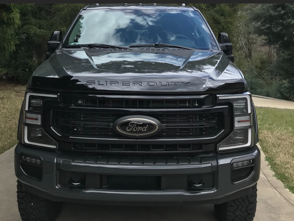

I agree - highly recommend…I will have to send you a picture of recent front end work on my F-250.  Have you heard about the collaboration between Warn and Ford to create the “kit” to install the 12k pound winch?
It looks incredible!
@PatriotAdding Link:  https://www.levittownfordparts.com/sku/m-1821-sd.html
BL
