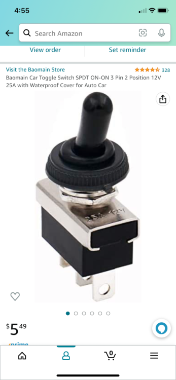

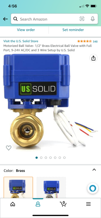

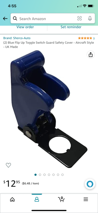

Used the US Solid 3 wire electric valve and SPDT on/on toggle switch with flip cover to prevent accident activation of valve. All parts purchased through Amazon.

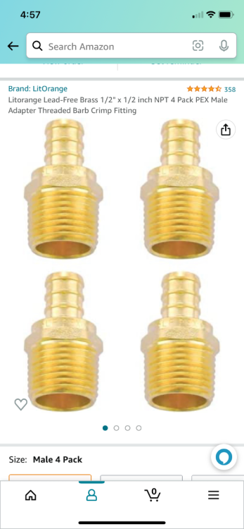

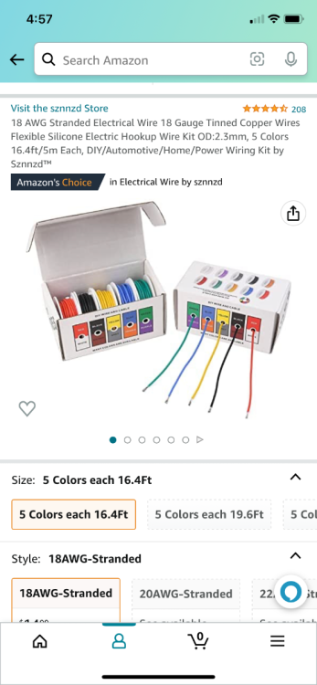

Here are screen shots of the items I purchased off Amazon. You’ll also need spade connectors to attach wires to switch. I already had those, but they too are available on Amazon. Also some hose clamps or pex crimp rings with crimping tool are needed.

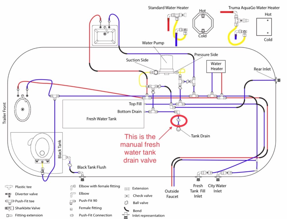

I am sure C&M Currie will respond with more information about this mod, but until then I have included a plumbing and electrical diagram from the 2017 LE2 manual to help you focus on the what it might entail.
Plumbing Diagram
Wiring Diagram

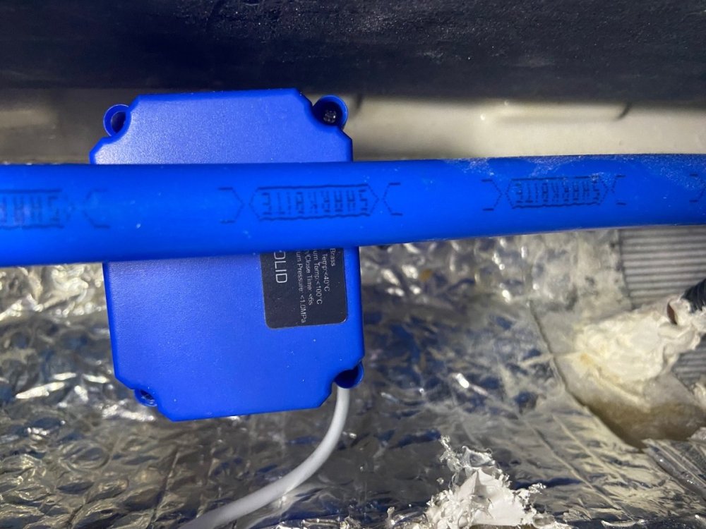

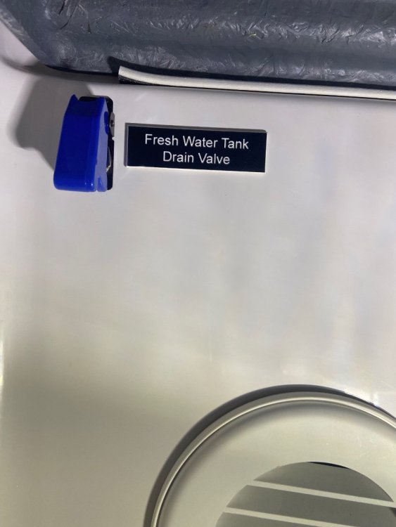

It’s basically just cutting out manual valve and replacing it with the electric one. Might want to have a piece of blue pex pipe handy. I extended how much pipe exited camper so I could crimp on a 3/4” threaded brass fitting. The two biggest decisions are where to mount switch and where to get 12v power from. I originally wanted to mount switch with the rest of the switches on the left wall as you enter camper, but running wires between hulls proved impossible for me. So I decided on current location shown in picture. For 12v power, I just tapped into a previous mod of a 12v exterior socket which was very close to valve location. But, it would not have been very difficult to run the wires to the other side of camper where the fuse panel is located. There is a Youtube video on wiring up the US Solid valve. Remember, there are two versions of the US Solid valve, a three wire and a two wire. The 3 wire is what I chose. In either open or closed condition, it draws no power. The two wire version uses minimal power when open and will automatically close when power is lost using internal capacitor.
