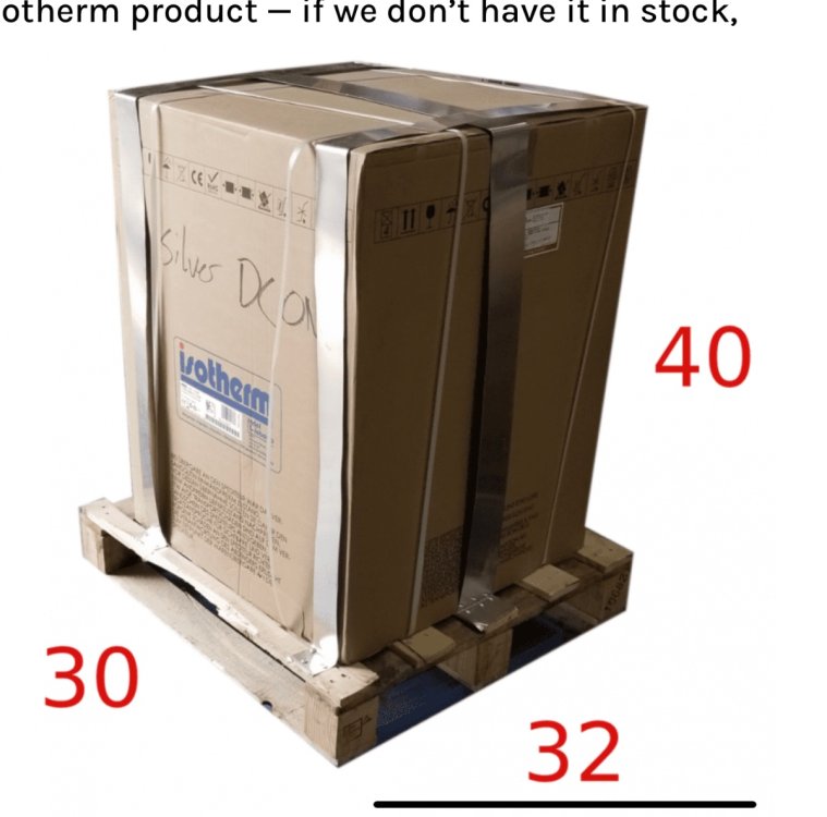

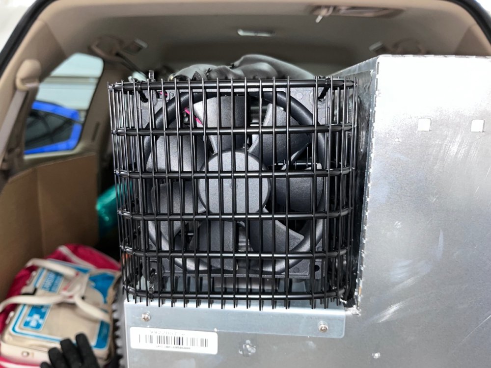

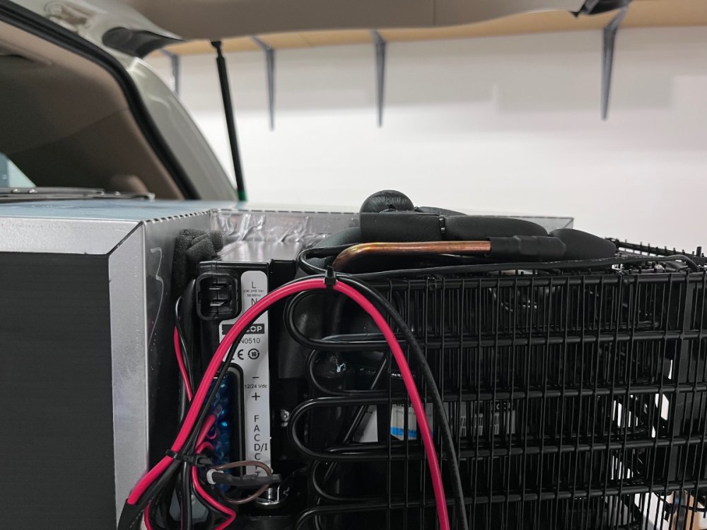

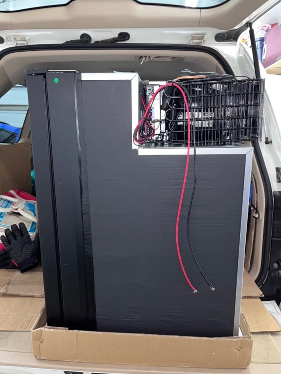

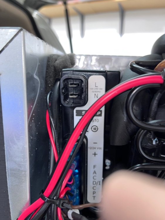

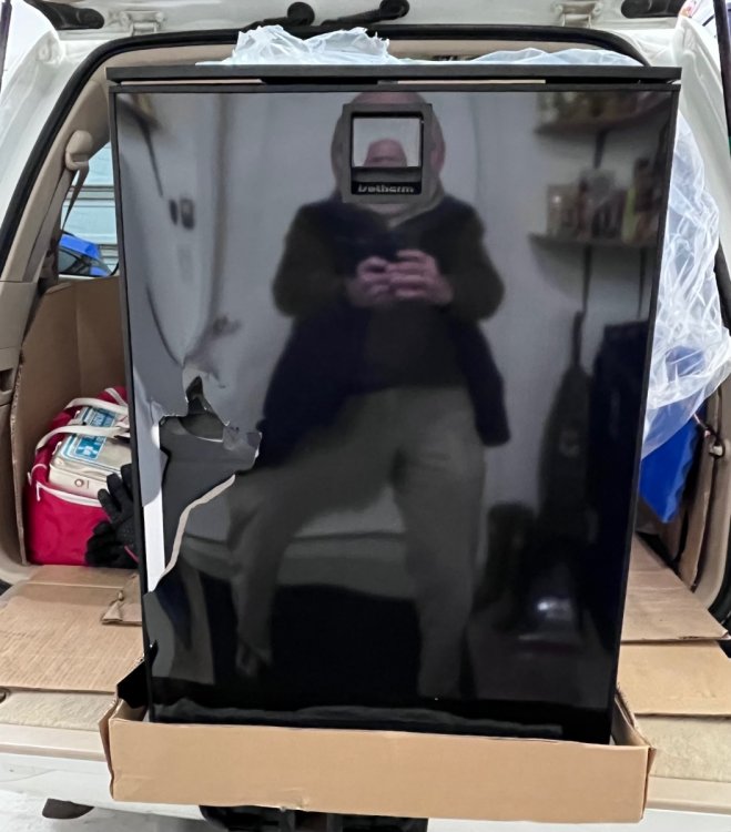

John E Davies Posted February 10, 2023 Author Share Posted February 10, 2023 Update, West Marine only had a unit in Florida, so they shipped it promptly, loaded it onto the wrong truck, the shipping label fell off and it ended up in New Jersey. They could not figure out where it was supposed to go, so they sent it back to Pensacola, so it could go in the right compass heading... I picked it up today, the store manager here in Spokane said it had a little box damage, but he had opened it up, unbagged it, and inspected it all over, and all was great. I got it home, spun it around in my truck and discovered that some airhead drone had rammed a forklift arm through the front door. The damage is a little hard to miss, do you agree? I am standing straight up, the door is buckled. I'm not sure how anyone could miss that, SHAME on me for believing the guy. It goes back to the store tomorrow for credit and I have already ordered another one. Which is $50 more expensive, so they will have to credit me that too. Grrr. At least I was able to make some measurements, to make sure the dimensional drawings are correct, and to see where the power connections are, and how the feet are spaced. I can start on the construction now...,. Here are a bunch of pics for your entertainment. I have opened a ticket to see if I can get some guidance from Jason about retrofitting this into my old timer Hull 218. John Davies Spokane WA 4 SOLD 07/23 "Mouse": 2017 Legacy Elite II Two Beds, Hull Number 218, See my HOW TO threads: Tow Vehicle: 2013 Land Cruiser 200, 32” LT tires, airbags, Safari snorkel, Maggiolina Grand Tour 360 Carbon RTT. Link to comment Share on other sites More sharing options...
John E Davies Posted February 10, 2023 Author Share Posted February 10, 2023 :ics 1 1 SOLD 07/23 "Mouse": 2017 Legacy Elite II Two Beds, Hull Number 218, See my HOW TO threads: Tow Vehicle: 2013 Land Cruiser 200, 32” LT tires, airbags, Safari snorkel, Maggiolina Grand Tour 360 Carbon RTT. Link to comment Share on other sites More sharing options...
John E Davies Posted February 10, 2023 Author Share Posted February 10, 2023 Pics 1 1 SOLD 07/23 "Mouse": 2017 Legacy Elite II Two Beds, Hull Number 218, See my HOW TO threads: Tow Vehicle: 2013 Land Cruiser 200, 32” LT tires, airbags, Safari snorkel, Maggiolina Grand Tour 360 Carbon RTT. Link to comment Share on other sites More sharing options...
