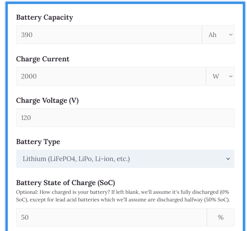

HDRider Posted May 7, 2023 Author Share Posted May 7, 2023 9 hours ago, Frank C said: The charge voltage value you entered is incorrect. The batteries do not charge at 120 volts. 120 volts is the nominal AC (alternating current) shore power input voltage to the trailer. The battery charger converts that AC voltage to DC voltage (direct current) for charging the batteries. Lithium ion batteries charge at around 14.25 to 14.7 volts DC. Enter that value. Charging current (amps) is equal to the charging wattage divided by the charging voltage. THEORETICALLY 2000 watts available divided by a 14.5 volt DC charging voltage is 138 amps DC, but the batteries and/or the battery charger have a charge current limit setting. So they typically do not allow that high of a charge current. For example, the BattleBorn batteries I’ve been considering for an upgrade have a maximum charge current limit of 50 amps DC. So at a 14.5 volt DC charging voltage that means it’ll only be using 725 watts. A 2000 watt generator is overkill for just charging batteries, but overkill is good, it means the generator won’t be working as hard. I don't know what to do with this statement, "the batteries and/or the battery charger have a charge current limit setting. So they typically do not allow that high of a charge current." You helped reinforce my self professed ignorance on this subject. I like this much mo better! At 14.25 volts it is an estimated charge time: 1.5 hours Jeff & Cindy - NE Arkansas - 2023 Legacy Elite II - Twin Bed - Hull #1423 TV - 2015 Silverado 2500 Duramax 4x4 Link to comment Share on other sites More sharing options...

Frank C Posted May 8, 2023 Share Posted May 8, 2023 3 hours ago, HDRider said: I don't know what to do with this statement, "the batteries and/or the battery charger have a charge current limit setting. So they typically do not allow that high of a charge current." You helped reinforce my self professed ignorance on this subject. I like this much mo better! At 14.25 volts it is an estimated charge time: 1.5 hours It won’t charge in 1.5 hours. The battery charger won’t allow the full 2000 watts available from the generator to be used. So you have to change that value on that website calculator. Change the charge current to amps and enter 50 amps. 4 Link to comment Share on other sites More sharing options...
Moderator+ ScubaRx Posted May 8, 2023 Moderator+ Share Posted May 8, 2023 15 hours ago, HDRider said: I found this handy site It says it would take a 2,000 Watt generator 12 hours to charge the batteries to 100%. https://footprinthero.com/battery-charge-time-calculator Fuel powered generators output AC voltage not DC voltage. A 2000 watt generator running at full throttle will output 120 VAC or about 16 amps (Amps = Watts / Volts). RV generators provide AC power to run whatever charger/converter you have onboard. The charger/converter outputs the DC power to charge your batteries and/or run your 12 volt devices. 1 3 Steve, Tali and our dog Rocky plus our beloved dogs Storm, Lucy, Maggie and Reacher (all waiting at the Rainbow Bridge) 2008 Legacy Elite I - Outlaw Oliver, Hull #026 | 2014 Legacy Elite II - Outlaw Oliver, Hull #050 | 2022 Silverado High Country 3500HD SRW Diesel 4x4 Link to comment Share on other sites More sharing options...
ChrisMI Posted May 8, 2023 Share Posted May 8, 2023 11 hours ago, HDRider said: You helped reinforce my self professed ignorance on this subject. Overall just remember that watts = volts x amps Beyond that there are efficiency losses (think heat produced by the charger/inverter) and current limits (amps) on the batteries and chargers. Most batteries have a current limit on the batteries that should be observed for battery longevity. However, this current is per battery. So if you have a bank of batteries, like three 100ah BB’s (50 amps each charge rate), the charger could theoretically be set at 150 amps. 2 Link to comment Share on other sites More sharing options...

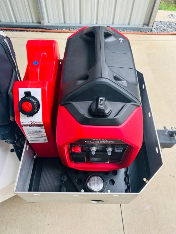

Patriot Posted May 8, 2023 Share Posted May 8, 2023 On 4/23/2023 at 10:58 PM, taylor.coyote said: No doubt Honda has done a great job creating a brand that a lot of people trust and are willing to pay the extra $$... Can you trust a $900 Predator or do you need to spend $2,600 for peace of mind for the Honda 3200? Based on years of trouble free experience with Honda generators, motorcycles, and mowers, I trust Honda products. 3 2020 OLEII - Hull #634 aka- “XPLOR” TV 2021 F350 6.7 liter Diesel Lariat Ultimate Tremor Retro upgrades - Truma Aventa 13.5 AC, Alcan 5 leaf pack, Alcan HD shackles & HD wet bolts, 5200lb axles. XPEL 10 mil PPF front both front corners, 30 lb LP tanks, Sea Biscuit Front Cargo Storage box. North Carolina 🇺🇸 Link to comment Share on other sites More sharing options...

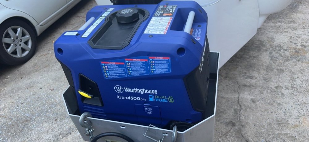

abcsfam Posted September 4, 2023 Share Posted September 4, 2023 I just put this dual fuel Westinghouse in the tray. We live in Alabama and A/C is a fact of life for close weekend trips and it does run whatever we need and charge the lithiums while doing so. I hated buying something this big and heavy but in the moment it seemed like the right gen set. following the purchase of the trailer and I think I will like not having gasoline cans to deal with. I might upgrade to the Honda 3200 in the future once my budget has some time to recover. Link to comment Share on other sites More sharing options...
Moderator+ ScubaRx Posted September 4, 2023 Moderator+ Share Posted September 4, 2023 48 minutes ago, abcsfam said: I just put this dual fuel Westinghouse in the tray. We live in Alabama and A/C is a fact of life for close weekend trips and it does run whatever we need and charge the lithiums while doing so. I hated buying something this big and heavy but in the moment it seemed like the right gen set. following the purchase of the trailer and I think I will like not having gasoline cans to deal with. I might upgrade to the Honda 3200 in the future once my budget has some time to recover. As you know, this generator will run on either gasoline or propane. It is rated at 4500 Watts peak and 4050 Watts continuous running on gasoline and 3700 Watts Peak and 3330 Watts continuous running on propane. The difference is due to the BTU's of gasoline vs propane. There is about a 20% decrease in efficiency using propane. But, you have chosen a great generator and I think going to a Honda 3200 would be a step backward. That 3200 watt rating is contingent on using gasoline. You're much better off with this one as it will easily run your AC or charge your batteries, maybe at the same time plus electric and remote start. What could be better? Good choice. 1 4 Steve, Tali and our dog Rocky plus our beloved dogs Storm, Lucy, Maggie and Reacher (all waiting at the Rainbow Bridge) 2008 Legacy Elite I - Outlaw Oliver, Hull #026 | 2014 Legacy Elite II - Outlaw Oliver, Hull #050 | 2022 Silverado High Country 3500HD SRW Diesel 4x4 Link to comment Share on other sites More sharing options...
Patriot Posted September 4, 2023 Share Posted September 4, 2023 11 hours ago, abcsfam said: I might upgrade to the Honda 3200 in the future once my budget has some time to recover. @abcsfam That Westinghouse 4500 will likely serve you well. I considered a number of different generators when looking a few months ago. I agree with you. The Westinghouse 4500 dry weight at 104 lbs caused me to pause and take a step backward. I have had several Hondas over the years which have always started and served me well. I can honestly say a future upgrade to a 40# lighter “suitcase” Honda 3200i will be so appreciated by your back as the years go by. As an fyi, there is a company called https://genconnexdirect.net/eu3200i. that sells the 3200i with an LP conversion. Pricey at $3200 plus shipping. With a Veterans discount, I paid $2500 at Northern Tool for our gas only 3200i OTD. There are always trade offs. Patriot🇺🇸 4 2020 OLEII - Hull #634 aka- “XPLOR” TV 2021 F350 6.7 liter Diesel Lariat Ultimate Tremor Retro upgrades - Truma Aventa 13.5 AC, Alcan 5 leaf pack, Alcan HD shackles & HD wet bolts, 5200lb axles. XPEL 10 mil PPF front both front corners, 30 lb LP tanks, Sea Biscuit Front Cargo Storage box. North Carolina 🇺🇸 Link to comment Share on other sites More sharing options...
