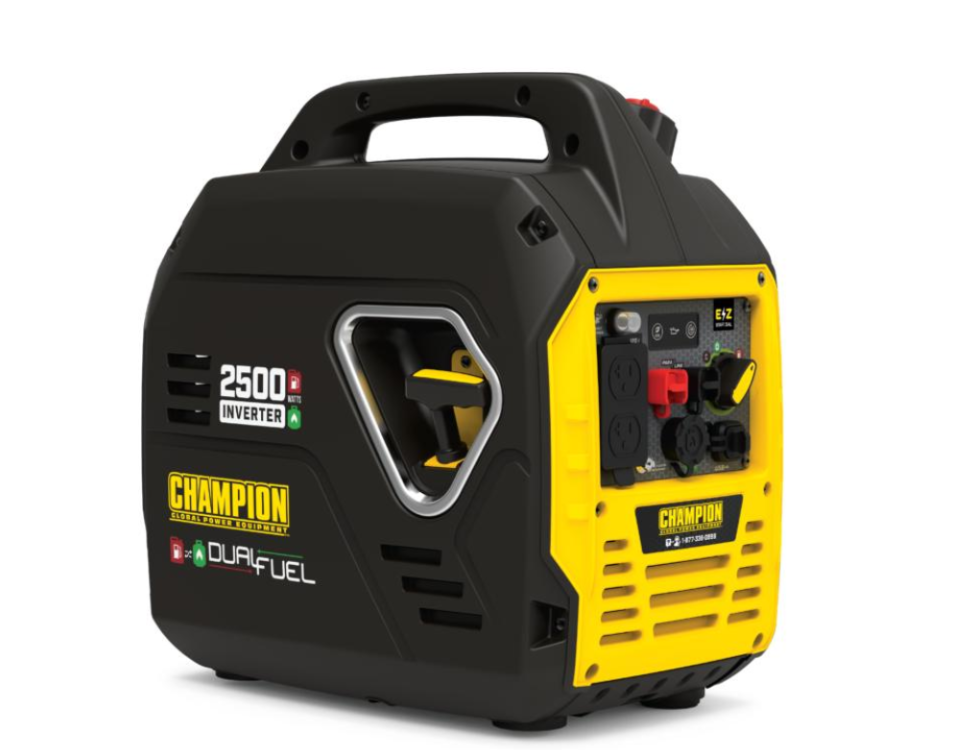

Champion 2500 watt - 79cc.

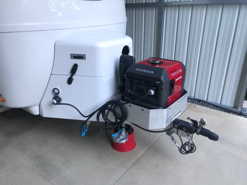

My 3200i will be hopefully soon, I am on the www.hutchmountain.com LP conversion kit waiting list for the EU3200i. I will post up after I receive the kit and run the gen with the conversion kit. I really like the EU3000is LP conversion kit which was a fairly simple install. This gen weighs in at 130# dry and it’s a now tri fuel conversion. LP, LNG, and gasoline.
Patriot🇺🇸
I don’t think there is an industry standard for rating generators. If there is I’m sure most companies are failing to follow it.  2500 watts from a 79cc engine?  Not clean power with any amount of extra capacity.  My guess is if a 1k watt load was hooked up to to a 2200 watt honda it would increase the RPM’s a little bit (half way?) and still be relatively quiet. The 2500 units listed above would probably jump to full power/rpm to achieve the same 1k output, I know mine does.

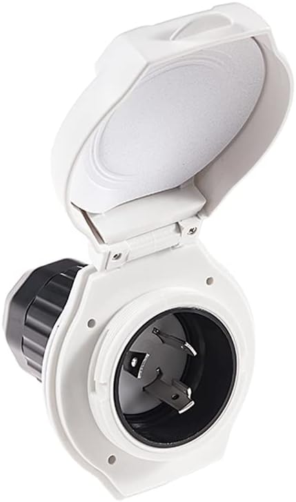

Must be nice/convenient having the forward doghouse mounted 30A shore outlet!  Has anyone researched if this can be retrofitted by an owner - or does it go to the mobile RV tech for installation?  Just curious!
I'm sure it could be. It's a standard outlet you can buy and wire it in like the street side receptacle.
Receptacle
Wire - 10/3 30 amp wire
This is an option which we added to our Oliver build sheet. Yes, it’s totally convenient. I have not seen a post where someone has added this mod.

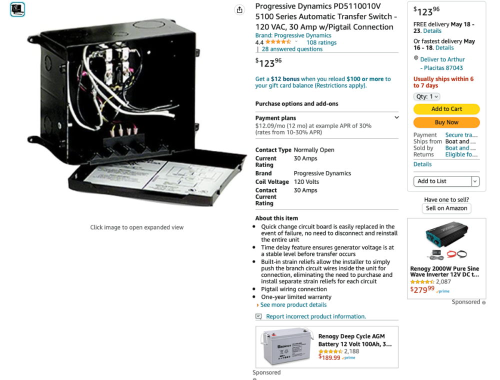

I'm thinking there must be either an automatic or manual transfer switch that allows 30A power from only a single socket at a time.  Is this correct?
Correct.  Oliver installs an automatic transfer switch when the extra 30 amp port is ordered as an option.  For any DIYers thinking of adding the extra 30 amp inlet port themselves, there absolutely must be a transfer switch installed to prevent multiple simultaneous external AC power connections.
@Frank C:  Yeah, thought there had to be a transfer switch between the two outlets.  Anyone know the type/manufacturer of the OTT ATS?
Progressive Dynamics PD5110010V Automatic Transfer Switch With Pig Tail AC Wire Connections
Got a line on it from Amazon - not too bad of a price point for the unit, thanks @ScubaRx
