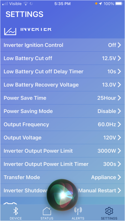

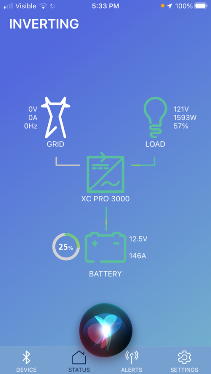

SteveCr Posted May 3, 2023 Posted May 3, 2023 2021 LE 2, lithium pkg, 3000w inverter Below are screen shots of the inverter under load of the microwave running. The microwave had no issues for several minutes. The second screen shot is the inverter settings you can use as a comparison to your settings....just to make sure. Battery low cutoff can be a potential issue that will shut down the inverter before you want. Steve 1 2
Rivernerd Posted May 4, 2023 Author Posted May 4, 2023 Thanks for running the test. It is very helpful! I will test my inverter again tomorrow with the microwave running, and compare the readings on the FXC control app with those you provided, then post the results. Hull #1291 Central Idaho 2022 Elite II Tow Vehicle: 2019 Tundra Double Cab 4x4, 5.7L with tow package
Tom and Doreen Posted May 4, 2023 Posted May 4, 2023 I believe that Oliver recommends that the Xantrex LBCO (Low Battery Cutoff) to be set to 12.1V for systems such as mine that have the Lithionics battery system. My system suffers from a significant resistance in the high current DC line between the battery and the Xantrex whereby the voltage that the Xantrex sees at it's input terminals is less than the actual voltage seen at the battery terminals which is a problem. The result being that the Xantrex reaches it's LBCO and shuts down prematurely ( because it sees a lower voltage than what's actually at the battery terminals). In a perfect theoretical world there would be zero resistance between the battery and the Xantrex and the voltage at the Xantrex input would be exactly the same as what's measured at the battery terminals, however in the real world there will be some resistance and voltage drop but the system should be designed such that the resistance is as low as possible. To achieve this all the components have to be selected for the lowest resistance possible which includes selecting the proper gauge cables, low resistance circuit breaker, proper grounding, and properly assembled contact surfaces. Given that the Lithionics battery has an internal battery monitor that sets it's "Never Die" voltage (the voltage at which the battery shuts itself down to prevent destructive discharge) at 12.0 V it makes sense that the Xantrex LBCO is set to 12.1V however by doing so it is extremely important to keep the resistance between the battery and the Xantrex as low as possible. It is possible to lower the Xantrex LBCO setting to something lower than the recommended 12.1V since the Xantrex sees a lower voltage than what actually exists at the battery terminals, doing this will allow the Xantrex to operate at higher loads for a longer time , however I do not recommend doing this because it masks the real problem which is an accumulated resistance in the high current DC supply line from the battery to the Xantrex. 5 Tom & Doreen • 2023 Elite ll • Hull #1321 • 2023 Tundra Platinum Crew Max • Cheshire CT
SteveCr Posted May 4, 2023 Posted May 4, 2023 Yep, that is how I see it works also. Last year while bookdocking, my batteries were approaching 50% soc and Xantrex would not invert. Reading through the manual, I discovered the LBCO soft switch and adjusted the setting several tenths until Xantrex would invert. I was just careful and monitored the soc. I think the value of keeping the Xantrex LBCO at a higher setting is to prevent an unintended battery discharge.....leaving something on or not realizing you're drawing so many amps. It would be unpleasant to discover the soc at zero....might invoke a few frowns...or worse! You can experiment to discover the relationship of soc to LBCO readings on your system and then determine the LBCO to fit your comfort level. If inverting for an extended time, I would also carefully put my hands on battery/Xantrex/other cables to determine if there is a heat build up issue. That might help identify any loose or corroded connection. There can be a corrosive buildup on a connection that is not seen without disassembly for inspection. Steve 2

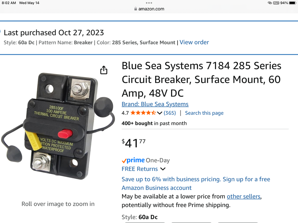

aaronorange Posted May 14, 2025 Posted May 14, 2025 I’m on my 2nd OptiFuse breaker. It trips often. Not sure what to do but I would like to replace it with something better. Hull #1238 - 2022 Legacy Elite II, TB, TV 2017 Tundra TRD.
Ronbrink Posted May 14, 2025 Posted May 14, 2025 (edited) On 5/13/2025 at 9:30 PM, John and Betty said: I’m on my 2nd OptiFuse breaker. It trips often. Not sure what to do but I would like to replace it with something better. I replaced mine with a Blue Seas System breaker, much better quality and no recurring issues. Edited May 16, 2025 by Ronbrink 2 Ron and Brooxie | Clear Lake (Houston), Texas 2020 OLEll, Twin, 579: No installed solar, dual 30# propane tanks w/GasStop safety devices, Renogy 40A DC-DC charger, 460Ah LFP battery bank/Victron SmartShunt, auxiliary Cerbo-S GX/Victron 30A Blue Smart IP22 Charger combo, interior mounted Hughes Autoformer, twin independent sliding Lagun mount tables, extended dinette table and pantry landing, tongue-mounted hoist, Beech Lane refrigerator Ventilation/Evaporate Coil fans, metal valve stems with TST cap sensors and signal repeater, Waste Master sewer hose management system, Dreiha Atmos 4.4 A/C upgrade/Ceilo Breez Max thermostat, FlagpoleBuddy Starlink Mini suction mount kit. 2019 GMC Savana 2500 Cargo Work Van: Explorer Limited SE, Low-Top 7 Passenger van conversion, 6.0L V8 Vortec, 6-Speed Automatic, RWD; Air-Lift LoadLifter air suspension/WirelessAir compressor; Bilstein B6 4600 Series shocks; metal valve stems for TST tire pressure monitoring system; Buyers Products cargo containment boxes/DC Cargo securement system; rear bumper DC-DC Anderson power cable outlet; 100Ah 12V portable power station/Dometic CFX 75L Dual Zone cooler; front 2” receiver hitch/QuikrStuff Mach2 double bike rack; Mechman 320A high output alternator; Starlink Mini/Veritas Vans magnetic mount.
aaronorange Posted May 15, 2025 Posted May 15, 2025 I see the Blue Seas is a 100 Amp fuse while the original Optifuse is 300 did you use this exact fuse? I'm going to try this one as well. Thanks! Hull #1238 - 2022 Legacy Elite II, TB, TV 2017 Tundra TRD.
aaronorange Posted May 15, 2025 Posted May 15, 2025 1 Hull #1238 - 2022 Legacy Elite II, TB, TV 2017 Tundra TRD.

jd1923 Posted May 16, 2025 Posted May 16, 2025 A 300A should be between the battery + and the inverter and a fuse is much preferred over a breaker since it protect both sides, the batteries and the inverter, where a breaker is directional. Our Victron Multiplus specs a 400A fuse for this (ANL or better yet a Class-T fuse). A 60A breaker or less (40A or 30A depending on your equipment) would be used for internal circuits like the 12V fuse panel or solar chargers, etc. I don't see any need for a 100A breaker in the Oliver circuitry, but maybe they're doing something different in newer hulls. Chris & John in Prescott, AZ | 2016 EII #113 | '01 Ram 2500 Cummins!
Ronbrink Posted May 16, 2025 Posted May 16, 2025 (edited) On 5/15/2025 at 11:59 AM, John and Betty said: I see the Blue Seas is a 100 Amp fuse while the original Optifuse is 300 did you use this exact fuse? I'm going to try this one as well. Thanks! Actually, the 60A Blue Sea (not 100A as illustrated in the product pic) replaced a 60A Optifuse for 12V accessary power. The 300A Optifuse you refer to is likely the breaker for the battery bank to inverter. Edited May 17, 2025 by Ronbrink 1 Ron and Brooxie | Clear Lake (Houston), Texas 2020 OLEll, Twin, 579: No installed solar, dual 30# propane tanks w/GasStop safety devices, Renogy 40A DC-DC charger, 460Ah LFP battery bank/Victron SmartShunt, auxiliary Cerbo-S GX/Victron 30A Blue Smart IP22 Charger combo, interior mounted Hughes Autoformer, twin independent sliding Lagun mount tables, extended dinette table and pantry landing, tongue-mounted hoist, Beech Lane refrigerator Ventilation/Evaporate Coil fans, metal valve stems with TST cap sensors and signal repeater, Waste Master sewer hose management system, Dreiha Atmos 4.4 A/C upgrade/Ceilo Breez Max thermostat, FlagpoleBuddy Starlink Mini suction mount kit. 2019 GMC Savana 2500 Cargo Work Van: Explorer Limited SE, Low-Top 7 Passenger van conversion, 6.0L V8 Vortec, 6-Speed Automatic, RWD; Air-Lift LoadLifter air suspension/WirelessAir compressor; Bilstein B6 4600 Series shocks; metal valve stems for TST tire pressure monitoring system; Buyers Products cargo containment boxes/DC Cargo securement system; rear bumper DC-DC Anderson power cable outlet; 100Ah 12V portable power station/Dometic CFX 75L Dual Zone cooler; front 2” receiver hitch/QuikrStuff Mach2 double bike rack; Mechman 320A high output alternator; Starlink Mini/Veritas Vans magnetic mount.
