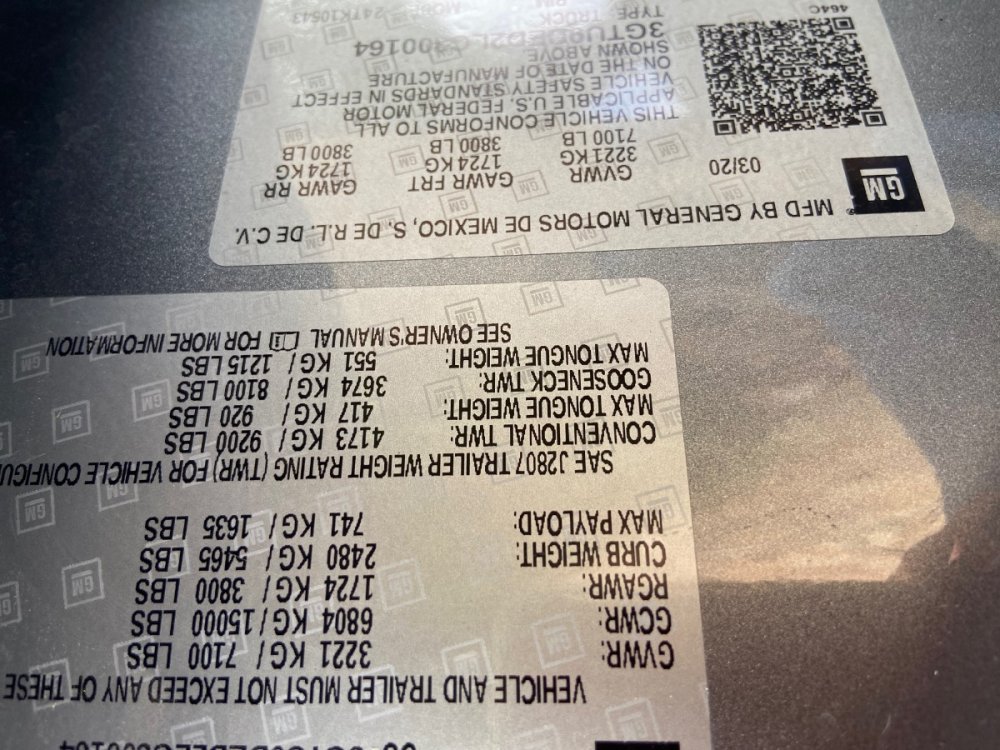

EricG Posted May 11, 2023 Share Posted May 11, 2023 Hi everyone, I don’t have an Oliver yet, but seriously looking at the Elite II (I will go the used route if possible). I have a 2020 GMC Sierra Crew Cab with 5.3, 10 speed transmission, 4x4 with tow package. Based on numbers (will attach), I will be able to use this as my tv. I’m looking to see if anyone with this truck can really tell me how well, or poorlyit does. I know this is a little subjective, but thought I’d ask anyway. I know it won’t be as effortless as a 3/4 ton. I understand that I will need to use a wdh. Payload in truck would be 300# of humans and 60# of dog. We haven’t been camping/road tripping in a lot of years, so I know it may be easy to get close to payload capacity. I looked at a couple of 2500 today-huge increase in payload, but mine is paid for so I’d like to see it work, but am realistic. Anyway, let me know your experiences (if any). Thanks. No matter how I orient the picture in my files, it loads here upside down-sorry. Eric 1 Link to comment Share on other sites More sharing options...
Ray Kimsey Posted May 11, 2023 Share Posted May 11, 2023 Hi Eric, I cannot speak to the Sierra, but I have a 1500 Ram (5.7 liter and 3.92 axle ratio) with payload very similar to yours, 1665 lbs. I use the weight distribution hitch and having been pulling our 2020 LE2 up and down the east coast without issues. Our typical trailer total weight is around 6,000 to 6,100 lbs and a tongue weight of 650-660 lbs. I do keep a close track on the payload. The bigger truck would definitely make things a lot easier though. Hope this helps. 1 2019 Ram 1500 5.7L V8, 3.92 axle ratio - 2020 LEll - Hull676 Link to comment Share on other sites More sharing options...
EricG Posted May 11, 2023 Author Share Posted May 11, 2023 34 minutes ago, Ray Kimsey said: Hi Eric, I cannot speak to the Sierra, but I have a 1500 Ram (5.7 liter and 3.92 axle ratio) with payload very similar to yours, 1665 lbs. I use the weight distribution hitch and having been pulling our 2020 LE2 up and down the east coast without issues. Our typical trailer total weight is around 6,000 to 6,100 lbs and a tongue weight of 650-660 lbs. I do keep a close track on the payload. The bigger truck would definitely make things a lot easier though. Hope this helps. Thanks for the response Ray. That’s kinda what I thought, although you have a better axle ratio than in my truck. Decisions, decisions. 1 Link to comment Share on other sites More sharing options...
Moderators SeaDawg Posted May 11, 2023 Moderators Share Posted May 11, 2023 Hope someone can speak up. Reading your specs, albeit upside down, looks like you should technically be golden I like a 20 per cent margin. You'll need the wdh. As my daily driver is a 2005 Silverado 1500 stepside, you have to know I'm in the "love the one you're with" camp, if tv has decent specs. My friend (and my longterm mechanic ) and I were laughing the other day about our 2005s. We're in no rush to replace reliable equipment, paid for a long time ago. 4 2008 Ram 1500 4 × 4 2008 Oliver Elite, Hull #12 Florida and Western North Carolina, or wherever the truck goes.... 400 watts solar. DC compressor fridge. No inverter. 2 x 105 ah agm batteries . Life is good. Link to comment Share on other sites More sharing options...

EricG Posted May 12, 2023 Author Share Posted May 12, 2023 Thanks to everyone for your input, and to John E.Davies for orienting my picture correctly (show off 😊). I don’t have a lot of recent experience towing (used to tow a motorcycle trailer and a 16ft pop up camper after that), and no real experience with travel trailers, or wdh’s. I’m a pretty safety conscious person on top of that, which is why I asked for experiences and advice. Thanks for a great forum/sounding board, much appreciated. I’ll put some good thought in to my next steps regarding a travel trailer and tow vehicle. Eric 1 2 Link to comment Share on other sites More sharing options...
