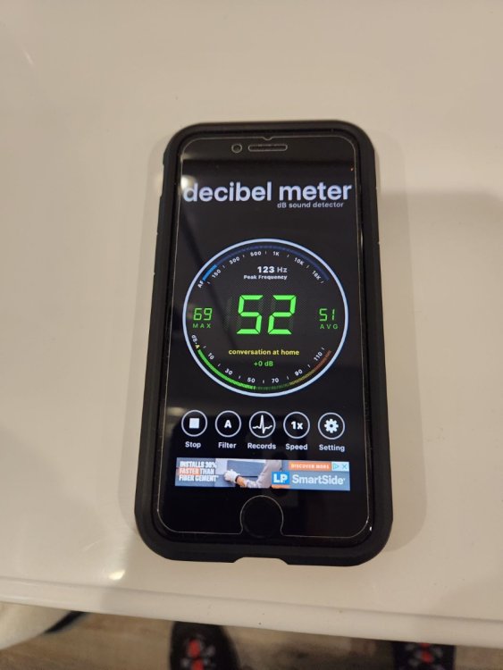

Happy to report that I have installed the Dometic FreshJet air conditioner on my Oliver this week.
The install was fairly easy only taking a couple hours for two of us to complete. I rigged up a 3 to 1 pulley system in my workshop to lift up and remove the old noisey Penguin model. The new FreshJet is significantly lighter than the old unit, and a friend and I were able to stand on some scaffolding and lift it up and onto the Oliver. The wiring connections were easy to complete using the existing thermostat control box.
I purchased the FreshJet 3 Series from RV Parts Country;  $896.00 plus $124.00 shipping.
So far my wife and I are happy with the performance of the FreshJet, it quickly brought down the indoor temperature and humidity on a hot Tennessee summer day. Best of all is the difference in the sound levels between the old and new units (69db versus 52db).

@rangered, that's an amazing difference in the sound level.
Well look forward to your reports as you get to use it, camping.
Thanks for the photos and post.

I just did a db reading from my Freshjet and it was 62 average right under the unit running it on solar. I alsi did a video for reference.
2022 EII owner, Hull 1284, Tow Vehicle: 2021 Nissan Titan XD. 2022 lithium pro package which is 630 amp hours and 340 watt panels with a 3000 w inverter.
Nice and quiet!  You could actually hear your voice very well over the db's of the unit - impressive!  Thanks for sharing this video...
IMG_2501.mov
That is so awesome! Thank you for sharing the video. Really nice to hear your pretty voice clearly, with the ac running.

I am glad the video was helpful. My info is below and I will add that to my signature. I was just running it to share the sound level with someone else who asked. But I did run the AC for a couple hours when I was traveling last month and it dropped the battery about 20%.

I had mine installed by an RV shop. According to them, no modification was needed on the entry hole and the condensation lines are the same. I did not relocate anything as far as the temperature box. I am using the existing dometic thermostat.
@rangered did his own installation and can provide more details on that. He also got a lower db reading than me. I was using my phone to measure, and it looks like he has an actual db meter.
