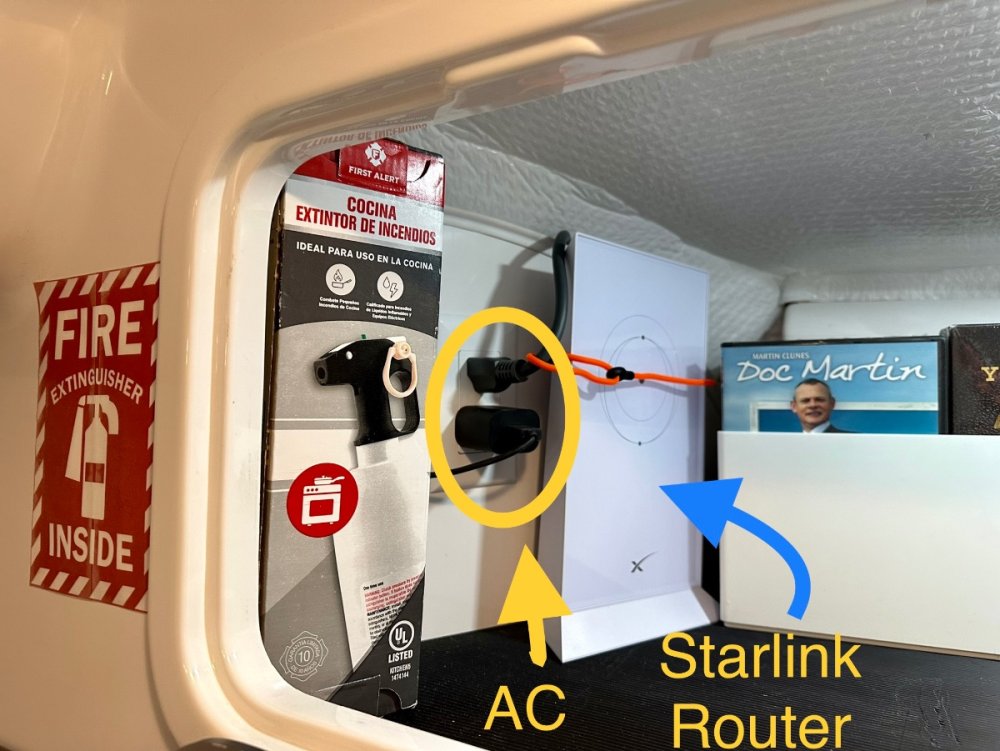

2) Mounting the Router - In the Rear Attic and Running Cable into Basement
I mounted the router inside the rear attic cabinet.
It's held in place by a simple orange strapping tie that feeds through a hook-eye behind the router.IMG_1001.thumb.jpeg.f4e1c0877a11e5bab0908161afd689e6.jpeg
This is a good spot for the Router as it's close to a 110V outlet, and easy to run the cables under and behind the back of the cabinet over to the right side then down to the basement area.

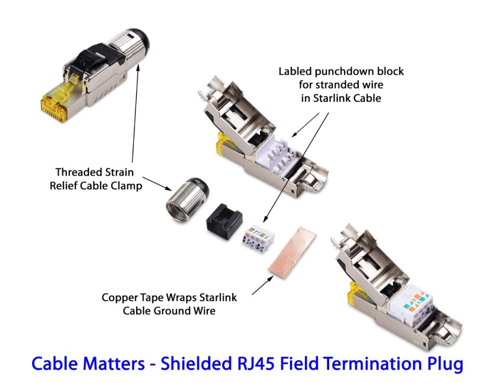

3) Install new RJ45 male plug on cable in basement:
Pro TIP: Use metal field termination plugs for the Starlink cable cut ends if possible/
Trying to use the typical plastic RJ45 connectors is a real hassle as the conductors in the starlink cable which stranded and thicker than normal.
I spent well over an hour trying to get my shielded/plastic RJ45's to work.  I finally said let's try a real metal coupler.
In the picture below is the plug I bought from "Cable Matters" on Amazon  $6 ea.
They feature a clearly labeled punch down block, a threaded strain relief clamp and copper foil tape that is used to wrap the ground (or drain) wire around the cable shaft where it enters the connector.
This is the connector I used on the inside of the trailer connecting the Router to the Thru Hull plug.

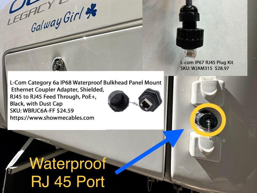

4) Install the Thru Hull Connector and connector for Cable to Dish
I purchased an L-Com IP68 (waterproof) through hull connector specifically designed for shielded PoE Connections.
I also purchased a matching L-Com connector kit for the cut end of the Starlink cable.  This matching plug screws onto the outside connector
for a waterproof sealed connection.
I placed the connector mid line between the two existing connectors leaving both the Cable and Satellite COAX's in place.
The new bulkhead coupler fits exactly between those two connectors, but I would suggest shifting UP 3/16" from center to allow the bottom door to fully open. (It's the 'satellite coax' in my case which I never use.)
