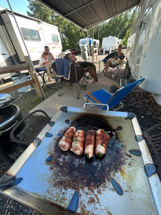

We're on a road-trip this week (ABQ - DEN) and trying out our new custom "Disk-it" for the first time.  Made and patented by a friend who owns a fabrication shop in Albuquerque.  Comes with either a griddle or wok (we ended up getting both).  The custom "piece" comes in when one orders their laser-cut "symbol" on the Disk-it stand and on the griddle handles.  D opted for a "tree-of-life" symbol and our names on the handles.  Oops, sorry - probably quasi TMI; but this kit rocks!  The piezo-light 2-stage burner pumps out north of 75k BTUs.  The rig connects to the OTT front LPG port, folds-up and stows nicely in the truck bed.
Griddled spicy shrimp, stuffed jalapeños, and mixed stir-fry last night - yum!

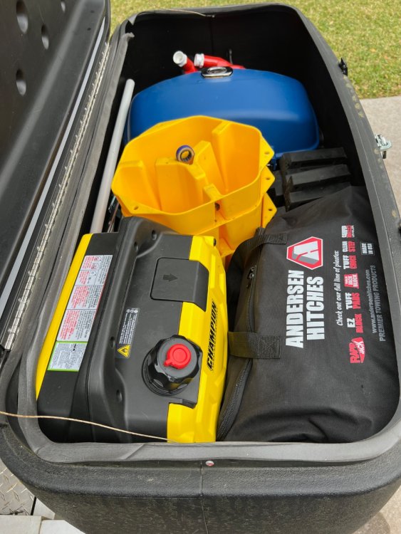

PIT BOSS PB336GS Two Burner Portable Flat Top Griddle - Cover Included.
I store it in the front basket strapped down with bungee cords. When cooking I remove the cover, hook up the gas, and cook with it sitting in the basket.

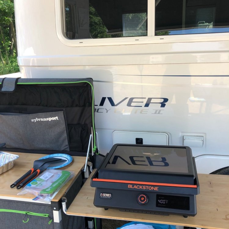

We love our electric nonstick  Blackstone! We have both the gas and electric but prefer the electric. We also have a Weber 1200 grill but we always end up just using the Blackstone.

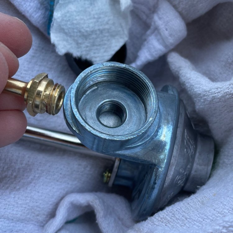

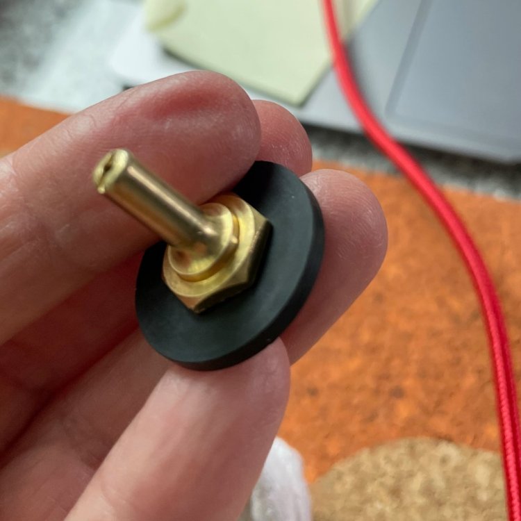

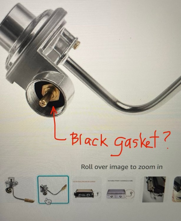

For anyone with a Blackstone Griddle (17" or 22") -- I had an issue the other day: when I went to remove the 1-lb cylinder from the regulator (so I could drive down the road and not have it bouncing around) the brass tip of the regulator came OFF the regulator and stayed IN the cylinder. This meant that all the remaining propane came spewing out. No fun, and wasteful. The odd thing was that when I retrieved the brass tip (using needle-nose pliers, because the nut section was recessed into the well in the can) I didn't find any sort of gasket or see any residue of pipe dope, and I thought it was odd. I placed a ticket online with Blackstone hadn't heard back. My friend and I kept thinking that SURELY there would be a gasket in there; it's brass to some other gray-colored metal on the regulator.
I had already searched Blackstone's website and manual for better information and photos or diagrams of that regulator. Then I decided to search online for other websites with photos -- Amazon, the ubiquitous search machine, provided a key photo that showed that end of the device and I could see a black gasket in there. THEN I remembered a black gasket I found near my truck, I pulled it out of my little 'lost and found' container...  how about that!  I called Blackstone's number to see if I could verify that there wasn't another gasket or pipe dope missing. Their phone service person kept referring to the brass tip as "broken" and saying that "this happens a lot and we just send you a replacement" and I kept trying to explain to her that it didn't "Break Off" it had merely come unscrewed (threaded same direction as the propane cylinder).  She asked if I would send her photos, and I obliged and she exclaimed, "OH! I didn't know that piece was threaded because all I could see was that black thing."
So for all the bad reviews and complaints on the regulators not working -- I have to wonder what percentage have this happen. I'm going to attach photos in case anyone runs into this. If a person didn't pay attention, the brass tip might be tossed with the spent cylinder.
I'm still not certain whether it needs pipe dope or tape, and also not certain how tightly I should screw this down. I don't have a tool that fits OVER the tip and INTO the well (I checked) so needle-nose pliers are all I have to work with... thoughts and suggestions welcome.

Seems like there should be a gasket in there.  I don’t use the small cylinders, camping I put the Blackstone on the trailer QC and at home I use a 20lb tank.  Maybe someone who uses the cylinders can comment.  Mike
