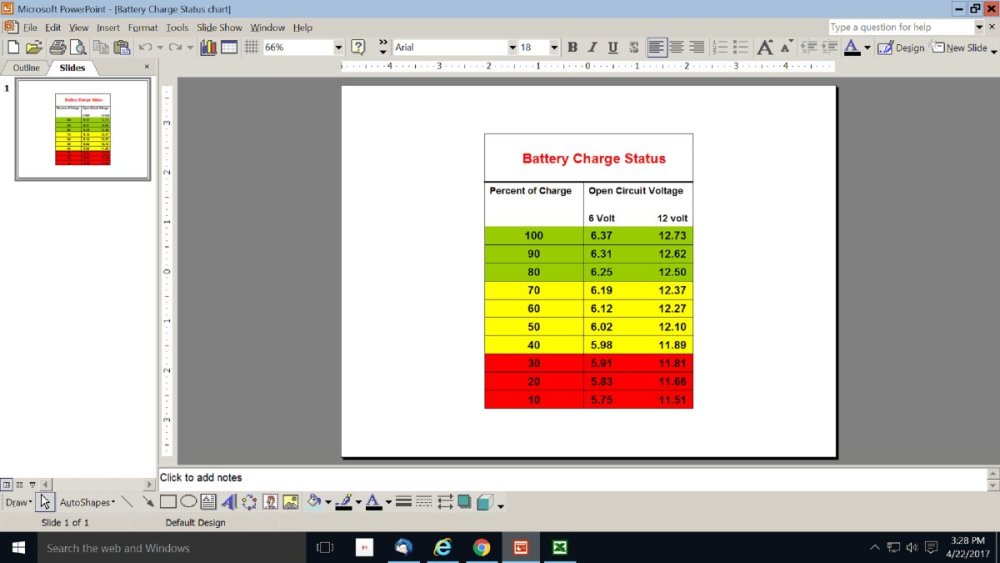

Moderators topgun2 Posted June 30, 2023 Moderators Posted June 30, 2023 (edited) Perhaps the charts below will help - for lithium (see 1st chart) and lead acid and AGM batteries (see 2nd chart). Edited June 30, 2023 by topgun2 added detail 2 2023 Ford F150 Lariat 3.5EB FX4 Max Towing, Max Payload, 2016 Oliver Elite II - Hull #117 "Twist" Near Asheville, NC
