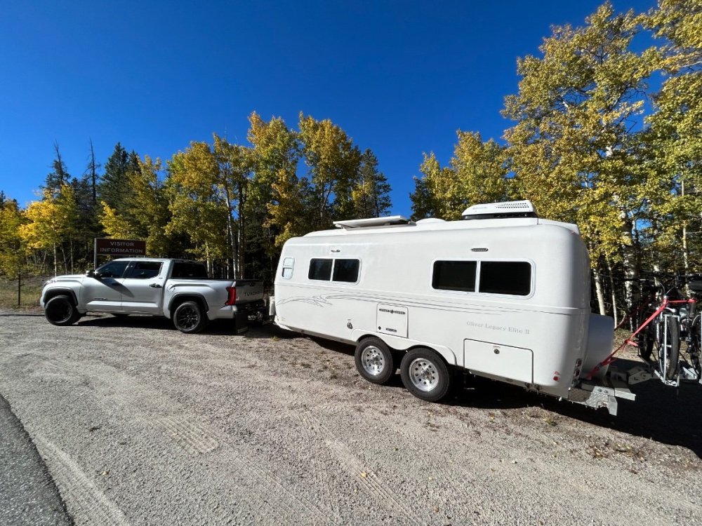

We're in Crested Butte, Co this weekend and have had a wonderful fall-colors tour.  Our Tundra took us smoothly over Wolf Creek Pass (10,800') and Buffalo Pass on CO 114 (10,300') with no signs of struggling at all.  We travel fairly light -  used less than 1150lbs of our 1400lbs useful load.  Tongue weight right at 495lbs.  Fuel mileage for the 748-mile trek came in at 13.5mpg.
Casablanca at Buffalo Pass...  The Tundra is a good match for how we travel with our OTT, IMO.
Cheers!
Wow!
We have not had our Tundra/Ollie rig that high before. How does the performance of your rig at higher elevations compare to lower elevations? Always assumed the twin turbos would perform well at high elevations..

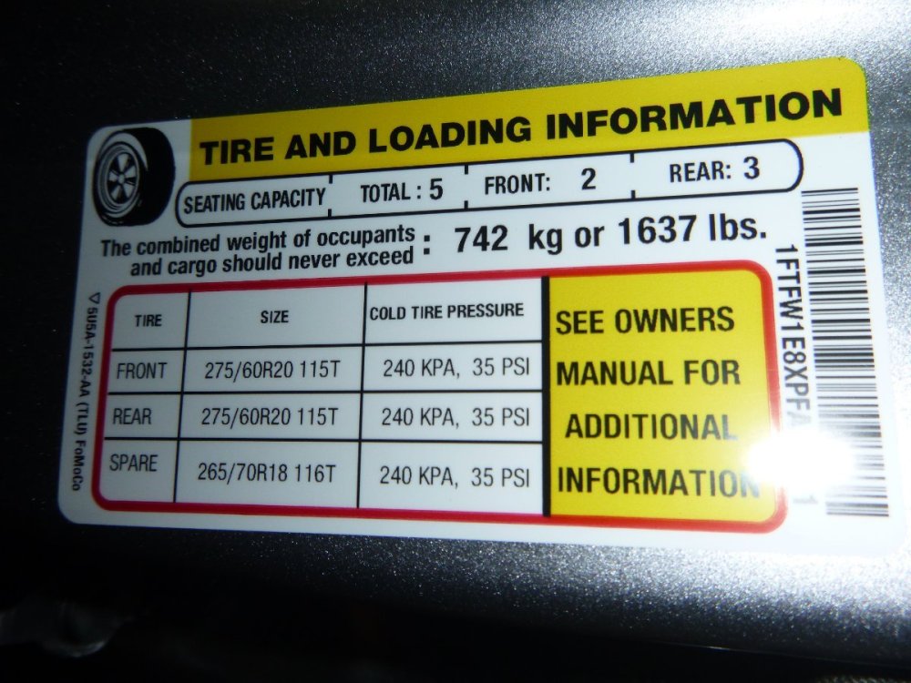

2 hours ago, MAX Burner said:
What's the placarded "not to exceed" payload on your Ford Eco?  Just curious.
2023 F-150 Lariat 6.5 foot bed, 3.5 liter Ecoboost engine, max tow, FX4 (mild offroad 4x4), power tailgate with entry steps, power runningboards.

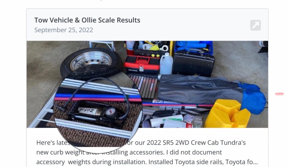

12 hours ago, rideandfly said:
A year ago weighed the Tundra with all contents removed,
I have to ask, how long does it take to fill that Ollie spare tire with the foot pump?  🤔

1 minute ago, rideandfly said:
Silly question, foot pump is for motorcycle and small utility trailer, not for spare tire.
And here I thought that you were working on building those quads!😉
