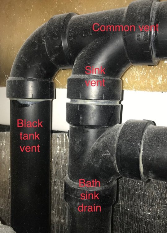

Townesw Posted September 11, 2023 Share Posted September 11, 2023 Pictures under the bathroom sink. When water in black tank can’t go out the dump valve it fills the black tank then goes up the black tank vent and down the sink drain to the grey tank if the back flow valve is open View looking down at top corner of black tank and sink drain going under shower View looking at plumbing under vanity adjacent to inside of front wall Path black water takes if black dump valve is closed and water is still filling black tank When water from black tank fills the grey tank it comes up through shower drain. If back flow valve is closed it doesn’t fill grey tank but comes up through shower drain anyway. Either way nasty stuff. 2 7 Bill and Martha 2018 LEII Hull 313 2019 Chevrolet 2500HD Duramax Link to comment Share on other sites More sharing options...
Moderator+ ScubaRx Posted September 11, 2023 Moderator+ Share Posted September 11, 2023 3 hours ago, Townesw said: Pictures under the bathroom sink. When water in black tank can’t go out the dump valve it fills the black tank then goes up the black tank vent and down the sink drain to the grey tank if the back flow valve is open when water from black tank fills the grey tank it comes up through shower drain. Nasty stuff. If back flow valve is closed it doesn’t fill Grey tank but comes up through shower drain anyway. Either way nasty stuff. Thanks Bill for the pictures. You perfectly illustrated what I was trying to put into words. 1 3 Steve, Tali and our dog Rocky plus our beloved Storm, Maggie, Lucy and Reacher (all waiting at the Rainbow Bridge) 2008 Legacy Elite I - Outlaw Oliver, Hull #026 | 2014 Legacy Elite II - Outlaw Oliver, Hull #050 | 2022 Silverado High Country 3500HD SRW Diesel 4x4 Link to comment Share on other sites More sharing options...

MAX Burner Posted September 11, 2023 Share Posted September 11, 2023 @Townesw: Outstanding visuals of a few of the key plumbing fixtures for the head - I'm breaking out my label-maker right now... Thanks for the effort for posting that info - very helpful! Art, Diane, Magnus & Oscar (double-Aaarrf!) 2022 TUNDRA 2017 LE II; Hull #226 "Casablanca" HAM call-sign: W0ABX Link to comment Share on other sites More sharing options...
