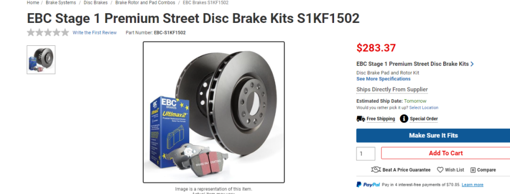

jd1923 Posted October 1, 2023 Author Posted October 1, 2023 Since last week, I now have two wheels clean! It's a lot of heavy work with the heavy grinder and I like to space out the really physical jobs to only a few hours a day. There are other chores. Just received my brake upgrade! Going to 17" wheels allows me to upgrade brakes, from Dodge 2nd Gen to 3rd Gen brakes. The rotors are 1" larger diameter and thicker material. Parts include a pair of wider caliper brackets and upgraded EBC rotors and pads. It's amazing, but the calipers are the same, as they are HD already. Purchased all parts at Summit: EBC Brakes S1KF1502 EBC Stage 1 Premium Street Disc Brake Kits | Summit Racing Check the pic below! This must be a 60% increase in brake contact area for my truck. What an amazing product! You guys with newer trucks, install EBC pads and rotors on your next brake job. Didn't want drilled or slotted rotors or anything. These look great, just dark and huge! 2 Chris & John in Prescott, AZ | 2016 EII #113 | '01 Ram 2500 Cummins!

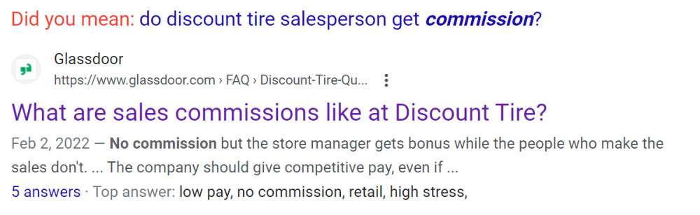

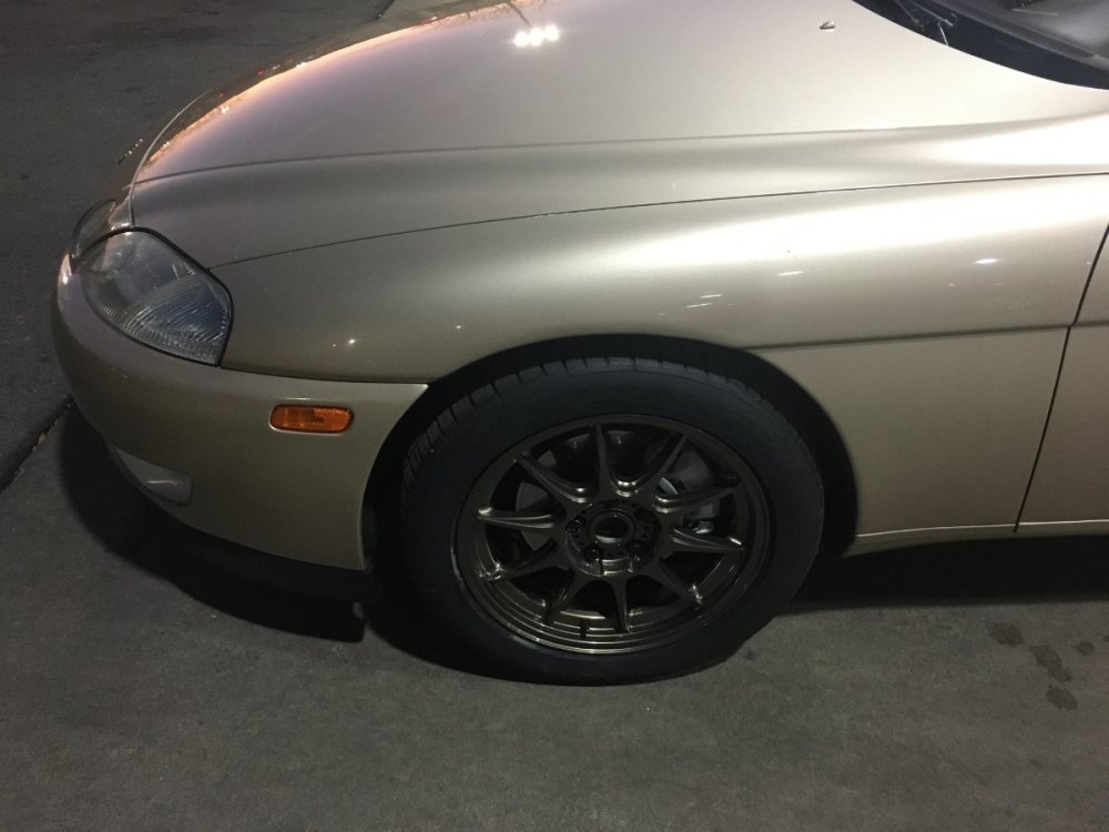

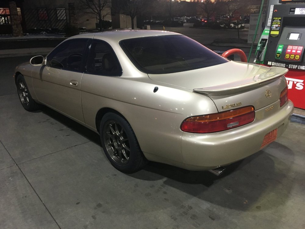

jd1923 Posted October 22, 2023 Author Posted October 22, 2023 Purchased my new tires this week. I went with SIMPLETIRE, after dealing with a young 'know-it-all' at Discount Tire, having upset me with his spiel, obviously on commission, wanting to sell me a house brand nobody has EVER heard of, but of course it's "in stock today!" Should I forego my endless hours of online research, and go with the opinion of a 20-sompfin? No. I have purchased 5-6 sets of tires from this chain, but not this time. I had NO idea that I would buy the Continental brand for my truck. Last year was the first time I purchased this German brand for my '92 Lexus SC400 sport coupe. Need a tire for something sporty, I promise you, go with these: ExtremeContact™ DWS06 Plus | Continental Tire However, we NEED high-end LT tires for our trucks. I went with these: TerrainContact™ A/T | Continental Tire. Sorry you Michelin guys, but I believe their corporate mission is mileage over performance, and I will forego 10K miles on a set of tires for performance ANY day. I was thinking Cooper AT3 to start, and we have these on our GX470 and very happy with them, but I wanted something new, and something stronger higher performing! I have purchased many sets of tires from Tire Rack also. I ordered these from SIMPLETIRE since they have local installers and one of them is a shop we use for service, when I'm not wanting to do the work. Ordered Wednesday, they shipped Thursday from Phoenix, and they arrived on Friday. Too bad their first available appointment is Monday, not too bad. More info coming soon. This guy was the straw. He's just an old-school tire guy and his message hit home with me! The feature that really stuck me with this AT tire is that it has outer treads that are connected inline like a HT tire with extremely large rainwater channels. This is the best of AT and HT designs for your LT tire! Chris & John in Prescott, AZ | 2016 EII #113 | '01 Ram 2500 Cummins!
John E Davies Posted October 22, 2023 Posted October 22, 2023 14 hours ago, jd1923 said: my '92 Lexus SC400 sport coupe. We sold my wife’s ‘98 SC400 two years ago, got about $11,000 for it online. They are very very neat cars, if you have any issues or want to chat, PM me. For example, when your failing capacitors in the ECU destroy the mother board, and they will fail, they cause all sorts or crazy issues, an easy $150 fix, if your board is OK. It’s a pay me now a little, or pay me later a lot thing. John Davies Spokane WA SOLD 07/23 "Mouse": 2017 Legacy Elite II Two Beds, Hull Number 218, See my HOW TO threads: Tow Vehicle: 2013 Land Cruiser 200, 32” LT tires, airbags, Safari snorkel, Maggiolina Grand Tour 360 Carbon RTT.
jd1923 Posted October 22, 2023 Author Posted October 22, 2023 1 hour ago, John E Davies said: We sold my wife’s ‘98 SC400 two years ago... John, I should have bought yours! The 1998 has the higher HP engine, variable timing, etc. Mine is the first year 1992, 90K miles for $12,500 in Phoenix. I love driving 2DR HT rear-wheel drive cars and trucks, won't buy a FWD car. We also have a 2000 Lincoln LS, a 4DR but also v8 with RWD (found it up in Gillette WY 3 years ago with only 11,600 miles). Need AWD, then we drive the GX470! Had more in the past, but currently are a 2-car, 3-truck family (got an old T100 on the lot too). Pretty copperish color with good maintenance history, was dealer exec owned. No issues yet, but will keep you in mind, thanks. In one year, only changed the oil, flushed brake fluid, new wiper blades, hood struts and a beautiful set of wheels and tires! 1 Chris & John in Prescott, AZ | 2016 EII #113 | '01 Ram 2500 Cummins!

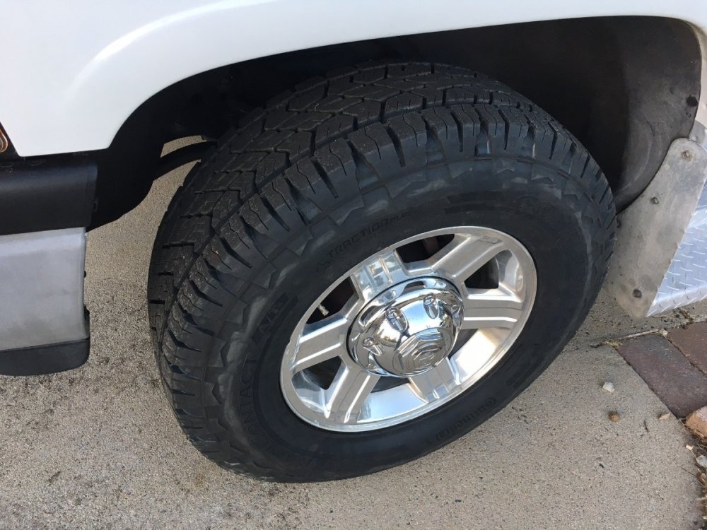

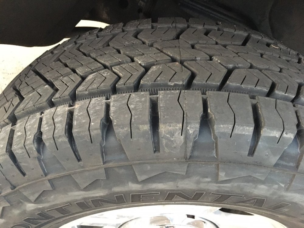

jd1923 Posted October 24, 2023 Author Posted October 24, 2023 OK, enough about tires on other vehicles (sorry about the tangent)... Had my new tires mounted on our tow vehicle today!!! Everything worked out better than expected, as I was truly worried (whenever I'm not personally doing the work myself, I worry)! I asked the shop to mount BSW out (I really wanted to mount OWL out this time, since our truck is white, but the white lettering was scuffed on most tires, not like back in the day, when you would read BFG, Goodyear or Cooper clearly). Also, please use tape-on vs. clip-on weights mounted to the rims, and finally please let me know, call me if any wheel needs much more than 8 OZ of weight to balance. Everything worked out great! Today was a very good day. Drove the truck home and right away I could feel that these tires track better. I will need to go out again, when I have more time, to get up to highway speeds, though all is looking A+ positive. I was able to mount the newer model 17" Dodge Ram wheels and mount the original center caps from my 2nd Gen Ram. So, we have 2023 high-end Continental TerrainContact AT tires, on 2010 Dodge Ram wheels, on an older yet amazing 2001 2nd Gen Dodge 2500 Cummins. Ya gotta love it, but what's important is we love it! Two wheels took 8 oz weights to balance. One took only 4 oz and the best tire took only 2 oz - amazing! When you're considering truck wheels, these weighing 56 LB each, 8 oz is .009 of the total tire weight. When you consider the weight of the wheel, the brake rotor and all moving parts, the number would be more like .004! These are good numbers, very good! Before the weekend, I will have the 17 front brakes shown above installed and we are on our way to an amazing tow vehicle. Our 2001 Dodge Ram 2500 was under 20K at purchase and will be under $30K when done, with more improvements to come! I'm very, very happy today after our rebuilt and tested suspension, a well-balanced drivetrain, including these amazing Dodge Ram wheels & new tires! 😆 1 Chris & John in Prescott, AZ | 2016 EII #113 | '01 Ram 2500 Cummins!

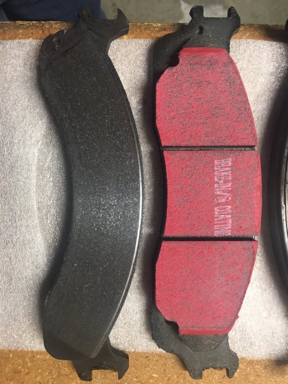

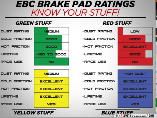

jd1923 Posted October 27, 2023 Author Posted October 27, 2023 New 17" wheels, time to mount the Dodge Ram 3rd Gen 17" brakes, with my EBC upgrade parts and reman caliper brackets, that have been sitting on my workshop bench for a while now. Had time to get one side done today. All I can say is NICE! A shout-out to the members of the Cummins Forum to make me aware of this possibility! This is a more important upgrade, living in the mountains, than tire brand choice. Looking good so far, more to come after left side and test drive... 1 1 Chris & John in Prescott, AZ | 2016 EII #113 | '01 Ram 2500 Cummins!

jd1923 Posted October 29, 2023 Author Posted October 29, 2023 Finished my 17" brake upgrade on the driver's side today. Chris helped me with bleeding again. She has a strong right foot; from all the brake jobs I've done! Mounted the front wheels and dropped it off the jack stands. Backed out and WOW these brakes are crazy good! I need to stay off any hard braking for 1000 miles, except if needed for emergency purposes. I drove around the neighborhood, getting up to speed and then dragging the brakes gently. When I got home the brake rotors looked perfect. All the black coating had worn off evenly and nothing there but a perfectly flat steel rotor surface. Nice! 🙂 1 Chris & John in Prescott, AZ | 2016 EII #113 | '01 Ram 2500 Cummins!
