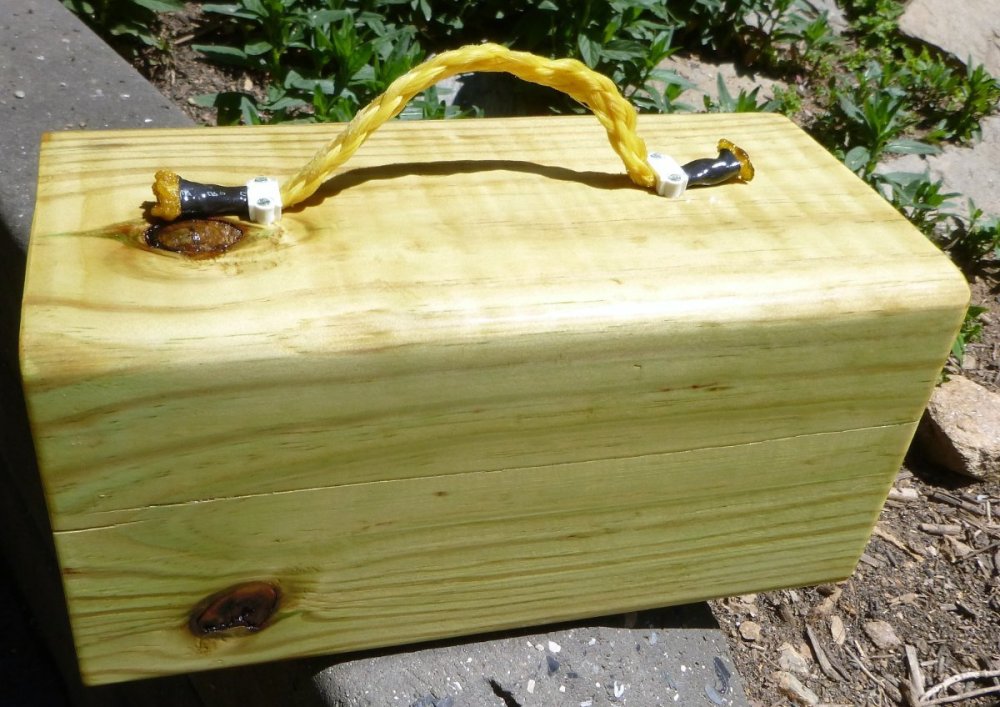

Moderators topgun2 Posted January 28, 2024 Moderators Posted January 28, 2024 32 minutes ago, Dennis and Melissa said: Any feedback? The Andersen ramps are great. But - you can certainly make the Andersen "Blocks" a bunch cheaper. Find or buy a treated 6x6 piece of lumber. Cut into a couple of pieces of between 10 and 11 inches. If you want to get fancy you can put a handle on them and give them a coat or two of sealer. Then, unlike the Andersen blocks you can use these on end for 10 to 11 inches (note that this is about the distance to the bottom of the jacks on level ground minus an inch or two) or you can lay these on their side for a 5 to 6 inch height. Keep your eye out for someone building a new house and/or deck. Many time this is the place where you can ask for "cut-offs" that are just the right size for your purpose. Bill p.s. another "benefit" is that if you ever drive off without them you don't have to beat yourself up over the cost of getting new ones.😃 4 1 2023 Ford F150 Lariat 3.5EB FX4 Max Towing, Max Payload, 2016 Oliver Elite II - Hull #117 "Twist" Near Asheville, NC

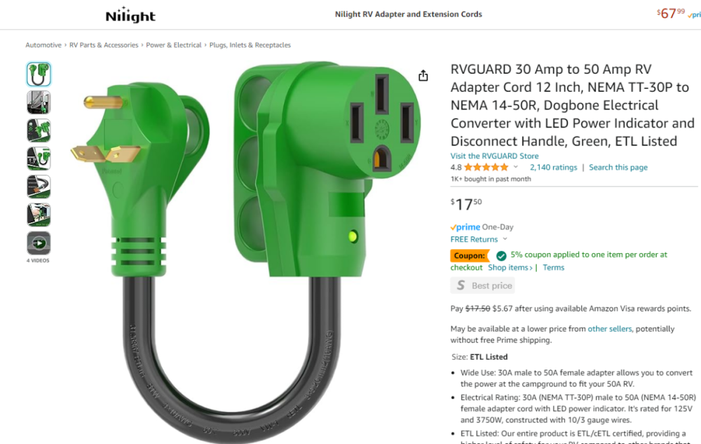

Dennis and Melissa Posted February 18, 2024 Author Posted February 18, 2024 Our first campground reservation is 50amps. So, I'm figuring I need one of these, right? 2024 OLEII - Hull MDIV, born 3/13/24 Ram 1500 5.7L 8 cyl hemi, 4wd, max tow, air shocks, 6’4” box, crew cab

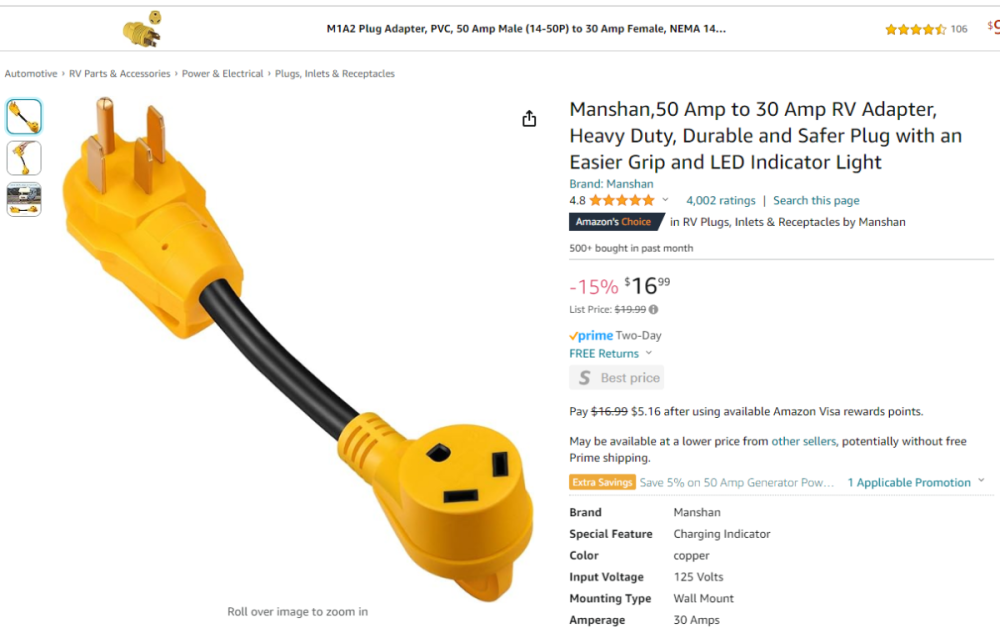

Dennis and Melissa Posted February 18, 2024 Author Posted February 18, 2024 I think I got it precisely backwards. I think I need this instead. 7 2024 OLEII - Hull MDIV, born 3/13/24 Ram 1500 5.7L 8 cyl hemi, 4wd, max tow, air shocks, 6’4” box, crew cab
Moderators topgun2 Posted February 18, 2024 Moderators Posted February 18, 2024 Yep - #2 not #1. Or, you could ask the campground where you have the reservation if they could move you or if the site you have reserved also has a 30 amp plug at the pedestal - many do. Bill 1 2 2023 Ford F150 Lariat 3.5EB FX4 Max Towing, Max Payload, 2016 Oliver Elite II - Hull #117 "Twist" Near Asheville, NC
Moderators Mike and Carol Posted February 18, 2024 Moderators Posted February 18, 2024 Most campgrounds that say 50a also have a 30a and 20a right in the same box. 2 2 Texas Hill Country | 2016 Elite II #135 | 2020 Ram 2500 6.7L Cummins
