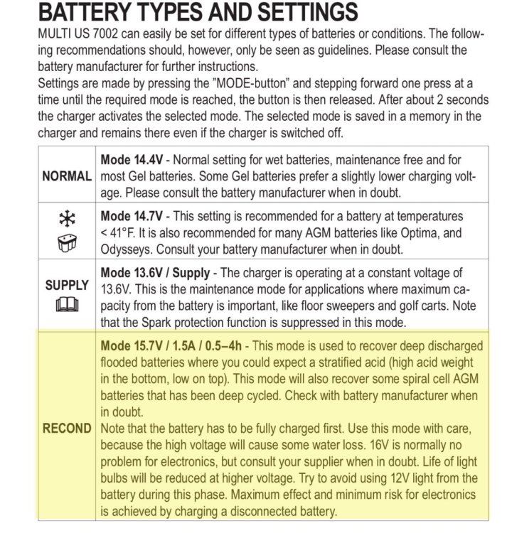

John E Davies Posted November 26, 2023 Posted November 26, 2023 Well, the odds are that they are wrecked, but it is worth trying to salvage them, a charger with a “reconditioning” feature might possible revive them, unfortunately with four (?) batteries, the odds are high that at least one is irredeemable, so you may end up replacing them all, so that one bad unit won’t discharge the others…. i have a 6 amp C-Tek charger that I used successfully on my truck when I left a dome light on for several weeks over the summer, the battery appears to be fine now, but it may prove to be toast once the winter chill sets in… I did disconnect the leads when charging, to protect the vehicle systems from the higher voltage.  This charger is way too small for your big storage batteries, it might be best to talk to a local shop. CTEK (56-353) MULTI US 7002 12-Volt Battery Charger,Black Keep in mind a retail shop will be eager to sell you new batteries rather than fixing your old buggered ones. Maybe an auto-electric repair service would be more productive. Good luck, I bet you said a lot of bad words. I sure did. John Davies Spokane WA  1 1 SOLD 07/23 "Mouse":  2017 Legacy Elite II Two Beds, Hull Number 218, See my HOW TO threads: Tow Vehicle: 2013 Land Cruiser 200, 32” LT tires, airbags, Safari snorkel, Maggiolina Grand Tour 360 Carbon RTT.

Rivernerd Posted November 27, 2023 Posted November 27, 2023 7 hours ago, Dave Mazone said: I will try to redeem first. Wish me luck. PS: it's a 2022 model. Then, as John Davies suggests, invest in a high-quality (ergo more expensive) lead acid battery charger that has a "repair" or "desulfate" feature. I have had good luck with NOCO Genius chargers. They are small but effective. Below is a link to a 10A version for $79.96 that includes a Repair feature for deeply discharged lead/acid or AGM batteries.  If your AGMs are 6V, it can be set to 6V as well as 12V. https://www.amazon.com/NOCO-GENIUS10-Fully-Automatic-Temperature-Compensation/dp/B07W3QT226 In your shoes, I would invest the $80 to see if the batteries can be salvaged. Your 400+Ah battery bank will take several days to recharge with this charger, even if it can be saved. After the charger has done its job, verify voltage of each battery with a multimeter, at least twice, before concluding that you have "dodged a bullet." Even if you can't save the batteries, a NOCO Genius charger is handy to have around just for maintaining automotive lead/acid batteries. Good luck! And, please report your results. 5  Hull #1291 Central Idaho 2022 Elite II Tow Vehicle: 2019 Tundra Double Cab 4x4, 5.7L with tow package

John E Davies Posted November 27, 2023 Posted November 27, 2023 10 hours ago, Rivernerd said:  I have had good luck with NOCO Genius chargers. They are small but effective. Below is a link to a 10A version for $79.96 that includes a Repair feature for deeply discharged lead/acid or AGM batteries.  If your AGMs are 6V, it can be set to 6V as well as 12V. https://www.amazon.com/NOCO-GENIUS10-Fully-Automatic-Temperature-Compensation/dp/B07W3QT226 I considered NOCOs before buying my C-Tec, at the time the price was a big consideration. This looks like a great choice, 10 amps for $89 (BF price). Have you ever used yours in Power Supply mode (constant voltage)? Wondering if it works without being connected to a battery, for example to anodize small aluminum parts in an acid bath…? It would save me $100 over buying an eBay variable power supply. Sorry for the topic drift. Thanks. John Davies Spokane WA  1 SOLD 07/23 "Mouse":  2017 Legacy Elite II Two Beds, Hull Number 218, See my HOW TO threads: Tow Vehicle: 2013 Land Cruiser 200, 32” LT tires, airbags, Safari snorkel, Maggiolina Grand Tour 360 Carbon RTT.
Rivernerd Posted November 27, 2023 Posted November 27, 2023 12 minutes ago, John E Davies said: Have you ever used yours in Power Supply mode (constant voltage)? Wondering if it works without being connected to a battery, for example to anodize small aluminum parts in an acid bath…? I have not used mine in Power Supply mode. I once used it in Repair mode (which I believe uses variable low, not constant voltage to desulfate) when an AGM battery I used to power my CPAP machine on wilderness river trips got more fully discharged than I liked. It restored the battery to full charge on that occasion, although I was never able to verify for sure that the over-discharged condition had not shortened the battery's life a bit. That was before I switched to 12V LiFePo4 batteries (with internal Battery Management Systems), to power my CPAP.  Hull #1291 Central Idaho 2022 Elite II Tow Vehicle: 2019 Tundra Double Cab 4x4, 5.7L with tow package

Dave Mazone Posted December 2, 2023 Author Posted December 2, 2023 SUCCESS!!! I purchased the NOCO 10 charger. Three of my 6v AGM batteries read between 1.8 and 2.3 volts. The 4th read .5 volts and the charger wouldn't recognize it. I connected two sets in series and used the 12V option to charge them...and the .5 volt battery was revived. I discovered that AGMs don't have a "recovery" option (or necessity) so the plain 12V option on the charger was appropriate. I reinstalled the batteries and everything appears to be working well. Thank you all for your input and helping me dodge a $800 to $1000 expense. Â 5 Dave & Terri Mazone 2022 LII Hull #1019 TV: 2001 Chevy Silverado 2500 HD diesel, Crew Cab (4WD)
