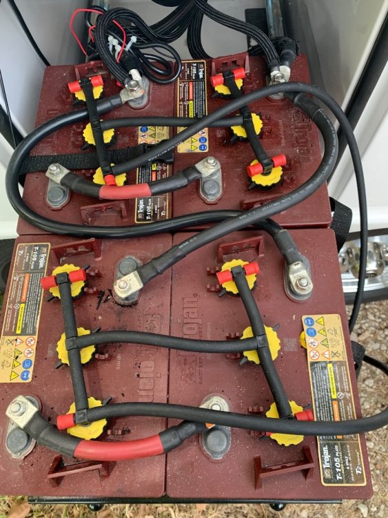

Cort Posted December 26, 2023 Author Posted December 26, 2023 Thanks Chris, We have 4 wet-cell batteries. I'm not sure about the wiring - it looks kind of convoluted to me. I'll take a picture. We do want to go to lithium at some point. We have the Zampp controller which does have a lithium setting but are not sure about any other changes that are needed. 2023 Chevrolet Express 4x4 - 2019 Oliver Legacy Elite II - Hull 529 - Roaming the Western US with Skye (my dog) (and at times my Canadian partner).
Cort Posted December 26, 2023 Author Posted December 26, 2023 I added the image....The batteries - which say they are deep cycle marine batteries - appear to be in parallel but there are these extra cables that I don't understand. With the power gone the heat is not working - darn... 2023 Chevrolet Express 4x4 - 2019 Oliver Legacy Elite II - Hull 529 - Roaming the Western US with Skye (my dog) (and at times my Canadian partner).
ChrisMI Posted December 26, 2023 Posted December 26, 2023 Looks like 4 12v batteries wired in parallel. If you know which battery is bad remove it and continue on. With the batteries over 4 years old and if you are not sure of the history I would replace them all with a couple lithium units or new wet cell batteries if you want to keep things the same. 3 2

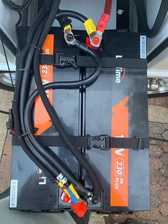

Ronbrink Posted December 27, 2023 Posted December 27, 2023 14 hours ago, Cort said: I'm not sure about lithium now and am trying to figure out what's required. DO NOT DESPAIR! I went from four aging 6V Trojan T-105s, 248 lbs/225 usable Ah, ….. …..to two lithium LiFePO4, 90 lbs/460 usable Ah, at a cost of less than $1600, to also include a Victron SmartShunt, necessary fuses and a couple new cables. Some of the stock cables were utilized in the swap. 3 Ron and Brooxie | Clear Lake (Houston), Texas 2020 OLEll, Twin, 579: No installed solar, dual 30# propane tanks w/GasStop safety devices, Renogy 40A DC-DC charger, 460Ah LFP battery bank/Victron SmartShunt, auxiliary Cerbo-S GX/Victron 30A Blue Smart IP22 Charger combo, interior mounted Hughes Autoformer, twin independent sliding Lagun mount tables, extended dinette table and pantry landing, tongue-mounted hoist, Beech Lane refrigerator Ventilation/Evaporate Coil fans, metal valve stems with TST cap sensors and signal repeater, Waste Master sewer hose management system, Dreiha Atmos 4.4 A/C upgrade/Ceilo Breez Max thermostat, FlagpoleBuddy Starlink Mini suction mount kit. 2019 GMC Savana 2500 Cargo Work Van: Explorer Limited SE, Low-Top 7 Passenger van conversion, 6.0L V8 Vortec, 6-Speed Automatic, RWD; Air-Lift LoadLifter air suspension/WirelessAir compressor; Bilstein B6 4600 Series shocks; metal valve stems for TST tire pressure monitoring system; Buyers Products cargo containment boxes/DC Cargo securement system; rear bumper DC-DC Anderson power cable outlet; 100Ah 12V portable power station/Dometic CFX 75L Dual Zone cooler; front 2” receiver hitch/QuikrStuff Mach2 double bike rack; Mechman 320A high output alternator; Starlink Mini/Veritas Vans magnetic mount.
