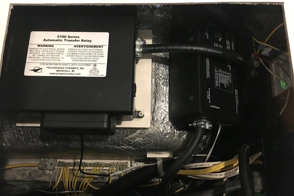

It was certainly after 2016 when OTT made the PD EMS-HW30C standard equipment. You may remember I added one end of last year. You just need to cut the 10/3 cable from the PD5100 ATS to the breaker panel and install in line.
It’s on the upgrade list.  Right now it’s resting just behind the new air conditioner!  Mike
