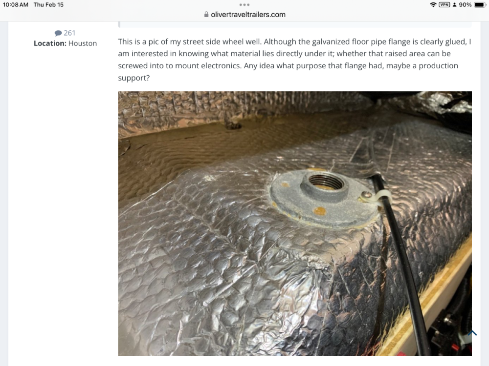

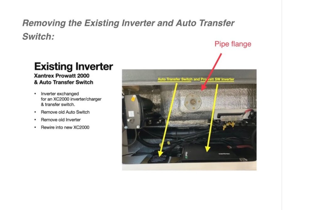

On 1/27/2024 at 11:49 AM, jd1923 said:
@Ronbrink Unless you purchased yours new, somebody must have added that galvanized threaded pipe mount! I can't imagine a purpose for such a large ugly mount in that location.
I was reading Galway Girl's Blog about their DC System upgrade and found another pipe flange installed on the interior top of the SS wheel well.  I still don’t know why it’s there, unless I have missed someone’s response to that question, but Ronbrink's is not a 1 of mystery.
@Ronbrink's picture
@Galway Girl's picture
In the immortal words of Artie Johnson, "Very interesting".
I noticed that, as well. Their 2019 OLEll 505 and my 2020 OLEll 579. I have a feeling ‘we are not alone’!
2020 OLEll, Twin, 579:
LOL!  Come on guys it's obviously the base mount for an "entertainment pole"!
GJ

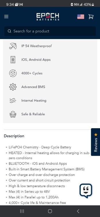

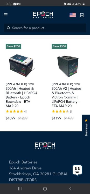

You purchased the model with the Victron comms: 12V 300Ah V2 Heated Bluetooth LiFePO4 Battery - Epoch Essentials (epochbatteries.com) Wondering what that does for you, that adding the Victron SmartShunt would not do? I already have this shunt and their smart Bluetooth dongle for communication purposes.
This Epoch model is also 300AH without the Victron comms but slightly smaller, so thinking it would fit in the OTT OEM battery tray as-is. Are there other features that made you decide on the higher-end and slightly larger model vs. this one? 12V 300Ah Heated & Bluetooth LiFePO4 Battery - Epoch Essentials (epochbatteries.com)
I just read your comment above again. It appears you ordered the smaller model but was supplied the V2 model instead since it was in stock, in time for your trip. Still wondering if the V2 model is worth it considering fit. Other V2 benefits?
Edited by jd1923
Added last para

JD - I just read your comment above again. It appears you ordered the smaller model but was supplied the V2 model instead since it was in stock, in time for your trip. Still wondering if the V2 model is worth it considering fit. Other V2 benefits?
Hey JD ... yeah, woulda preferred the original basic model as it would have been an easier fit in the existing tray ... but with our travel plans I couldn't afford the delivery delay(s) (now expected in late March) ... and since the V2's were offered at no add'l cost I decided to go for it. Add'l features/benefits? ... mmm, I think the Victron and/or CANbus ports would definitely be worth it for anyone who already has (or is planning for) those components. The heavy steel casing seems very strong and substantial, but I'm not sure that created any additional value for me - that would not have been a deciding factor for me. One add'l note - each of the units has its own shutoff switch built into the top of the case (right near the red negative post in my pics) ... so, eliminates the need for a master battery shutoff ... thought that was a real nice feature .  I believe the lesser model comes with a "remote shutoff" - also nice, but would require additional holes to be drilled and wiring the installation for them ... I actually prefer them right on the unit as on the V2's.
