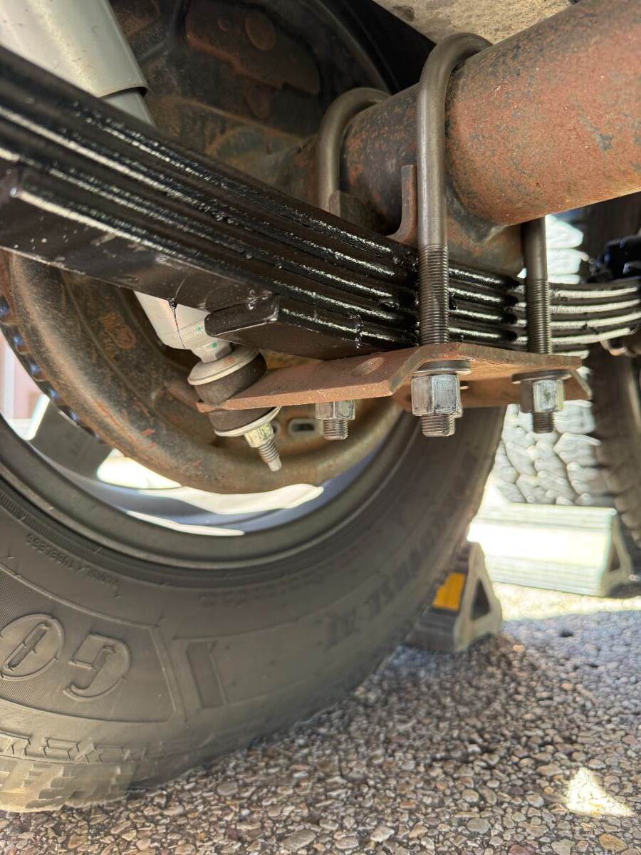

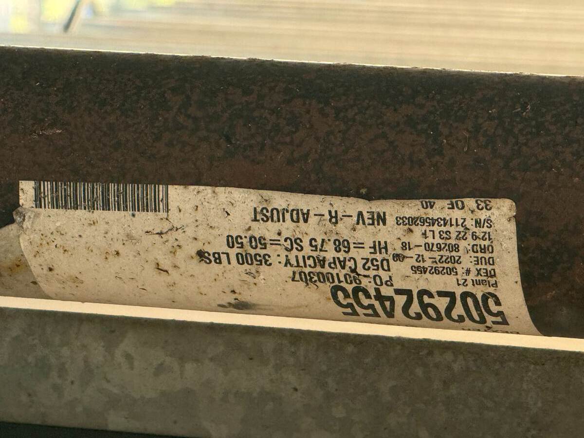

  2. Test completed. All wheels turned silently, except the curb rear wheel. On that wheel forward rotation is silent, rear rotation (as in backing up the trailer) generates a dragging squeaking noise from the wheel. Performed this test on all four wheels, including the curb rear indicated above. No movement, and I gave it my best linebacker effort. Did not perform this test given that I had isolated it in the first test. @jd1923 based on my understanding of your troubleshooting matrix, this is pointing towards bearings. I did get a photo of the label on the rear axle and included it below. (I also took a shot of the bulldog shock attachments while I was down there. Thoughts? It looks like they were reinstalled a bit tighter than I had them originally. May pull and replace with new rubber bumpers when we get home. Given that we are second owners on Hull 1364, should I contact Dexter or Oliver about the potential warranty claim? Or am I out of luck on the axle waranty?
