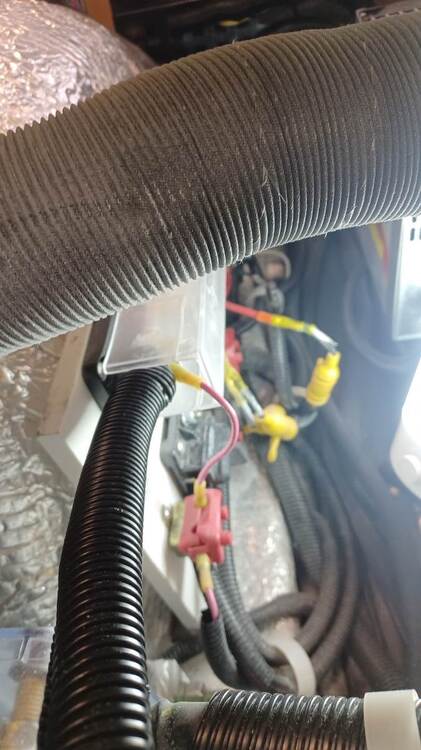

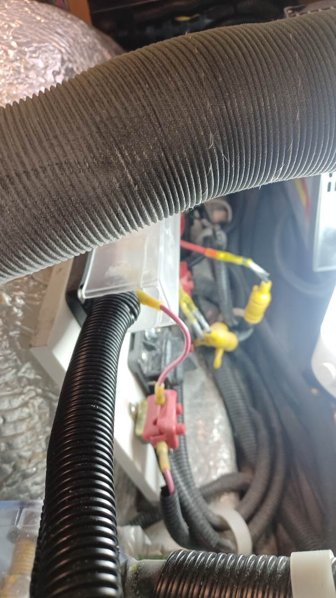

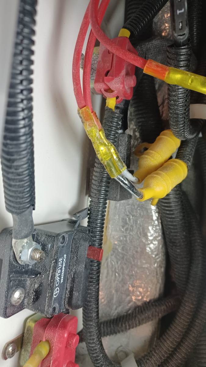

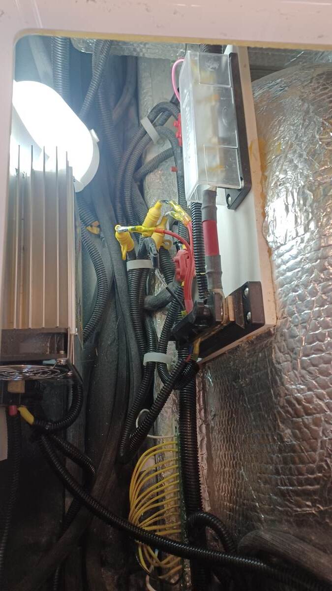

Under the red tab on the black breaker box is a little swing arm that needs to be pushed back up into the breaker to make a complete circut. I couldn't get my camera under the breaker to take a pic. -

Check the connections going into the back of the DC panel under the rear dinette seat. I had a similar problem and found a spade connector loose. A little crimp for a tighter fit of the red power wire was the solution.
