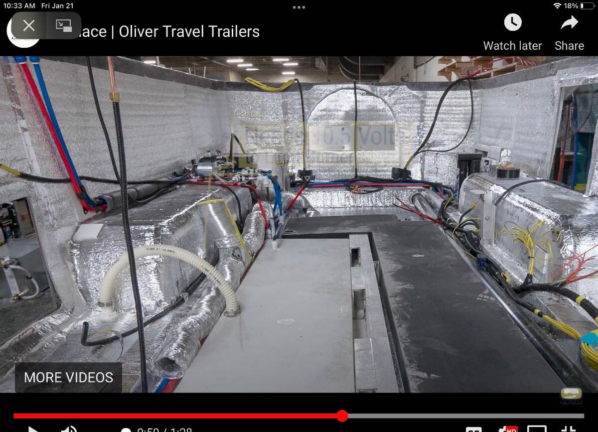

Agreed, a screen insert makes sense to keep insects out. Filter material, why? It does look like a filter, but there's no need to filter waste water! The finer the screen or filter material, the quicker it will muck up, and eventually be closed shut. Thanks for the picture! I suggested the scope and now I need to get one! The screen/mesh looks somewhat clogged up. Who knows what has collected above it in your 5 years, our 11 years? Hull #1291 has at most 4 years of use! Could be one of those hole-saw plugs from the tank installation stuck along the path. It irks me how lazy "professional installers" can be. With the right tool it would take a few seconds to retrieve the plugs and a blast of compressed air to quickly clean out the new tank. Fill the tank more slowly? Filling up at Maverick on our last trip, It took over 10 minutes to fill the tank (28 gal on the counter) and the hose had a very good flow rate. Because it's so slow, I now start filling the fresh tank and dump tanks while it's taking its time filling. For me the 1/2" PEX plus the OEM restrictor makes the incoming water flow slow enough. I'll be checking and likely removing this "filter" instead. On my long list is also removing the Fresh and City Water line restrictors (they restrict flow vs. pressure). Everybody in every RV forever has run the hose until the tank overflows. Camping is supposed to be fun! 🤣 Is the "plastic flanged bulkhead fitting" removable, so serviceable? The screen is relatively close to the bottom, so there's hope. Given @Rivernerd's experience, I would certainly try to remove that fitting and see if the screen/filter is serviceable. If not, I would take long auger drill bit and turn it by hand slowly into the screen, trying to grab as much of it as possible for removal. Try to remove as much as possible with the bit, wider bits and other tools. Then use the scope again to see if it's clear all the way up and down into the tank. Finally, take a piece of stainless steel screening material, shape it into a cone and insert it at the very bottom. This screen insert could be removed later easily with a needle-nose pliers. It will be interesting to find out the end result here. I imagine a lot of us will be looking up that overflow tube soon enough! -

Well I just crawled under there to get a better understanding of the drain port. Ours is in the form of a plastic flanged bulkhead fitting that appears to extend about four inches up through the bottom hull just off the aft corner of the fridge compartment. It’s ID is about 3/4 inch and upon shining a light up inside, there is a fine mesh screen at the upper end and it appears to have a black fiberish filter material on top of the screen. There’s board dividing the fridge compartment from the galley drawer space, so no access to the drain from the outside fridge access panel. My guess is the mesh and what appears to be a filter material are there to prevent anything from getting into the freshwater tank through the drain. But this also would restrict the flow of water during the filling process. Sounds like there’s a few questions for Oliver service to better understand the principle of design and of course what to do if this filter/mesh becomes clogged over time. -

High pressure could cause enough turbulence to splash water up to the overflow tube creating gurgling and an air lock. An air lock can effectively block the vent tube. It's not uncommon, even with large industrial tanks! It's also possible that floating debris blocked the overflow tube as the tank filled, then it floated away afterwards. This is intermittent and it's happened with hole-saw plugs that were left in the tank during fabrication. I've always instinctively filled the freshwater tank very slowly, just a crack of the valve. The overflow tube is no match for my hose pressure and volume, and the tank is not designed to be pressurized. -

Is this true Chris? When I rush to turn the water off, it appears to have the same volume of the hose filling it. Of course I'm not measuring GPM, but... OTT uses 1/2" PEX coming in with a restrictor to boot. The overflow is not PEX but a flex tube. Except for Bill's pic above, I have not see the top of the fresh water tank nor the overflow tube since we do not have inspection plates under the drawers. I just put a screen in the end of our overflow outlet, based on input from a recent post. Before adding the screen, I could fit my index finger inside the overflow to the full length of my finger. No way my finger fits inside 1/2" PEX (mechanics arthritis on every knuckle)! The overflow is likely a 3/4" ID tube. Back to @Rivernerd's issue => The tank held pressure long enough to use the kitchen faucet to release the pressure and relax the flooring. The overflow must have a significant flow restriction causing enough pressure to balloon the tank, somehow also allowing some water escaping. -

Edit: @Steve and MA was quicker on the keyboard than me but I will leave additional thoughts below. I've always monitored the fresh overflow and fill rate closely when filling and flushing the fresh tank. I make sure my fill rate is very slow as the overflow is nowhere near large enough to accommodate a high fill rate. As soon as water starts sputtering out the overflow I shut the supply off. If I want to flush the system for and extended period, I reduce the flow to a fast trickle and monitor while working around the trailer. The holding tanks are not pressure rated, and even at a relatively low supply pressure such as 25psi, a fill rate say 10% faster than the overflow rate would slowly "inflate" the holding tank. It all depends on the overflow capacity to keep up the the fill rate. A strong stream at the overflow in my mind indicates a pressurized system and needs to be shut down immediately. Related to jd's comment above, I just happened to purchase a smart phone borescope earlier this morning on Amazon for other reasons, but realize it will be perfect for inspecting various concealed and hard to reach spaces on the Oliver. This may be just the tool for @Rivernerd to purchase for his evaluation, and keep onboard for future inspection needs. https://a.co/d/00rWQwkn -

That begs a question. What's the internal diameter of the overflow tube? If it's equal to, or larger than, the shoreline hose and the plumbing leading to the tank, wouldn't they have the same flow rate? -
