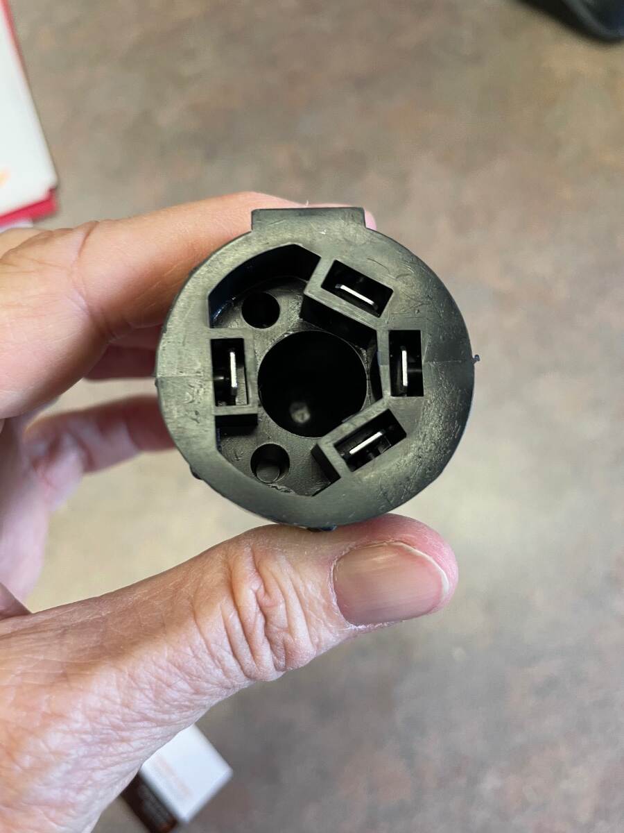

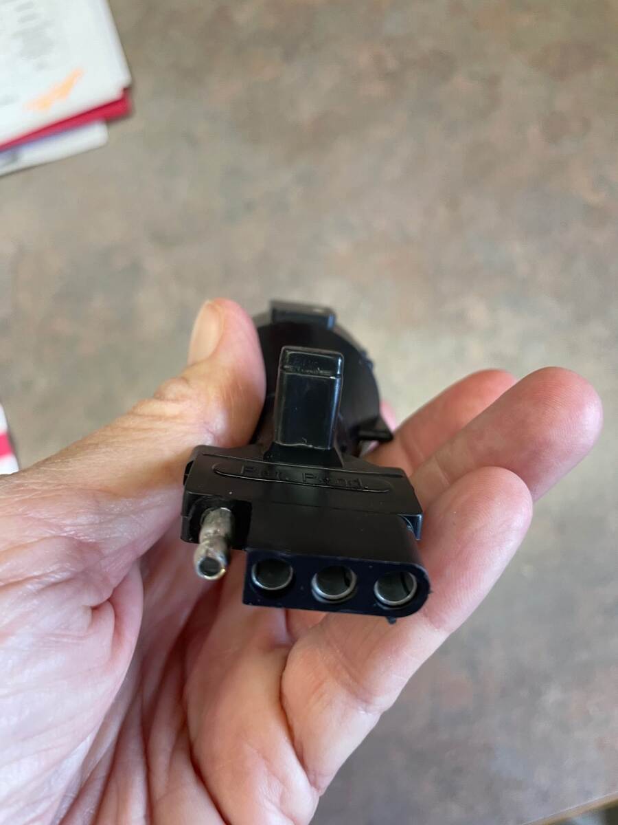

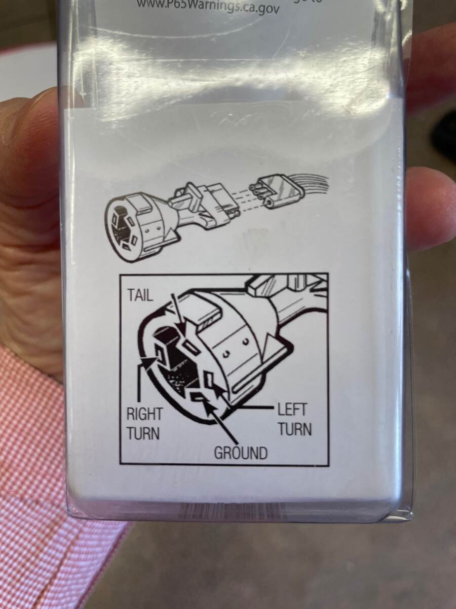

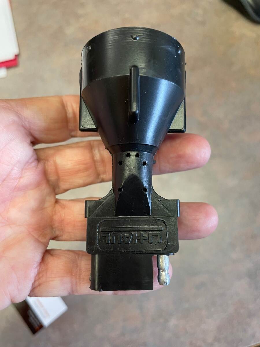

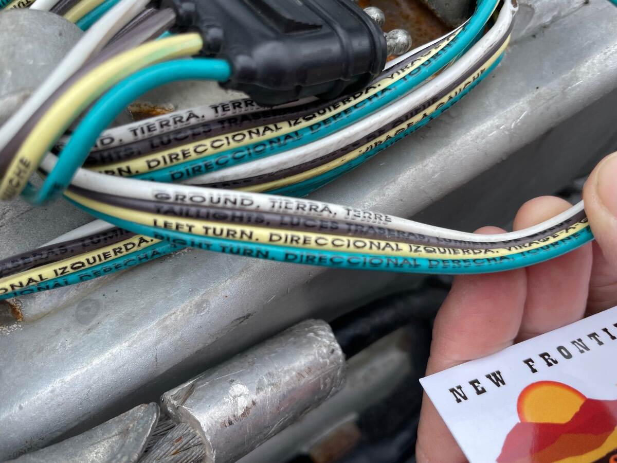

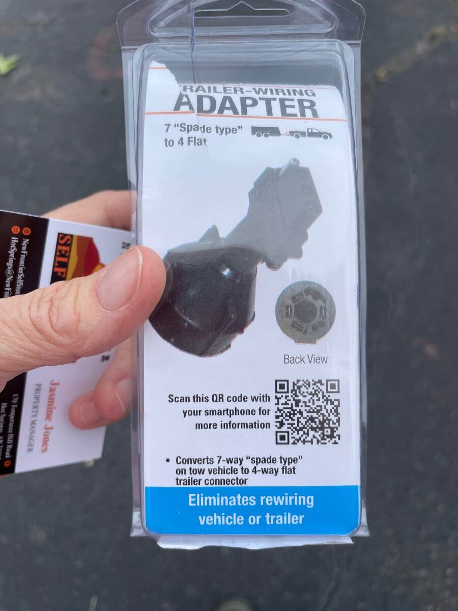

Excellent - You'll know more tomorrow! Not sure if we should be routing for the error to show with the U-Haul trailer or not! If it shows, then the issue is with your truck, and 4 GM dealers already couldn't figure it out. If you do not get a trailer error, make sure you give it a fair test. Pull it out, down the road. Turn your truck on and off several time. Pull the 7-blade plug in and out a few times. Still no error? Then we must conclude wiring on the Oliver side is bad.
Doesn't matter. Your mechanic thought this was the correct junction box and all the right colors are there for a trailer wire harness. This is referring to my comment on the black wire. The black provides constant 12V positive. In a cargo trailer that has no batteries it's used to power interior lights from the TV battery. In the Oliver and perhaps other travel trailers it uses the truck batteries to charge the house batteries. OTT disconnects it when installing LiFePO4 batteries. I believe it's a dumb and perhaps dangerous practice since a light gauge wire should never be used for this purpose. Anyway, this is not your issue. The only thing that connects power from your TV brake controller to your TT brakes is the blue wire. Just check to see if the blue wire connection tight. No, the Amazon link you provided has both male and female ends, its listyed as an extension cord. If you want to replace the male end, head only, get something like this. If the issue is at the truck to trailer connection only then this is the easiest route. Only takes an hour to replace this, Amazon.com: MECMO RV 7 Pin Trailer Plug Splice-in Replacement Trailer Side Male End 7 Way Round RV-Style Trailer Light Wiring Harness Connector, Heavy Duty 7 Prong Trailer Wiring Tow Plug for RV Boat Trailer : Automotive I like the idea of this one since it has a waterproof cable gland built into it, but it would be too long to fit on my truck. Amazon.com: Oyviny RV 7 Pin Trailer Plug with IP68 Waterproof Seal, Detachable 7 Way Round RV-Style Trailer Side Connector 7 Point Trailer Wiring Plug : Automotive If you need to replace the entire cable from the male 7-blade connector all the way back to your junction box under the vanity, you need something like this: Amazon.com: CheeMuii 7 Way Trailer Cord Heavy Duty 8 FT Trailer Wiring Harness Kit 7 Pin Trailer Plug Inline Wire Harness Cable for Trailers RVs Campers : Automotive Amazon links are to show examples. I'm not suggested these products specifically. No way you need a GM part and the picture of a part description you showed above is a combo 7-pin and 4-pin unit (4-pin for little trailers without brakes). You asked RE the clamp ammeter? I purchased a more expensive Klein product, their rugged version, but any will do just as long as it reads AC/DC, for the 120VAC systems and 12VDC systems we have on the Oliver. This one looks decent. Amazon.com: Klein Tools CL120 Digital Clamp Meter, Auto-Ranging 400 Amp AC, AC/DC Voltage, Resistance, Continuity, Non-Contact Voltage Tester Detection : Industrial & Scientific
