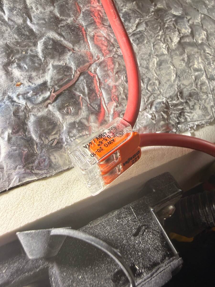

i think i checked all the fuses on the 12V line and they appear good but there is this connector on both the positive and negative wires coming from the batteries to the fuses and i wonder if they are open circuit. I have never seen this type of component before. is it a connector or fuse or what but it goes to the fuses where i cannot get any voltage reading of any kind even though the fuses test good what is this type of connector for?

There must be a direct positive (+) battery connection to the Optifuse. Geoff ask you to retest, but when you're certain there is no power on the battery side of the breaker (or both sides) then the +battery cable feeding the Optifuse is either 1) disconnected, 2) switched OFF or 3) has an added inline fuse that is blown. You must have an open circuit for there ot be no power on "either side of the optifuse." OTT in their OEM build did NOT add a switch or redundant inline fuse in this circuit. The Optifuse is the breaker that protects your batteries from shorts in ALL DC lighting and appliances (all DC loads). If you have anything but a solid stretch of 6 or 4 AWG between the Optifuse and your batteries it must be an aftermarket installation, perhaps something was added during April 2025 when you had LiTime batteries installed. Your solution is simple. Just follow the battery cable from the Optifuse to the batteries. Given your Optifuse is under the streetside bed, the cable will run a whole 5 ft total, first under the pantry area, then up through a drilled hole/grommet into the battery bay, then connected to a positive battery terminal. Your "Tech" could have added a +bus somewhere interior, if so test for +13V there. But if the retest shows +13V on the battery side, but NOT on the load side of the Optifuse, then replace the Optifuse with a 60A ANL Fuse. There are no other possible causes for the full loss of DC power in the Oliver. You either have an open circuit in the battery cable or a bad Optifuse breaker.

I'm a little confused because you've said there is no power on either side of the optifuse, but you've also said that it tests good? Also, you mention a 2000 watt inverter, where you talked about a converter before. These are different things and wired differently. BTW, a 2000 watt inverter should have another ~200 amp breaker or fuse between the inverter and battery. That's not the problem, but you should be aware of it. Mine is mounted on the vertical wall above the inverter. At any rate, the battery and/or the inverter both feed the 12 volt panel (and jacks) via the 60 amp optifuse breaker. Re-check it for 12v from each terminal to ground. There are grounds all over the place in that area, the jack post, trailer frame, or the inverter chassis will work. If there is voltage on the line side, but no voltage on the load side, then you have a bad breaker. These breakers are readily available, and the failure rate is pretty low for the millions of them out there.

i got back home fine and with a voltmeter i did some more checking and there is 13V coming out of the batteries, I checked but thereās no 12 V on either size side of the optifuse. The fuse is good as i checked with ohmmeter. There is a one amp in line fuse I also checked itās good also. the 2000 inverter is turning on fine and turning on the microwave and all the stuff that runs off the AC so itās puzzling why there is no 12V DC power in the trailer. there has to be a bad fuse or switch somewhere. I am going to try to reach out to OTT but it usually takes them a while to get back to me. any other ideas? could a fuse be blown in the inverter.
