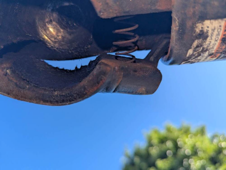

Trailer Separation from Tow Vehicle
Geronimo John replied to John Dorrer's topic in General Discussion
First, I would suggest a serious de-greasing: So much gunk in any hitch can cause it to stick when hooking up. GJ -
