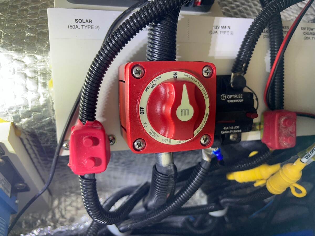

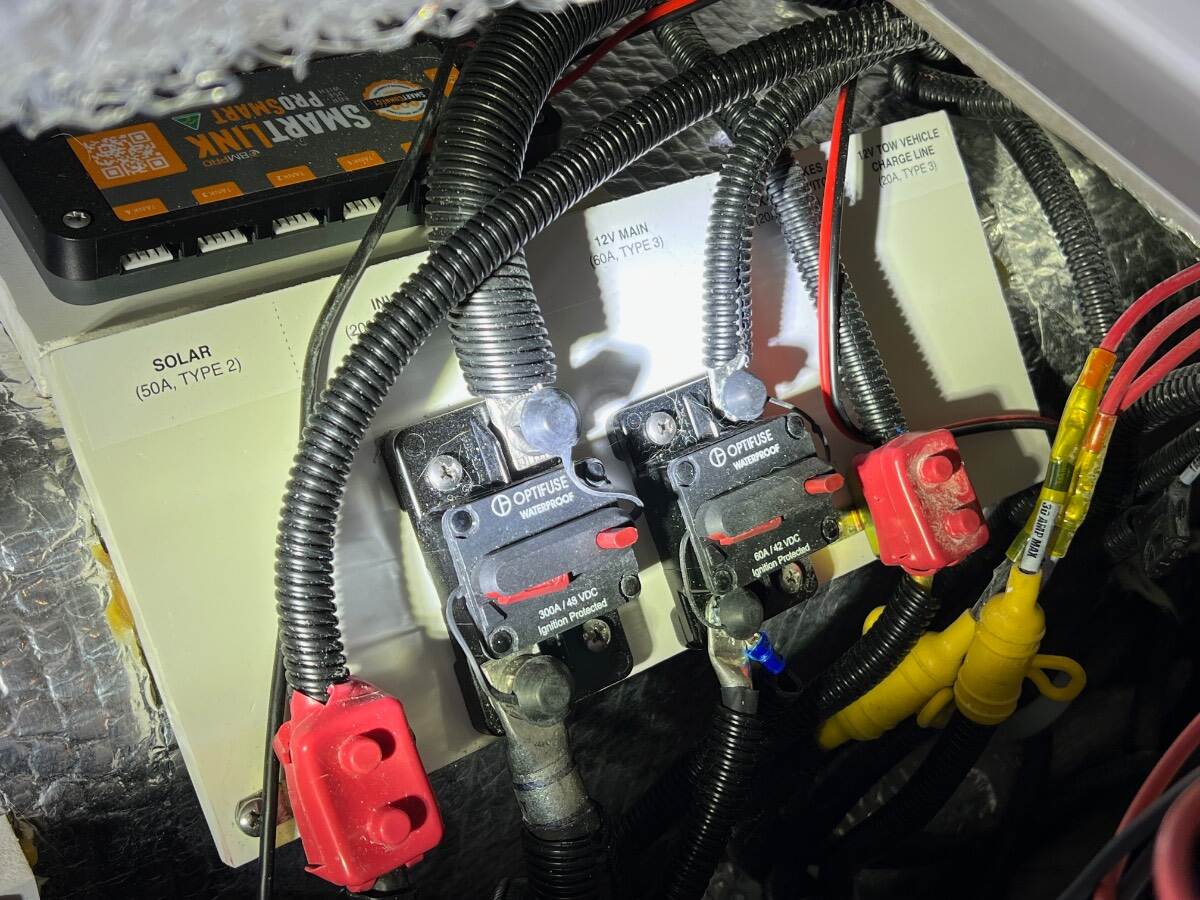

  2. I'm not sure how the 2021 trailers are configured for power, mine is a 2023, but if you have an Optifuse circuit breaker on the input side feeding the Xantrex the Optifuse may be dropping some of the voltage. Mine was problematic, the symptom was a low indicated voltage at the Xantrex and when I would run high current devices such as the microwave the Xantrex would shut down. The solution for me was to replace the Optifuse with a marine switch. I would give Oliver a call and they can help to zero in on the issue.
  3. The readings are as follows: IMG_1306.mov
  4. The voltage directly from the batteries with my multi tester is reading 12.7 V. My Inverter is on. My 3 way refrigerator is not turned on and is therefore not drawing any power. My maxi fan is running on a slow setting. The solar Xantrex controller is showing that I have the 11.7V right now, and is indicating that solar is sending current into the unit. They are new batteries. You see, I’m preparing for our next camping trip this coming Thursday. Does any of this make sense? Charlie
  5. What is the voltage measured directly on the battery terminals with a DVM?
  6. I have AGM batteries that test with my multi tester as having full power. However, the Xantrex indicates “dead batteries”, even though the voltage reading on it says 11.7V. It seems to indicate that the Xantrex is not reading the batteries correctly.
