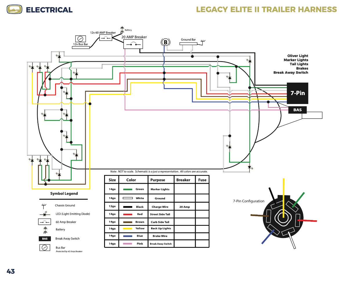

The breakaway switch connects the blue wires and the pink wire through a 20amp resetting breaker (under the street side rear bench cover). This means it's most likely on the 7 pin connector either on the trailer or on the truck side. CS -
I have a Mobile RV service coming 8-7-2025. They use a 'Wire Trace Box' they plug into the RV Plug Wiring on the Oliver. Thanks Steph and Dud B for the color plug wiring diagram. I made a copy to put with our Oliver 'suitcase' of manuals. Nothing in the manuals cover trouble shooting, that I am aware of. I will ask the service worker if this issue left the Oliver Factory like this, or something that happened afterwards. I understand mechanical fixes rebuilding auto engines and replacing parts... but not electrical. Will know... I hope then. This should not happen to any owner.

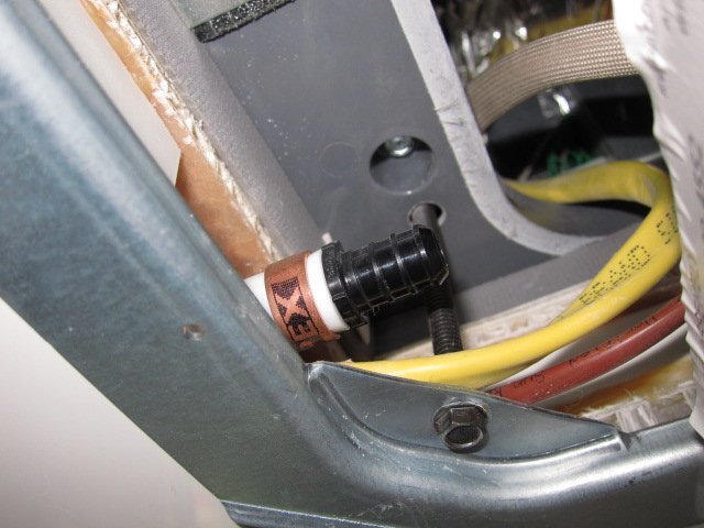

Thanks @mossemi. I did confirm that they are the solar wires. I did not know that the connector was a automatic resetting breaker. @Galway Girl. I was told by OTT that the red wire with the 1 amp fuse goes to my composting toilet fan. I believe that the propane/leak detector wire (which is likely in the corrugated wire guard) is connected to the red device with the two buttoms. I will be verifying this later today. Thanks

I've seen LED trailer lights work correctly getting their ground through just the hitch coupling alone but then the trailer brakes work intermittently or not at all. Happened to me a few years back with my boat trailer. Still think a missing ground is at the bottom of the list in this situation though... If it were mine, I'd hit both connectors with some DeoxIT before I even broke out the multimeter. -
That makes sense, it needs to complete the circuit. However if the ground connection from the truck was faulty, I'd expect @BoondockingAirstream to have other problems, like intermittent running lights, too. With him reporting the breakaway system working properly it seems most of the trailer brake wiring is intact.

I tend to agree, and venture to say likely a bad ‘blue’ wire connection either at the male 7-pin connector or downstream on the Oliver. The OP has no issue with other trailers being pulled by his F350 and thus, don’t think the vintage of the TV or inherent factory installed equipment issues are of concern. -

I think that is a picture of an automatic resetting breaker in the B+ path from the solar charge controller. Both the red/black and the solid black should run up the the wall to the Solar CC. The red/black wire eventually goes to the battery positive/B+ and the black wire ends up at the battery negative/B-. They are zip cord wires just like a lamp cord, so you can verify my thoughts by determining if the insulation is in fact joined together as it heads up the wall under the SS bed. I’m pretty sure they will be 8AWG wire. Mossey

That trailer ground works for the breakaway switch since the battery in the trailer powers it, but to complete the brake circuit from the truck you must have a good ground from the truck to the trailer too -
The brakes are grounded to the trailer frame, not through the truck connector. This is so they will still work via the breakaway switch without the truck. That makes the blue wire from the truck the likely suspect, since the breakaway does still activate the brakes. My money is still on the connector itself.
