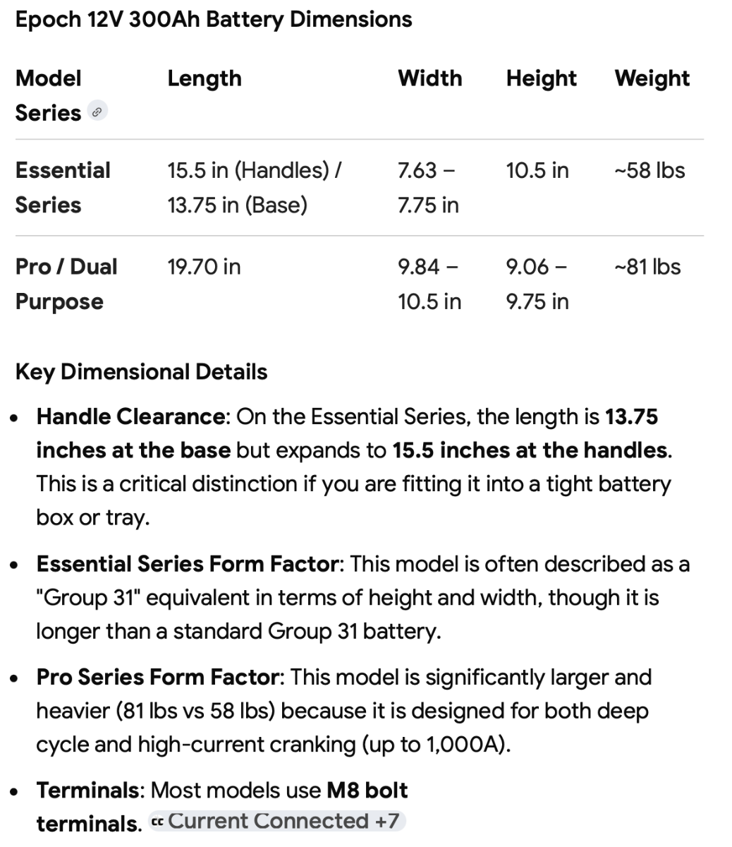

Not sure of the full dimensions of your space in LE1 but you may want to check out some of the 300AH mini batteries like this one from Renogy. Renogy 300AH Mini Core They claim a much smaller footprint ...but be aware,,,this model doesn't have self heating for cold temp charging, but they do have low and high temp cutoffs for protection. List prices are currently $879 direct. Here are Epoch Dimensions Just an idea of others: - Today

Thanks JD! To answer a couple of your questions, our LE I has a battery tray that has two 130AH lithionics batteries. They are 12.5” x 6.5” x 8.5” (L x W x H) with about an inch to spare. Without having the it in front of me, I think the tray is roughly 14 deep x 13 wide. Not a lot of room. Here's a pic I took a while back. It looks like the LiFePO4 (looking at the 460AH) dimensions are L20.55*W9.45*H8.58 so I will have to see if there is any wiggle room with the tray removed. I'll take a look at some of the specs on the other Li Time options. If I can't find a good fit, maybe a 400W suitcase panel plus the DC-DC charging will get us by until we find an option with the right footprint.

I agree with Mike's comments. BTW he and many others installed two 300 Ah Epoch Essentials batteries. I did that too in 2024 and Jan of this year added a 3rd for 900 Ah! If you provide measurements of your battery bay, we could see what would fit. Don't know for the Elite 1. Also, are you willing to lose the tray? In the E2, 600 Ah fits in the tray and when I went to 3 batteries, I removed the tray and will not miss it since LiFePO4 does not require maintenance. The tray was meant for servicing LA batteries! Would a second Lithionics 260 fit? We think alike here! After all the work I've done in upgrades, we will not conserve! We're now running our Chill Cube A/C on battery! And I would be embarrassed to fire up a generator, never have and never will, and with technology today there's no need to! 😎 We added a 400W Renogy solar suitcase which we use rarely. It does produce 2x our 320W rooftop solar since you get a better angle in the winter sun. These panels are heavy and LARGE! It sits fine in our 8' truck bed, but you would hardly have the space. They're also a pain to move around all day, keeping them pointing to the sun. I remember reading that you (again like us) only stay a few days at each location. Our DC2DC charger is the best tool we have! My take is your best first step is #2 in your list. You need to double your 260 Ah batteries, or better yet, install 600! Page one of my post shows the 600 Ah upgrade and on page 2 upgrading again to 900. Let us know the dimensions of your battery bay so we can make suggestions. 😂
