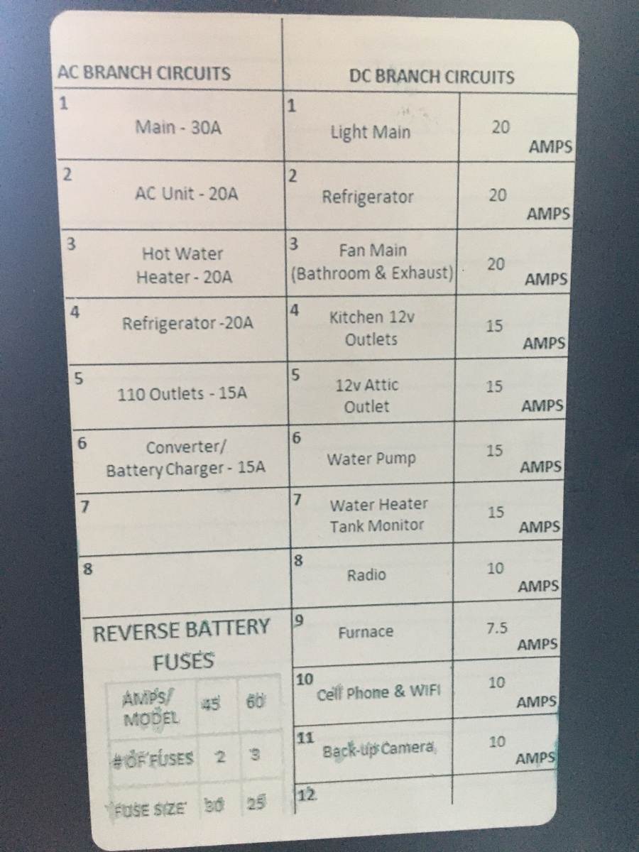

I believe you hit on it here! New issue often comes from last service. I can't believe you were there and OTT Service would not fix an issue they likely created in your scheduled service one business day before! They tried a "new monitor panel." Did they first check the fuse? You have a hull a little older than ours but maybe this circuit is wired the same. Our DC panel has a fuse titled "Water Heater Tank Monitor." Perhaps we're getting closer now! š This 15A fuse might be blown. If so, your HWH would not have 12V to fire up on LP. If you have hot water, I'll bet they pick up 12V from the HWH wiring and if so, there would be an inline fuse between there and the SeeLevel system. It's really bad electrical practice to wire inline fuses at random locations in the basement! RV manufacturers do this often and when I find fuses around the Oliver basement, I move them to a new +bus I wired under the rear dinette seat, so I know where they are, have easy access and never have to reach down under again! Look around for an inline fuse, starting at the HWH then going towards the tank readers or the SeeLevel panel. Hope you find it quickly!

Is there power to the unit? Does your water pump switch / indicator work? I would check everywhere a service person may have worked to see if there are any pinched, broken, or unplugged wires. Are any other devices not working, check fuses, etc.. -

Our tank monitor is not giving any readings, including battery level. Just wondering if this has happened to anyone else. Some background info, we were in for service at the end of April and the tanks read prior to the service. One service issue was a replacement water heater and Iām wondering if something got knocked loose somewhere between hulls. Unfortunately for us our pickup from Service was on a Friday close to closing time and they couldnāt get out fast enough so we didnāt find the problem until later in the day. We were able to stop in on Monday afternoon and one of the service techs took a look at it and even tried a new monitor panel, but no success. The tech did mention a possible pulled wire somewhere but they didnāt have the time in their schedule that day to find a fix. If thereās an easy fix/solution weād like to try that before we haul it down to Hohenwald.

Under the red tab on the black breaker box is a little swing arm that needs to be pushed back up into the breaker to make a complete circut. I couldn't get my camera under the breaker to take a pic. -
