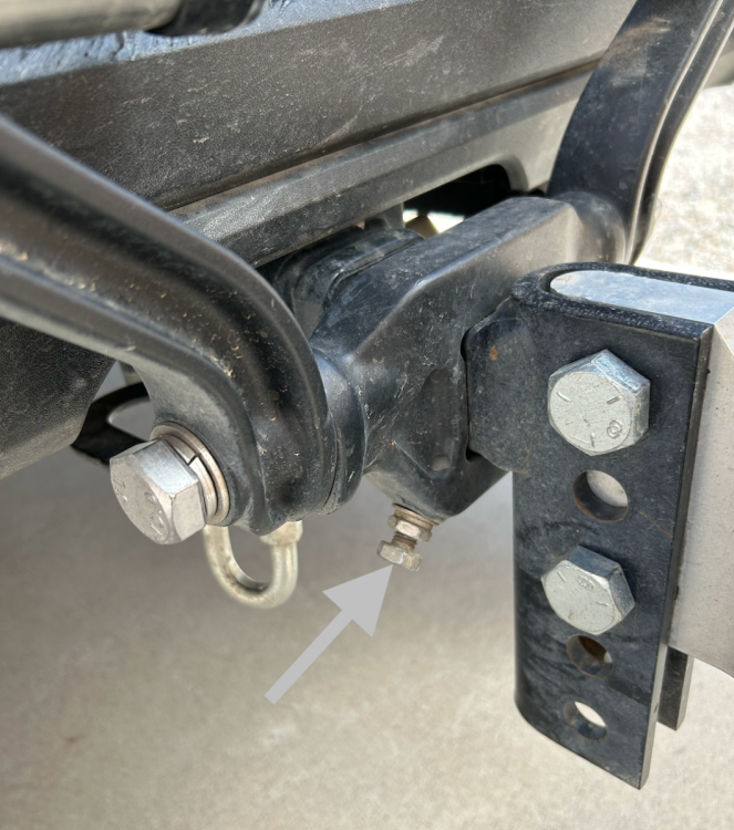

@Geronimo John - John: here's the link to the item in question, FYI: https://www.hitchrider.com/nowobble.htm Don't think there's enough room in the housing of the vice to enlarge the bolts... Don't have it physically in front of me ATM.
So there's two tightening bolts on either lower side of the mounting assy (the arrow's pointing to the STBD side bolt). The bolts are "double nutted" (w/washer and lock-washer) to the assy. which keeps it tight on the shank. The "looseness" we experience is the hitch shank/receiver connection when not towing. Once there's tongue weight on the system everything is "ROCK" (pun intended) solid - provided those 2 tightening bolts are torqued down. We've got a "Hitch Vice" in the shop with bent bolts from the AS days - once I get my hands on it, I'll take @topgun2's advice and fix it with a couple grade 8's...
