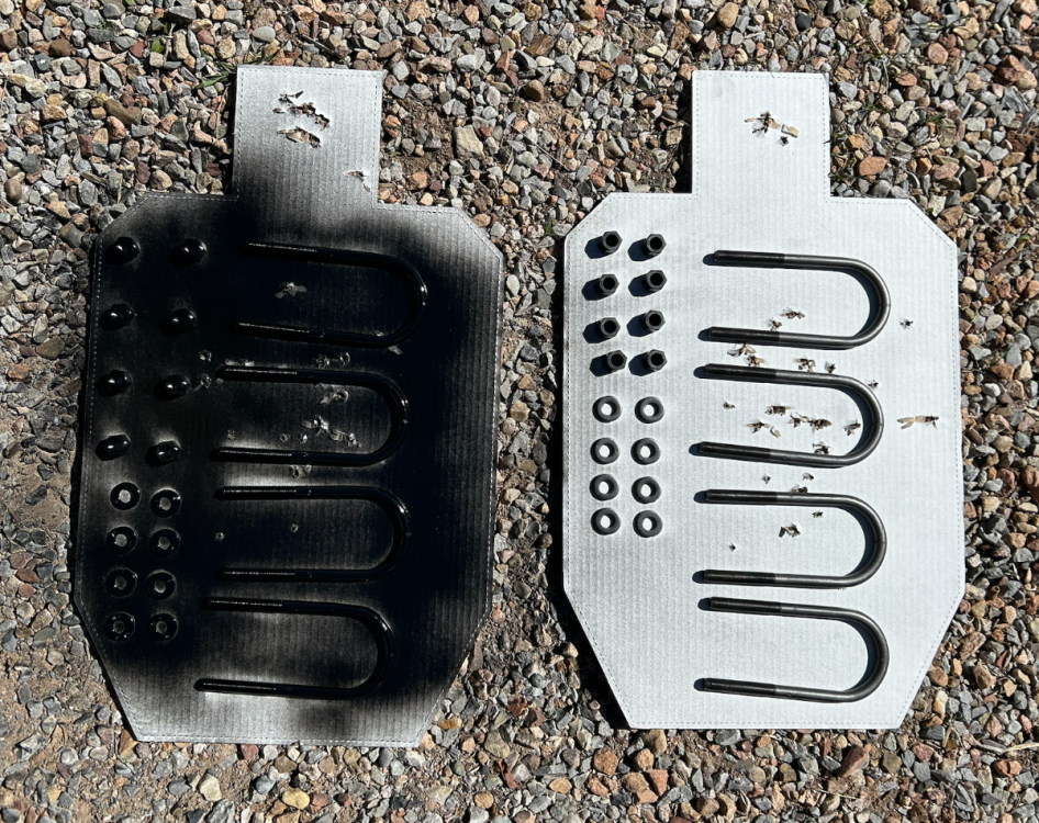

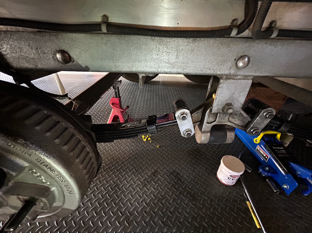

Yeah, same here. Apparently Dexter manufactured 3,500lb axles with 2-3/8" diameter tubes (newer model) and older ones with 3" tubes. You'll need to let them know which ones you've got so they send the correct U-bolts. Mike at Alcan knows about this information and he'll be sure you're sent the right ones. -

These Alcan's are heavy duty for sure! -

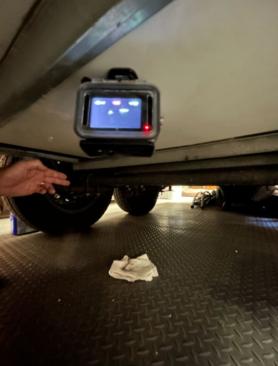

Well we got off to a rather late start - forgot I had a 9am PT session for the rotator cuff repair from a few months back. Anyhow, didn't get the shop opened until 1030-ish. Thinking about JD's old-school suggestion using clay - which seems brilliant, I came up with an alternative. Short of buying an accelerometer from Amazon and obtaining objective data of the suspension system - mounting my GoPro to the undercarriage amidship seemed to be a logical path forward costing $0. We do "cheap" and "free" like champions. So, instead of having D drive around the neighborhood with me in the back playing the "rock and roll rider" - went ahead and captured GoPro video of the curb-side forward wheel assembly while trying to hit every pothole in the area. The thought process is that traveling over the same route at the same speed with the 4-pack springs first, then the 5-pack after the install might show a different deflection of the suspension.... Not 100% objective but comparative for sure. Just need to upload two comparative vids of the before and after... Started off by degreasing and painting the new (one-use) U-bolts, nuts, and washers with a healthy coat of RustOleum to keep things tidy underneath. For the most part, this is a straight forward plug-and-play R&R effort. The new springs are several pounds heavier and definitely a bit higher drop than the Chinese-made 4-packs: So, the street-side springs are successfully replaced with the new 5-packs... The curb-side springs go in tomorrow - then we'll follow-up with a short before/after GoPro ride vid. ...but now, its time for a cold one! Cheers, ALL!- 983 replies

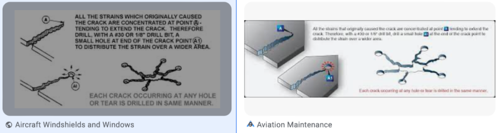

Like mentioned earlier, it looks like the door could have been caught by a wind gust judging by the crack being nearer to the hinges. Short of replacing the inner skin (which is totally doable, we've done one in a previous SOB), suggest finding both ends of the crack (under the window moulding and along hinge line) and "stop drilling" a 1/8" hole there. This process will stop the crack from getting longer. Its a foam-core door, so there shouldn't be any "draft" ambient air penetrating the inside crack from outside. We've got one a couple inches under our window moulding that runs horizontally for about 10". We "stopped drilled" the crack on @ScubaRx's suggestion after he saw it in Quartzsite last JAN. Good luck, cool maintenance/repair opportunity for you, @Steve-Gwenne - let us know how it turns out! Cheers!

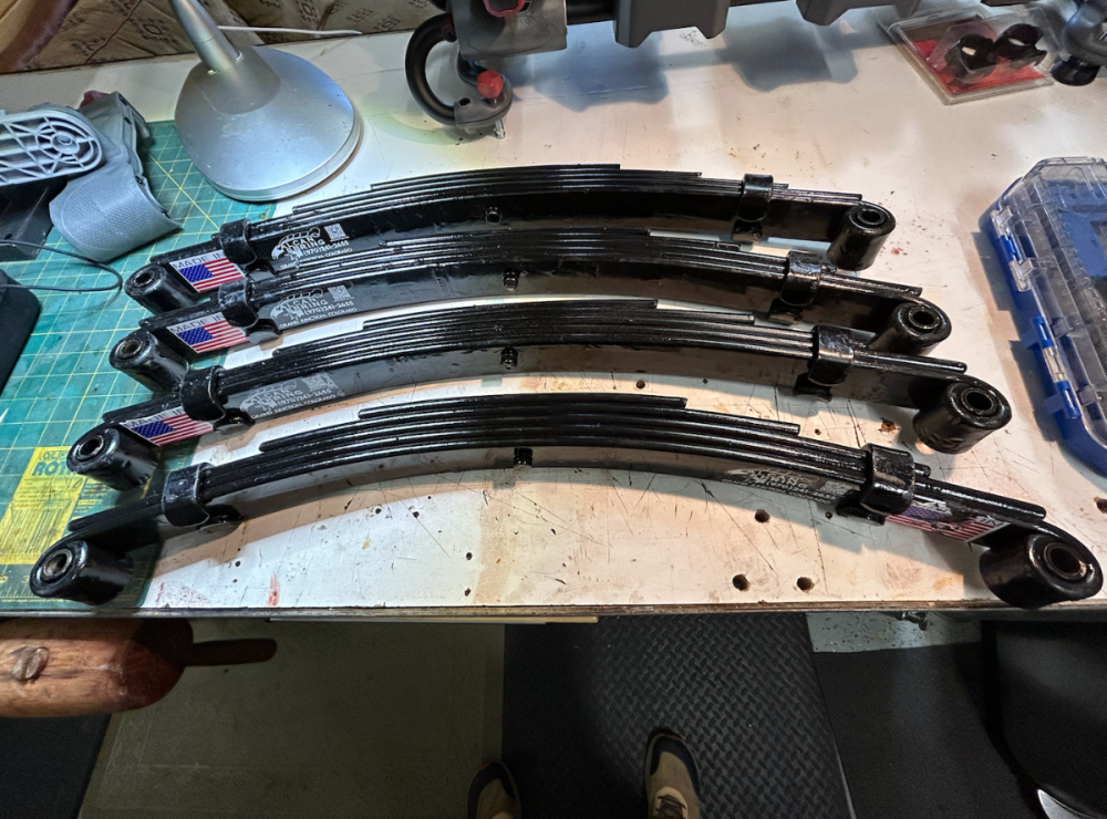

Just FYI: Our Alcan springs arrived this afternoon - just from observation, definitely a big difference in quality between the Chinese-made Dexters and these new ones. Measured eye-to-eye dimension to verify 25.25" across the board w/3" drop - all good there. Planning to have D drive Casablanca around some of the rather "rutty" roads in the neighborhood with me in the back to (hopefully) get a feel for the "before and after" install ride inside. Spring R&R will begin in the AM - we'll for sure keep y'all posted on the effort... Cheers! -
