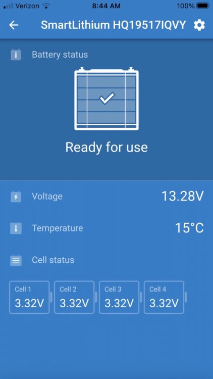

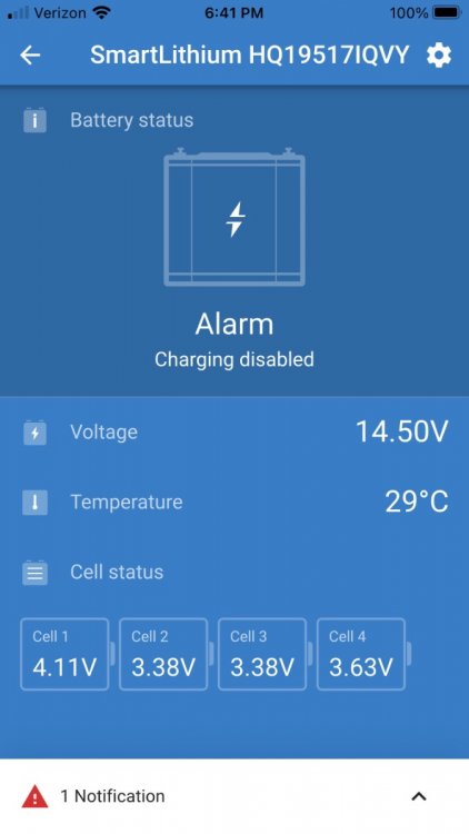

Yes, I have a had separate Victron BMS for a year now. The batteries do indeed shut down the charging by themselves, for example, I had one cell that was over voltage, it simply shut down all charging. When the converter was turned off, the cells in both batteries equalized over a short period of time. The only thing I am concerned about is the BMS cannot actually control the Oliver installed Progressive Dynamics charger (I added the lithium charging section). With a smart (connected) Victon charger, the BMS will turn it on or off, or cycle it, to control this stuff. Unfortunately the biggest smart Victron charger is only 30 amps. I would hate to lose the 45 amps of my present one. I will also be adding a Victron MPPT solar controller, which the BMS will be able to fully control. Over voltage alarm: After turning off the charger. (The second battery cell voltages were almost identical). I think these Victron batteries take a few cycles to “settle down”, in terms of cell balance. They can only compensate for small variations at a time. I have no clue how the other brands deal with it. John Davies Spokane WA -

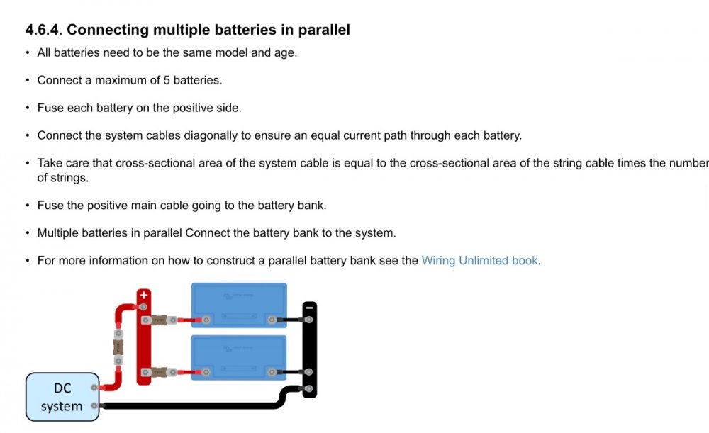

I ran across this diagram from a Victron battery installation manual. I am having a hard time understanding why separate fuses would be desirable if the main line has a suitably rated one. I just hooked up the big 4/0 inverter cables as before, and jumpered the two battery positives and the negatives with short cables. I emailed the vendor that sold me the batteries for advice. Does anybody know if this would be a good idea and why? Does Oliver fuse each battery? I have not yet completed my cable configuration, I may do this, just in case, and mount the two fuses on the sidewall, inside the box with the batteries... and run a separate 00 gauge cable to each battery positive post, with enough length to allow the tray to come out part way. FYI, here is an excellent reference for the Victron batteries. I wish I had found this before I started this project. It is very complete, but it may be intended for more complicated electrical systems like in a yacht. Many of the marine system parts and interconnections are not needed in an RV. https://www.victronenergy.com/upload/documents/Manual-Lithium-Battery-Manual-EN-(P).pdf Thanks for any comments. John Davies Spokane WA
Russell, I am with you on the KISS side of the argument: Keep It Simple Stupid. I even have that as a prominent sticker on my home tool chest..... I wonder how an F150 owner will feel when an out of warranty inverter (or related component) failure rears it’s ugly head? Are these devices user repairable? The most expensive part on your typical Honda EU2000i is the inverter unit, a brand new replacement is $400+, with used ones costing a third of that. Installation takes a few minutes. I would like to see an illustrated parts list with prices and a labor flat rate chart for the Ford, please. There is bound to be some unpleasantness from close neighbors in the campground. I already carry a small dead-blow mallet for pounding stakes into the ground and for mechanical repairs. Maybe I will start carrying a couple of large baking potatoes. One plugging each exhaust tip would do the job I think. Add a little olive oil before installing and it would smell like French fries. 😬 Or maybe a bunch of party horns. .... https://m.youtube.com/watch?v=ht35P7GnvuQ Bah humbug. Stay well. Merry Christmas. John Davies Spokane WA
