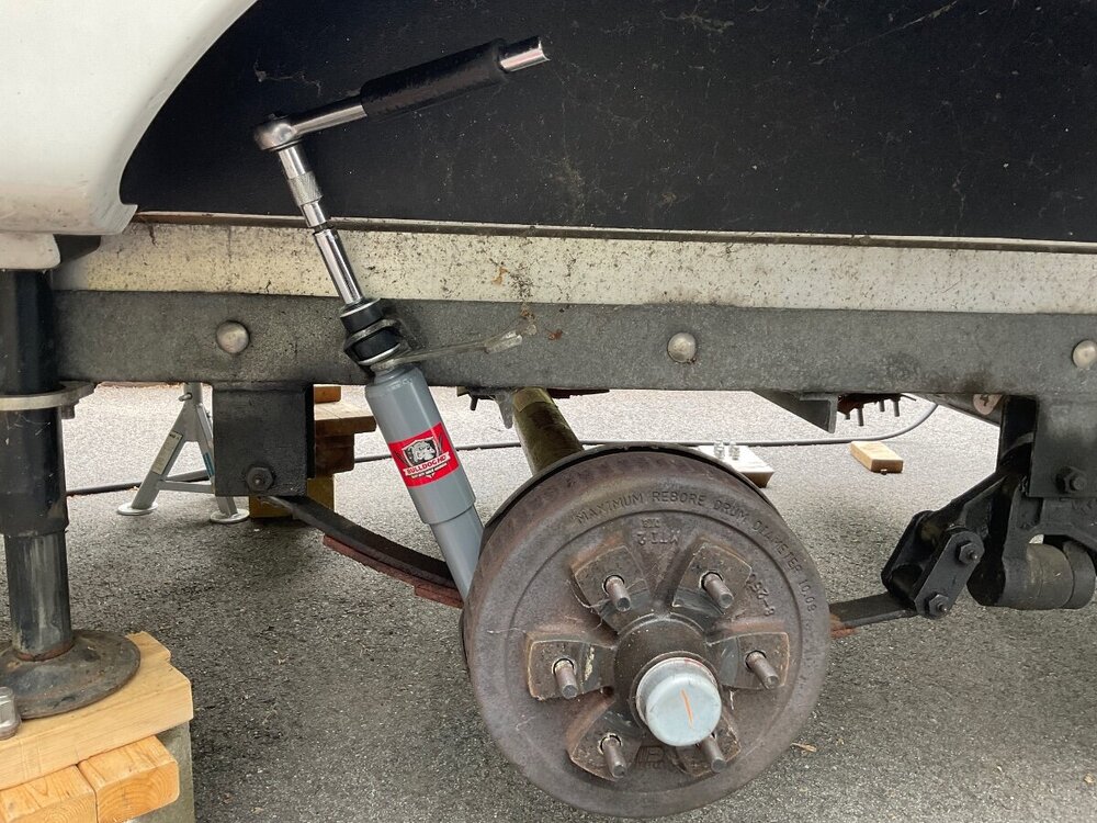

Thanks, Rideadeuce, for the tip on the Bulldogs. Installed 4 of them today, along with new tires (originals going on 8 years old). Tomorrow, repack the bearings.
(note decal facing outward!)
Gotta love the attention to detail.  Good for you.

Well crap as luck would have it just discovered yesterday while working on my Ollie installing new battery I have a broken shock or rather the nut came of the suspension loosing rubber grommets and all and just dangling loose. Must have happened on our recent trip to Colorado National Monument a couple of weeks ago. Have not been able to find anyone with the Bulldogs in stock yet but need to fix this soon.

1 hour ago, routlaw said:
I have a broken shock or rather the nut came off the suspension
To see if the shock is good or bad, manually compress and lengthen the shock and either it will be feel firm the full distance up and back, or if not it is blown.
If it is good, or to get down the road until you can replace the shocks you can get a set like this on Amazon or from ANY auto parts store. You may need to remove the shock or remove the nut from another shock to match the threads for the nut.
https://www.amazon.com/dp/B0DHF93PQF/
BTW, you are better off removing the shock than to have it dangling if you need to tow your trailer. Most trailers do not have shocks and the aren't truly necessary.
@jd1923 luckily we are at home so not a big deal for now. No telling how many miles we ran with this thing dangling coming back from CO. Given the age of our unit #70 I will just replace the entire batch especially given how many folks have had issues with their Monroe's. For sure I will remove this one today a bit later. Thanks for the suggestions.

If it is still serviceable, I would put a new nut and rubber mount on it and roll on.  Then replace it at my time of choosing.

Ordered a new set of the Bulldog shocks anyway, came in today. As luck would have it been raining all day and for the next few days to boot. Just curious what it recommended for the torque values for installing these shocks. Nothing in the box indicating torque values. I would assume something in the neighborhood of 35-40 perhaps.
Legacy Elite II #70
Rob, don't think or use torque values for rubber mounts. I've seen some pictures here that look right and some showing over-tightened bushings. You want to tighten them enough for the rubber bushings to pillow nicely, not enough so that the rubber will mushroom beyond the mounting plate which will cause premature failure of the bushings. The nuts are Nylok locking nuts so they will stay put.
Ok got it, that makes sense. Thanks! All good info.

@routlaw: It is likely the camera angle, but your leaf spring looks like its flattening out....
Still pouring here but, but I think it’s just the camera angle. Springs looked ok the last time I crawled under there. Thanks
