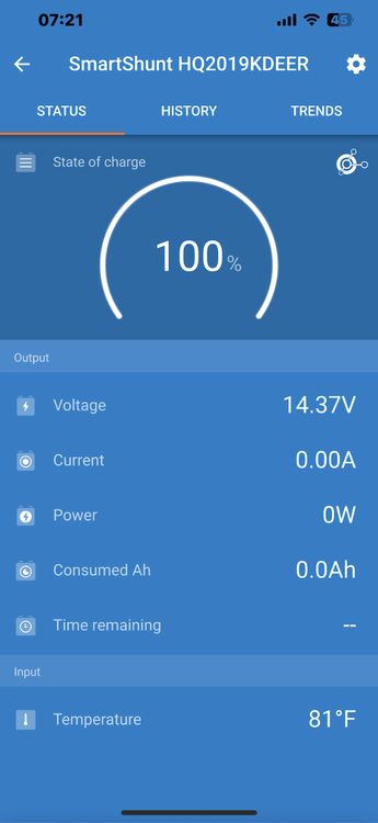

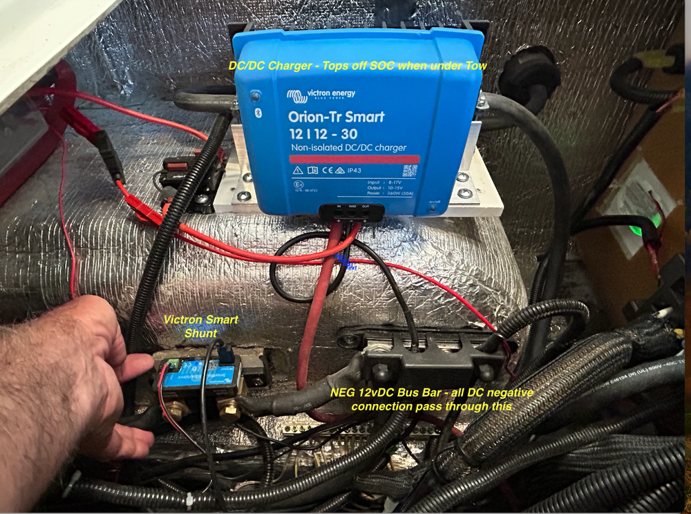

At a high level, here's a description of the Smart Shunt:  The SS continuously monitors multiple elements of the electro-motive force going through your DC circuitry - these elements include, current voltage, current, SOC%, useful battery time remaining, battery temperature, etc.  Our's is mounted under the aft dinette seat where I'm pointing with my left index finger:
The key here is to wire all your DC devices' negative connections through a "NEG Buss Bar."  If you miss one and connect a DC device directly to the battery bypassing the SmartShunt, it will not be detected.  So, the right lug of the SS jumps over to the negative buss bar and the left lug jumps directly to the battery bank.
It's called, "Smart", because it's Blue Tooth-enabled allowing it to communicate to its corresponding mobile app.  Here's what the Victron app's Home Screen looks like on my phone:
At the top it shows the Victron "Cerbo unit" data block - this is sort of the central nervous system of both your AC and DC circuitry.  The Cerbo unit tells the user graphically where AC and DC power is going at any point in time - either via the app or by the touch screen.  This device is not required unless you desire it for extended boondocking or for your particular style of camping.  Going down, the app next displays the SS status, turns out the SS's BlueTooth signal isn't very strong - but we can monitor this screen from the TV while under tow and track SOC status.  After the SS data block is the Smart Solar MPPT Charge Controller data coming into the system.  If we were connect to the TV when I took this screen shot (and the engine running) the app would also show the DC/DC Charger data - since we're not connected w/engine running the charger is OFF and therefore, no data block is displayed for it on the app.
The next screen shot is specific to the SS:
This gives the user a different graphic of the Home Screen that's specific to the SS.
If your "Phase 1" includes Lithiums, suggest you consider including a SS at the same time.  You'll be making rather large custom battery cables anyway, so with those tools (cable cutters, lugs, lug crimper, heat shrink, and heat gun) out and ready, it will be a straight forward process to make your SS/Bus Bar cables as part of this first phase.
A note on the NEG Bus Bar:  On our hull, the factory negative bus was a "pole type" bus that's grounded to the frame right under aft dinette seat.  It wasn't robust enough to handle the additional negative connections, so that explains why we decided to upgrade to a Blue Sea Systems multiple lug bus bar.  We used the same grounding point on the frame as was used for the factory pole bus.

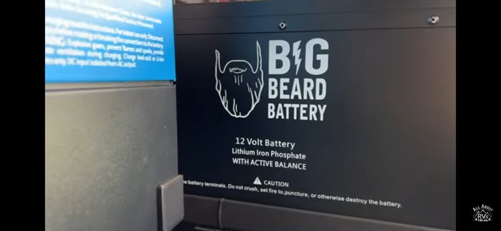

Is the Bigbeard lithium phosphate (lifepo4)? Not finding the chemistry specs. Also concerning is a tag on "for indoor use only". Not impressed with their website.
Maybe I missed something.
Edited by SeaDawg
Found this. So, yes, lfp/lifepo4
Edited by SeaDawg
1 hour ago, MAX Burner said:
I'm like'n it!
Have you seen the dude? Personally, Chris and I are not beard people, don't get the big beard thing, let alone a naming your battery company as such. Beards, tattoos, piercings, young people needing a good bath and shampoo... I'll stop there.
I would say that if there is a new viable battery company, producing great product in Athens TX (not just a website, would want to know of the manufacturing facility), I would support them. I prefer the small co vs online reputation.

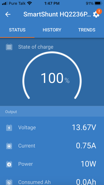

Well darn.  I'm not sure if this is normal.  I don't think it is. There seems to be a -2.3Amp draw on the system, even with every breaker off, EVERY 12v fused pulled out, and every resettable breaker popped open under the driver's side buck.
Could this be the new converter/charger doing this?
I need to wait for a cooler day to switch back to check.  It's nasty hour in Georgia this morning.
The only other thing changed was the battery configuration after tray clean-up. See battery diagrams, current -vs- orginal.  That's the easiest to put back.
There is NOTHING plugged into the trailer.  No shore power, etc.

Chris, a few things seem strange here. Why did you bother cleaning up/changing battery cables when your plan is to replace these soon with LiFePO4 batteries? But either wiring configuration (many are possible) will not create a -2.3A draw. You either have the +/- cables right or wrong. From your schematics it appears you just changed where the main red + cable connects. This is not your issue.
How is your Blue Sky panel live with the solar off? I could check mine again later today, but I'm pretty sure when I throw the OFF switch left of the solar controller there are no lights on the charger itself (your picture shows no lights there) and the status panel should be dead too, no live LCD screen and charge status light.
I would think the new PD converter/charger should be designed as the old one, in that when there is no shore power it is OFF, completely off. If not, this is a bad design. You can test this by simply removing the battery cables top right of the PD unit. I assume the yellow is the Bat- and the Red is Bat+, so to be safe remove the yellow first. Either way be careful not to arc current here with your tool.
Lastly the Blue Sky system has its own shunt (top right in your picture showing the solar controller). This is what gives you the -2.3A reading. We have the same setup, hulls 110 vs. 113. I believe this shunt monitors the solar system, but not every +/- to the batteries due to its location. I have added a full system shunt at the battery ground (which you should do with your LI upgrade). I have not studied this fully, but I could see if my Victron SmartShunt is getting the same amp reading as the Blue Sky panel shows. I stopped looking at the Blue Sky panel since it is at knee height and now I use the Victron App.

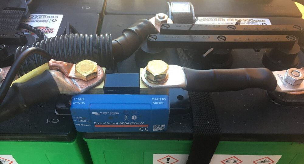

Buy one of these for your LiFePO4 upgrade: Amazon.com: Victron Energy SmartShunt IP65 500 amp Battery Monitor (Bluetooth) : Automotive
Another thing to try, is if you have a multimeter with the clamp end, put the clamp around your battery cables, the main cables leaving your battery back, red or black is fine, one will show negative the other positive but the same number. This is your total system draw (not just Blue Sky). This is what the SmartShunt measures since all grounds are after the shunt. When I have everything OFF and it's dark outside, the reading is generally -0.26A which runs the CO monitor and the Xantrex on standby and that's it.
I can see if my Blue Sky panel and SmartShunt are showing the same numbers, but by the time I can get out there today it will be after dinnertime for you!

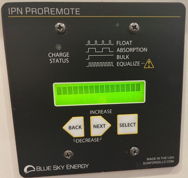

I tried holding down most combinations of these buttons and nothing worked. However, I believe you have enough to go on from my last post for troubleshooting.

Your blue sky will likely show nothing til it senses it's hit 100 per cent. It works on algorithms,  and reset is 100 per cent.
Call or email Ryan at Blue Sky if you continue to have problems.  He's truly a wizard. Totally knowledgeable.  Great guy.
@jd1923 to correct that display issue Ryan had me simply take the display panel out and unplug the phone jack looking cable. That resets the display. It happens to mine about once a year. More to come. Thanks.
