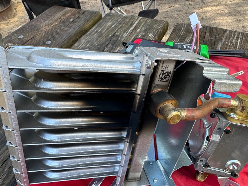

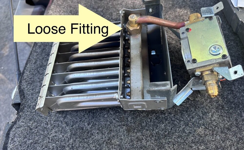

Luckily, I travel with a lot of tools, so I investigated looking for the loose burner tubes. Nope, all tight and in place.
What I did find was a little scary. (See the attached photo.)
the nut holding the main gas line to the burner manifold was quite loose. You can see by the soot on the bottom of the burner assembly and nut that a lot of gas was escaping and burning in the wrong place.
I tightened the nut up as much as I dared - not wanting to twist the fitting out of the manifold and put the whole thing back together. It now works fine.
That said, I’m sure this nut will vibrate loose again, so between now and then I’ll have to think of a fix. Pipe dope suitable for LP is a possibility.
Between this and the problem Galway Girl posted - and more than one incident of fires - it seems Truma had (has?) a QC or design problem that could lead to so serious consequences.

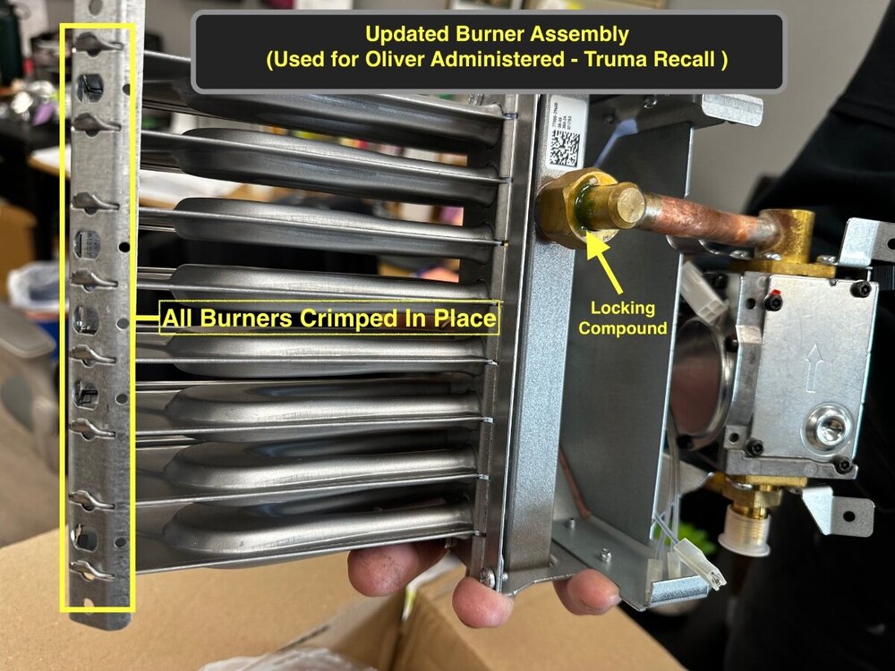

**NOTE by Craig - The effected burner assembly tubes  were not ALL crimped in place during manufacture, only the ones on each end were crimped.  The TRUMA Mfg line has made a mfg line change and now ALL tubes are crimped in place.  New burners for the recall will meet this standard.**

Your Legacy Elite I or Legacy Elite II was manufactured within the affected period using this component. Your unit must be inspected to ensure the Truma water heater is not within the recall population as identified by the Truma model-serial number. The remedy will be the replacement of the water heater burner assembly, free of charge. The replacement water heater burner assembly will be sent with instructions to complete the installation by a qualified RV technician. The replacement should take approximately one-half hour to complete.
Oliver Travel Trailers will cover the cost for the remedy repair. Water heater burner assemblies can be replaced at an authorized service center.

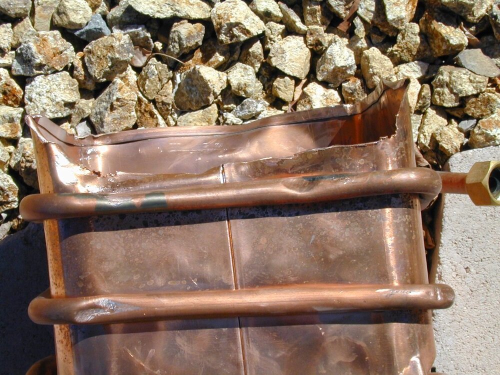

2020 OLEll, Twin, 579:
@Ronbrink
All the  units with the effected s/n are determined to be nonconforming since only the end burners have the tabs crimpted. The new corrected units will have all the burner end tabs crimpted.
Maine

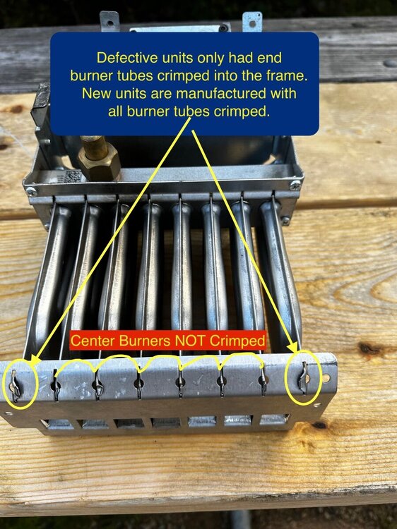

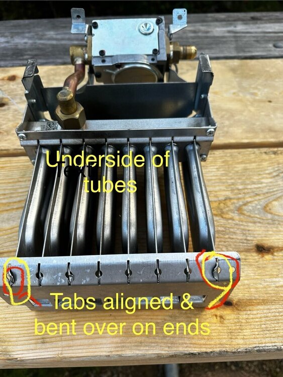

pix may help clarify
Burner unit shown below only has end 2 tabs bent to crimp unit to frame.  This is the old design being recalled.
 Newer units (being replaced in recall service) have all tabs crimped.
Previous owner took the 2019 Oliver Elite II into a 'Truma Service Provider'.  The Truma was not operationally.  The previous owner showed me the last service ticket that the Truma was Fixed, before I purchased the Oliver.
It did not work.  I took it apart... obviously... the Service Provider was tired of hearing from the Precious Owner, after THREE Service calls. The Fourthm maybe third was the copy given to me.
When I called the Truma Service that did the 'service under warranty', they became tired of me, as well.  I have wondered if Truma Inc. was charged for these Service Calls.
 I was notified in the U S Mail recently, that Truma would replace the... PART... that was faulty.  A RECALL.  Of what kind?
I sent photographs of MY Truma to Oliver...My  Repairs... when I discovered the Truma leaked water into the Oliver... see photograph.  I was disappointed that Oliver  Inc. would not do anything to make it right. The original owner obviously had no fix and did not intentionally damage the copper tank heater.
 Obviously the local Service Provider... DID FIX IT... permanently.
When I received the Recall Notice... I was not approved by Oliver Inc.... as I tried to FIX IT, myself.  Once removing parts... no wonder it was not going to work.
I will find a much simpler system to install, like a 6 gallon simple Dometic Hot Water system, like the one that has operated perfectly in my 2019 Airstream, since new.
Am I happy?  Guess.  My Truma was within the numbers of the so called recall.  My Truma never worked for me, nor the original owner.  I have owned the Oliver Elite II since February 2022.  My Problem... says Truma and Oliver.  Otherwise our perfect Off the Grid Boondocking travel trailer.
I have had three Airstreams, new since 2006.  Kept the 2019 27 foot Airstream and the 2019 Oliver Elite II.  I like a Travel Trailer that is simple to operate, works, and some appliances that can be worked on if in remote locations.
The 6 gallon Dometics worked perfectly since 2006. When I began to FIX the Truma myself... This is WHAT I FOUND.  Photographs are October 2022.  Purchased Oliver February 2022 from original owner.
The Truma was an UPGRADE for an Oliver.  ...for what?  For... Selling spare parts... I guess.  I also noted Truma is pushing their hot water tanks. Customer satisfaction is interesting.  I know, I was an owner operated business for decades. Happy customers and friends return... I had to retire.  I understand that a customer and referrals, keeps one busy.  (I edited this after reading.)DSCN0900.thumb.jpg.a5229bf97de3cde811e2e5852888dddb.jpg
