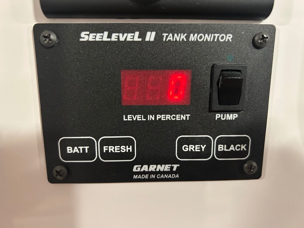

Every picture tells a story….sitting dead level with an empty tank.

Mine usually reads zero at empty after draining the tank with the low point drain under the curbside  bed. The pump starts sucking air at about 13%. I’m not sure I could reach zero with the pump, never tried. My black reads zero easily, but I need to lift my nose at the dump station to get my gray to read zero at level.
