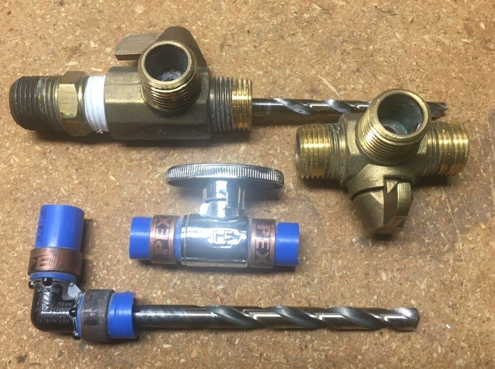

It's important to me. I've done a lot to improve water pressure and GPM flow rates.
I replaced all OEM valves with motorized ball valves with true 12mm ID. The OTT installed valves were 1/4" ID (see picture, drill bits shown are 1/4" and 3/8"). Every 90 (too many of these installed) and ALL PEX crimped connectors have 3/8" ID.
Newer hulls do not have the 1/4" ID brass valves but instead more of the other valves shown center of picture with 3/8" ID. The Oliver plumbing system is then a 3/8" system. If they had used SharkBite everywhere it would be a true 1/2" system.
Although I’m not sure how much difference it makes, maximum flow is important to me as well.
This pic shows the motorized ball valves I installed. More important to flow is the upgrade to the water pump! This Made-in-USA pump is 5 PSI higher and 0.4 GPM greater flow rate which is a positive yet conservative upgrade. I believe the variable speed motor also provides for greater flow rates when in use.
This pump should last forever (can run dry for hours) but it's not near as quiet in my application as they claim. It could be my steel bracket holding the valves acts as a sound conduit. I should add softer rubber footings when I get under there this week. I could also insulate this bracket and the basement cover that sits above this area.
I certainly hope to fix the leak before getting into additional mods. I truly hope the leak is obvious and easy to reach! 🤣
